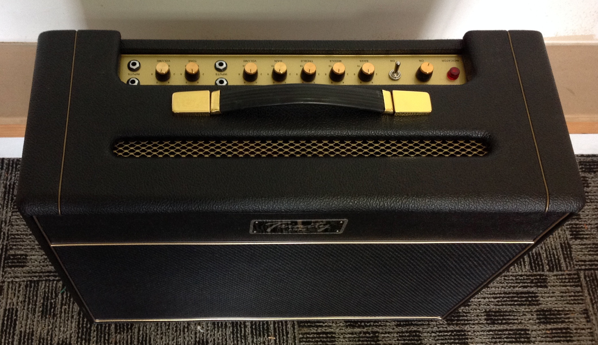

Combo build pictures hmmm, let me look. We did build a combo recently so there may be pictures of it. Most seem to build heads, which explains the docs!
PostPosted: Wed Oct 08, 2014 5:43 pm
Not the best pictures at all but they might help. This customer is located in Berwick, NS.
