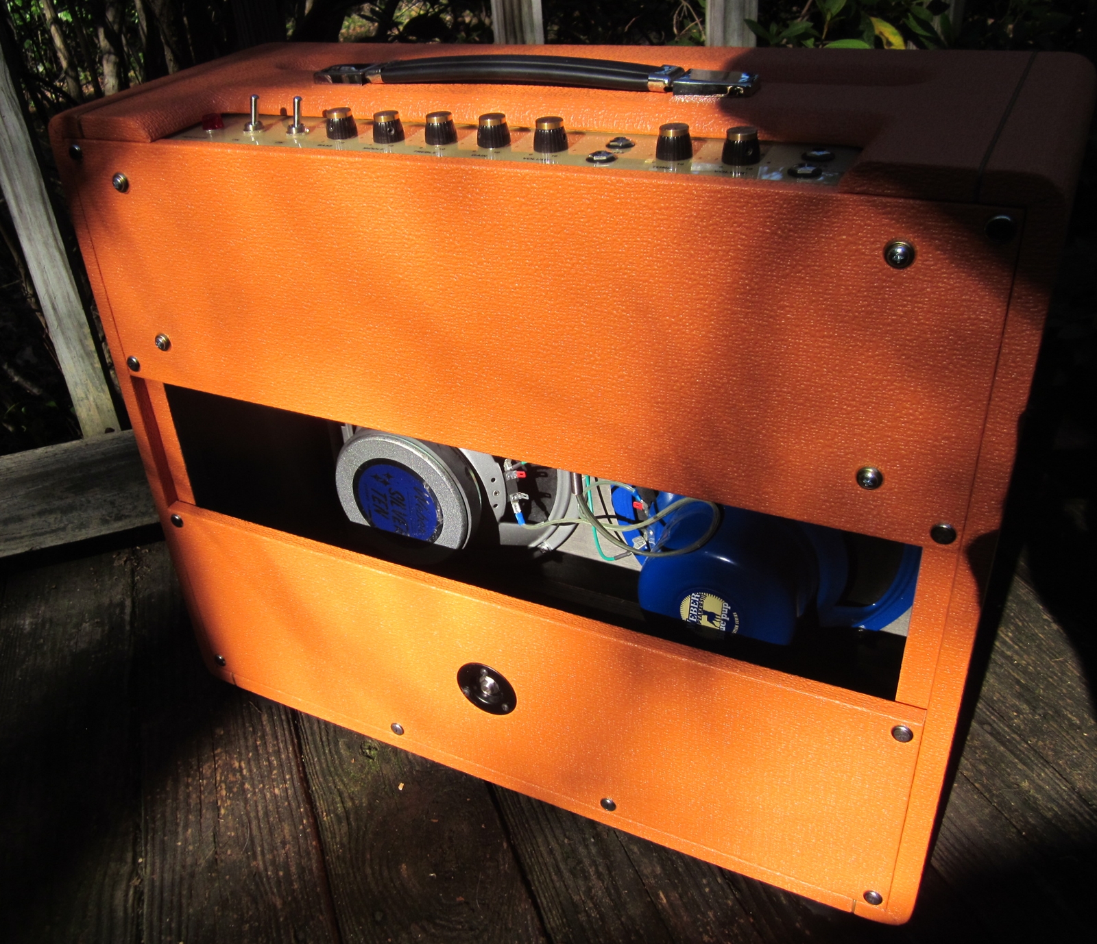

Here's the amp in its case; it is a 2 x 10 rig.
The color and grill cloth scheme are accidentally
(I only realized this after the fact) the same as
the Marshall Mercury series from c. 1972.
I just went for something that said "c. 1972!"
File comment: Cabinet by Sourmash in Florida.
I added the logo from the boot
of a Triumph TR-4.
File comment: Blue Pup and Silver 10

Simply GORGEOUS in it's cab! 8) Did you build the cab? Fine work!
Gene
PostPosted: Sat Dec 14, 2013 7:00 pm
Great looking cabinet, kind of reminds me of a Morris esque cabinet.
I've always wanted a cab with that grill cloth, it's got a cool look to it.
