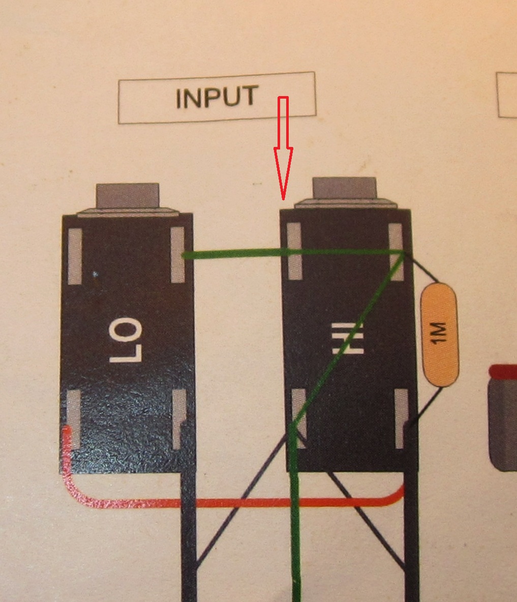

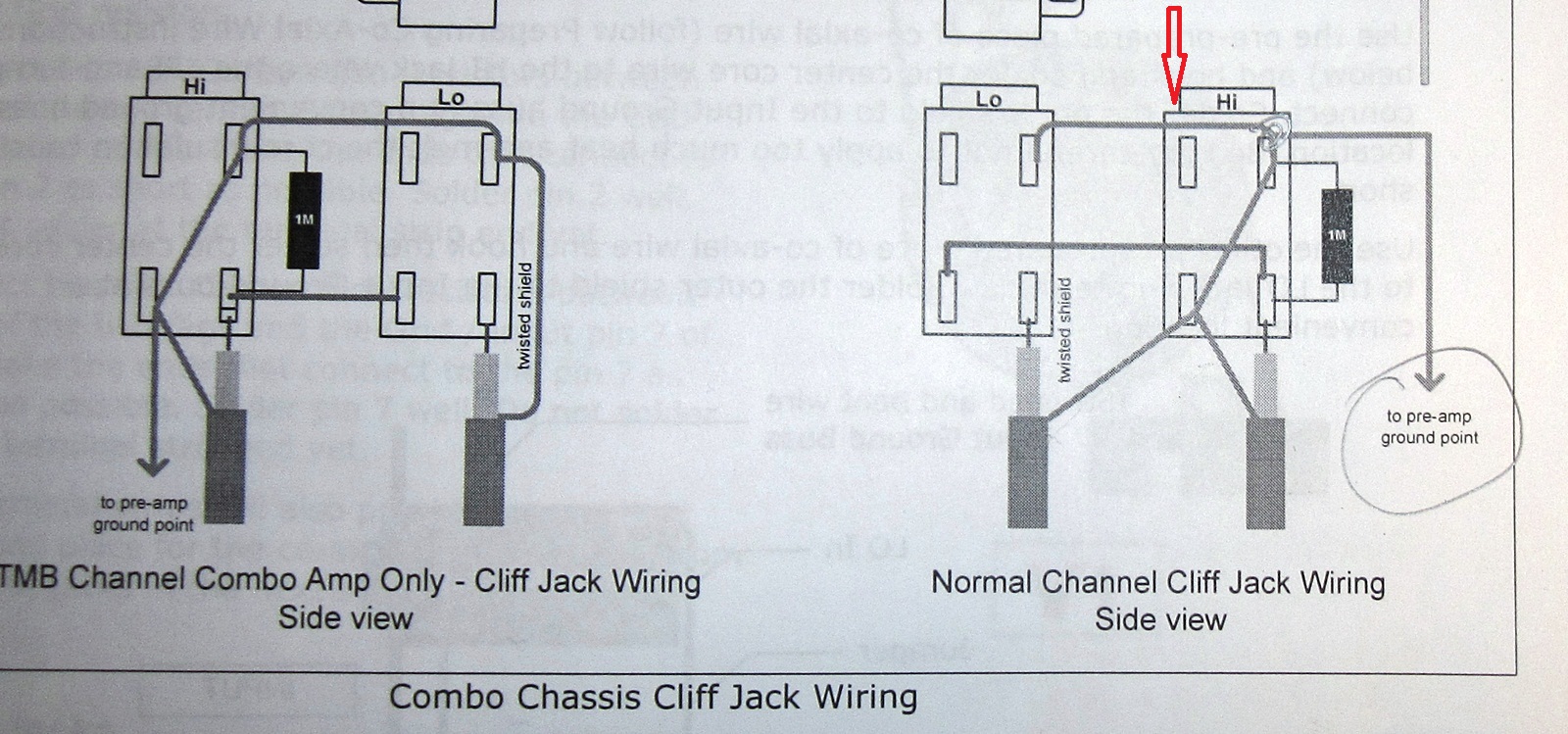

I include photos of the Cliff jacks, and of the output jack
wiring. I get continuity signals from the 1,2,3 pins to the center
tap of the impedance pot (I read that post by a guy who said his
pot was set to 4,5,6 but he wired it as 1,2,3--that's not my problem).
There was a slight ground for confusion with the Cliff jacks in a difference between
the color architectural drawing and the B&W manual.
1) I wired both sets of Cliff jacks as "normal," as the color architectural
drawing showed both sets for the sIII wired the same way. (i.e.,
I ignored the TMB scheme (as I am building an sIII) in the manual--should I have?)
2) I did note that the "higher detail" B&W manual image of the Cliff jack wiring showed
a different ground wire scheme than the color drawing.
The color, architectural drawing shows a ground wire apparently
connecting to the top left lug of the high Cliff jack.
The black and white manual image shows the ground wire
skipping the top left lug of the high Cliff jack. (see arrows in images)
I followed the B&W manual for the ground wire path in the Cliff jacks.
Bottom line questions:
1) if all the cliff jacks are "pointing in" the same direction (i.e., their wired sides are facing the right-hand side of the amp),
they can be wired the same in an sIII build? (surely yes, right?)
2) should the Cliff ground wire follow the path shown in the B&W manual drawing?
3) do you see anything obviously wrong in the photos?
cheers,
Johann

PostPosted: Sat Nov 02, 2013 10:12 pm
The input jacks look OK. I do run the ground wire through all the terminals but you have done it correctly. The OT looks like it's wired in correctly too.
Take a probe, like an unplugged meter lead, and touch the grids of the tubes and see of you get a pop or noise out the speaker. Turn the vol and gain up.
You are going to have to trace the circuit through . I would start with getting the Normal channel to work. See if you can check the phase inverter wiring .
Also, check t hat you have all the jumpers on the board - the jumpers between turrets I am referring to.

I temporarily took the coax out of the circuit and wired a standard 1/4" jack into one of the normal inputs.
I'm still not hearing anything out of the speaker. I couldn't even get modest buzzing out of the speaker this time.
If I probe the 68k resistor points, I get no sound in this test.
Shouldn't I get something by probing those points?
PostPosted: Tue Nov 19, 2013 1:53 am
Ok might be a problem at the input side. But try working backwords ( put 1ll controls at high noon) if i rember corectly taking a voltage mesaurment at 2 and 7 of v3 should produce a pop as well as pin 2 of V1> lets see if that gets anything. and Could you post a high res picture of the complete amp
