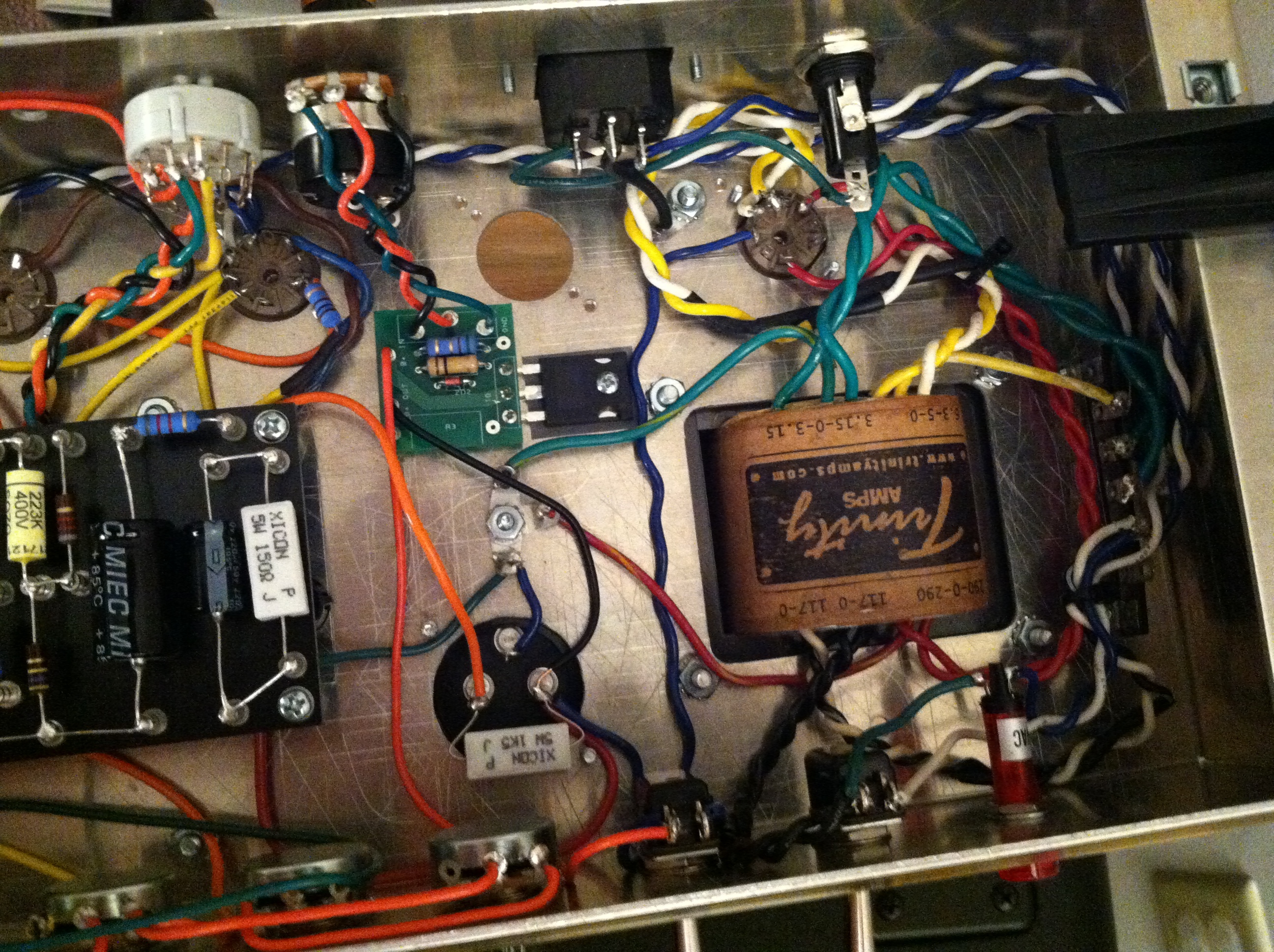

I have been a bit sidetracked lately and I have hit numerous “snags” in my build.
Problem #1
In populating the turret board, I discovered that one of the capacitor values does not match the layout drawing for the new Plexi. The capacitor goes in the open space here:
The capacitor that came with my kit is a 220uF 50v:
I ordered a 50uF 50v capacitor in case the above capacitor is incorrect. Will this work:
Problem #2
I have been working mostly from the layout drawing, and I failed to twist some of the transformer wires:
Does this now mean that I need to order a transformer and start over? I think the wires are now too short to twist.
Problem #3
Where do I connect the wires on the lamp terminals?
Any advice would be much appreciated, and if you seen something else wrong/weird on the pictures, please let me know!
PostPosted: Sun Oct 06, 2013 5:08 pm
Joined: Fri Jun 21, 2013 4:17 am
Posts: 18
1. Regarding the cap, the new versions apparently comes with the 220uF which should be the only difference. It thickens up the tone a bit.
I had the same thing and got the answer from Stephen.
So you should be all set with that.
2. The indicator light should have one leg connected to the 117 V on the transformer and the other one to the 0 on the transformer. Upper right on the transformer if you look at the coloured layout. Unless you are using 240v as I have, in that case have a look at my blog to see how I did it.
http://handwired.wordpress.com/2013/09/18/finishing-the-power-transformer/
I have documented more or less every step so you can browse through my build if you would like to compare your build with someone else.
I finished it up last week and it is built on the new black turret board so hopefully it should look similar to yours. It is a combo, not a head as yours but that should not make any difference as far as I know.
3. I believe you should twist the wires. I would twist them and solder on new wires if necessary, put heat shrink on the joint.
Good luck with the build!
PostPosted: Sun Oct 06, 2013 5:11 pm
Posts: 18
Regarding the indicator light you can see on the layout that the black wire is going to the power switch and then continues to the transformer. The white wire is connector via the terminal strip.
Just to be really clear on this :)

Will do! Here are some pics:

PostPosted: Sun Dec 08, 2013 6:54 pm
Joined: Tue Feb 05, 2013 1:45 pm
Posts: 9
I rechecked the board with my DMM. Everything to the right of the boost switch terminals registers normal, but everything to the left of those terminals is way low. The furthest left terminal registered normal. Anyone see anything in the pics that I am missing, or do I need to cut out the board and start rewiring all of the jumpers? On the plus side, I'm getting lots of experience discharging the amp!
PostPosted: Sun Dec 08, 2013 10:31 pm
Did you install the under board jumper from the 2K2 2W to the + side of the second 16uf filter cap?
