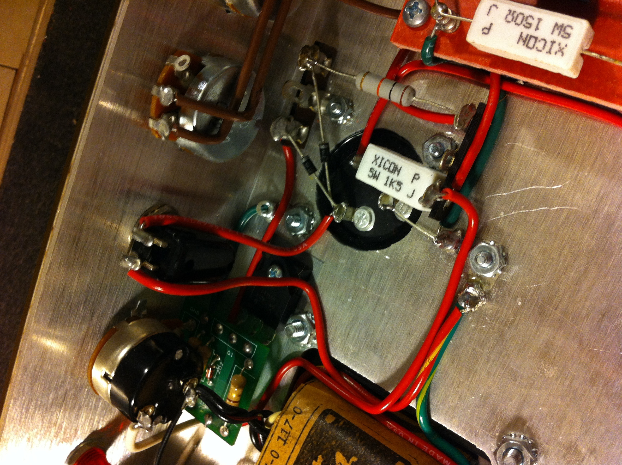

I realize now that the photo I've seen of the VRM implementation (IIRC, from the VRM thread on the Resource page) is clearly not an 18 watt. Looking at it closer, I guess it's a Tweed. That means (I think!) that the components going left to right are Standby - Fuse - Power - Bulb. That sort of messed up my thinking.
In that amp, the Power switch is in a nice, open location a tad further from the clutter of the transformer wires. In the 18 watt, it's right next to the transformer. But it looks like it'll work. It must, obviously, if that's what everyone else does! :D
I'll go ahead and do the power switch location for the VRM swap. I guess now I need to decide where to put the MOSFET. The power switch location makes it a really nice short run to the side wall of the chassis. That's how the Tweed in the resource section looks. But there's also that nice flat expanse of chassis floor near the standby switch close to the chassis grounds.
I wonder if it matters. I wonder if one location is quieter than the other.
PostPosted: Tue Apr 23, 2013 2:39 pm
I found this pic on my phone of an 18W I built with a VRM.
No difference in noise between standby and power location.
PostPosted: Tue Apr 23, 2013 7:22 pm
Wow, you soldered the MOSFET directly to the board. That looks so simple and clean. The only wires floating around would be the two B+ wires and the ground. Nice! I kind of wish I hadn't already soldered and braided up three wires.
When I give it a good looking over and see how easy it is to mount the MOSFET right there, I may have to take those wires out.
PostPosted: Wed Apr 24, 2013 4:43 pm
