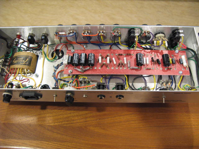

Here are a few photos taken while building the chassis.
I began by installing all the tube sockets, pots, switches and jacks on the chassis. Then I wired up the AC, the power transformer, the heaters, the output transformer secondary, the jacks and the pots.
I started working on the board next. I see the new kit has a fancy black turret board. This one just has a red board with eyelets. I installed all the wiring on the bottom side, then I started working from left to right installing the resistors and capacitors on the top side. I also attached all the flyoff leads using the lengths recommended in the assembly manual.

All that was left now was installing the board and wiring it to the tube sockets and pots.
I did the final checks, installed the tubes and checked it some more. Everything was good. It worked the first time and sounded fantastic when I plugged in a guitar and a speaker!

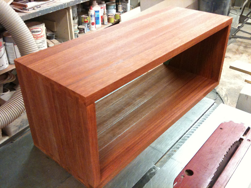

Here are some photos taken while building the cabinet.
I used a hardwood from Africa called padauk. It's bright orange when freshly planed or sanded. It turns redder with age and once a finish is applied.
Here are a couple of pictures of the assembly. I've already planed the wood to final thickness, cut the pieces to size and routed dovetails on the joints.
Rounding all the edges with a router and sanding came next. It's pretty hard to build an amp or speaker cabinet without a router. I have several!
I finished the cabinet by spraying on five coats of clear lacquer.
