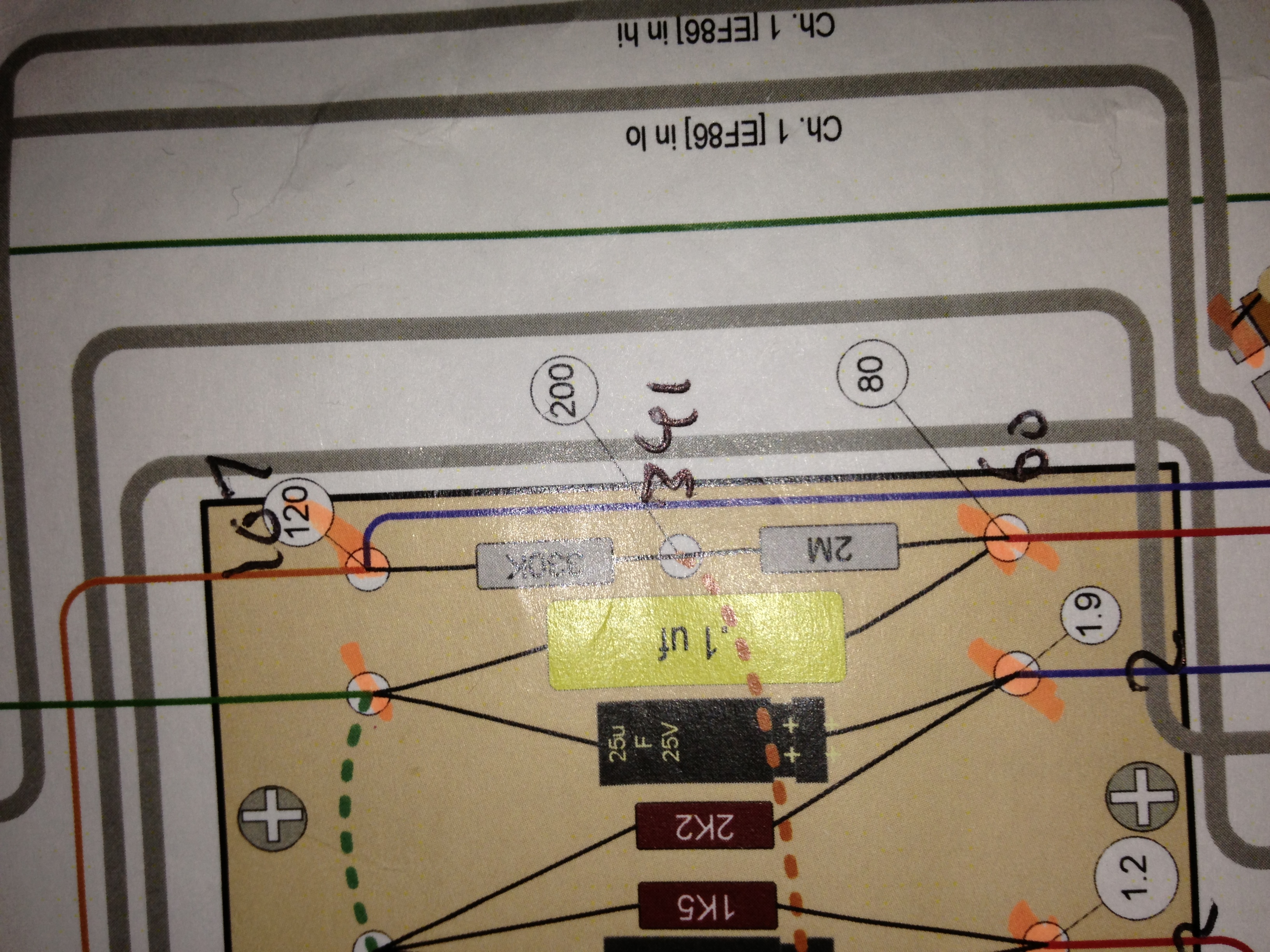

I also measured the voltage points on the board, from left to right. I have bolded the stuff that seams out of the usual tolerances.
8 (7.5) 245 (252) 250 (240) 69 (70) 268 (280) 169 (167) 2 (1.3) 120 (145) 2 (1.2) 2 (1.9)
The right vertical side of the board. 60 (80) 341 (200) 107 (120). The resistors are correct values i have attached a photo of my
layout with these reading written on there and a photo of the board build.

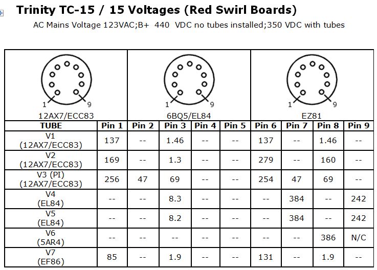

PostPosted: Wed Jan 30, 2013 4:27 pm
Just checking on latest documentation nad checked some remaesurements and yours look fine to me. Here are the voltages.
