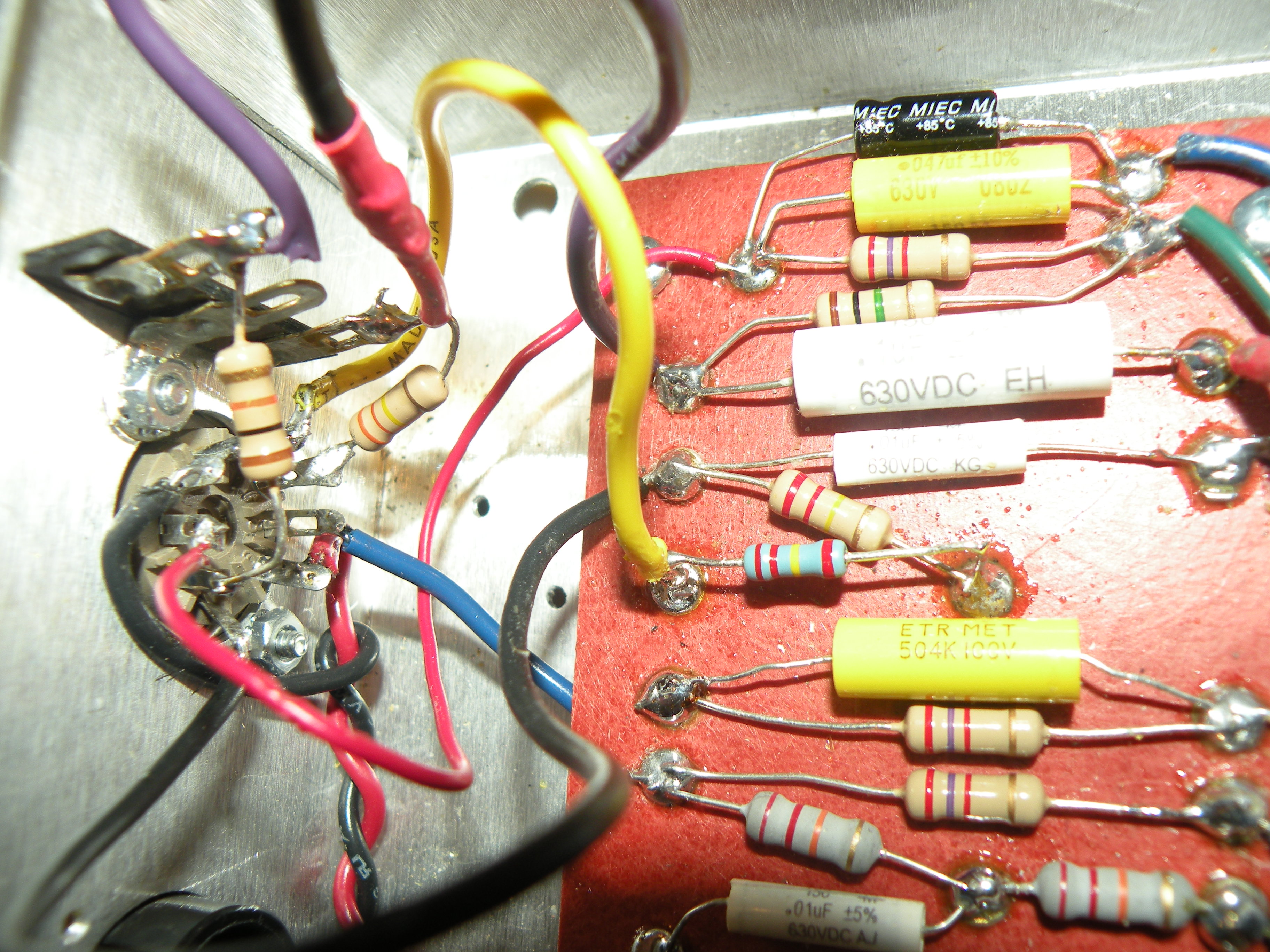

Yes, I know that you can't measure resistors/caps when they are in circuit; I understand that other components are in parallel and will polute the readings. What I did was that I removed the resistor to measure it. Here is a picture showing the board and you can click and enlarge on the preamp side; this is from previous post above. I will post more in a few minutes after I replace that resistor (since I just got back with a new one).
Please understand that I am not in a hurry, and will take my time to work through this carefully and methodically. It must be a process of trial, error, elimination. I am no upset. Thanks for giving me the help to eliminate and to narrow the possibilities that are causing the trouble. :)

:D :happydance: New resistor seems to have helped. I now have good readings before and after that resistor. Here are my new readings:
Before the resistor I now read 320vdc. That is an increase from before.
pin #1 = 166 vdc
pin #6 = 157vdc [other side of the 220k resistor]
pin #3 1.75vdc
pin #8 1.68 vdc
The Hum has gone away; this is really quiet in a good way. :thumbsup: .
Pictures are coming in next post.
:? :?: However, I get NO SOUND from the input jack. No buzz when I touch the copper tip wire with my mutimeter probe. There is no buzz when I touch the input jack side of the .1uf capacitor that is in line from pin #7. However, there IS BUZZ when I touch the preamp pin#7 and both before and after the 330k resistor; there is also buzz when I touch the preamp tube side of that .1uf capacitor, but NONE on input jack side of that .1uf capacitor.
I will wait on your suggestions. But i am very happy that I (with your help) am making progress!
So, now it seems that I must do some signal tracing.

PostPosted: Tue Jan 15, 2013 9:50 pm
When you have nothing plugged into the input jack the input jack tip (hot) shorts to ground to prevent noise. So with no cable plugged in when you touch the input jack side of the 0.1uF cap you will not get sound.
I suggest you plug in a guitar and give it a test strum.

Thanks for the quick reply. NOPE, no sound. I plugged in a guitar and I know the cable is good (I used it last night with a different amp), but no sound. I get buzz before that .1uf cap, but not after it. I will try resoldering that cap and if necessary replace it also.
Also, here are two pictures of the preamp side of the board with the new 220k cc 1/2w resistor.

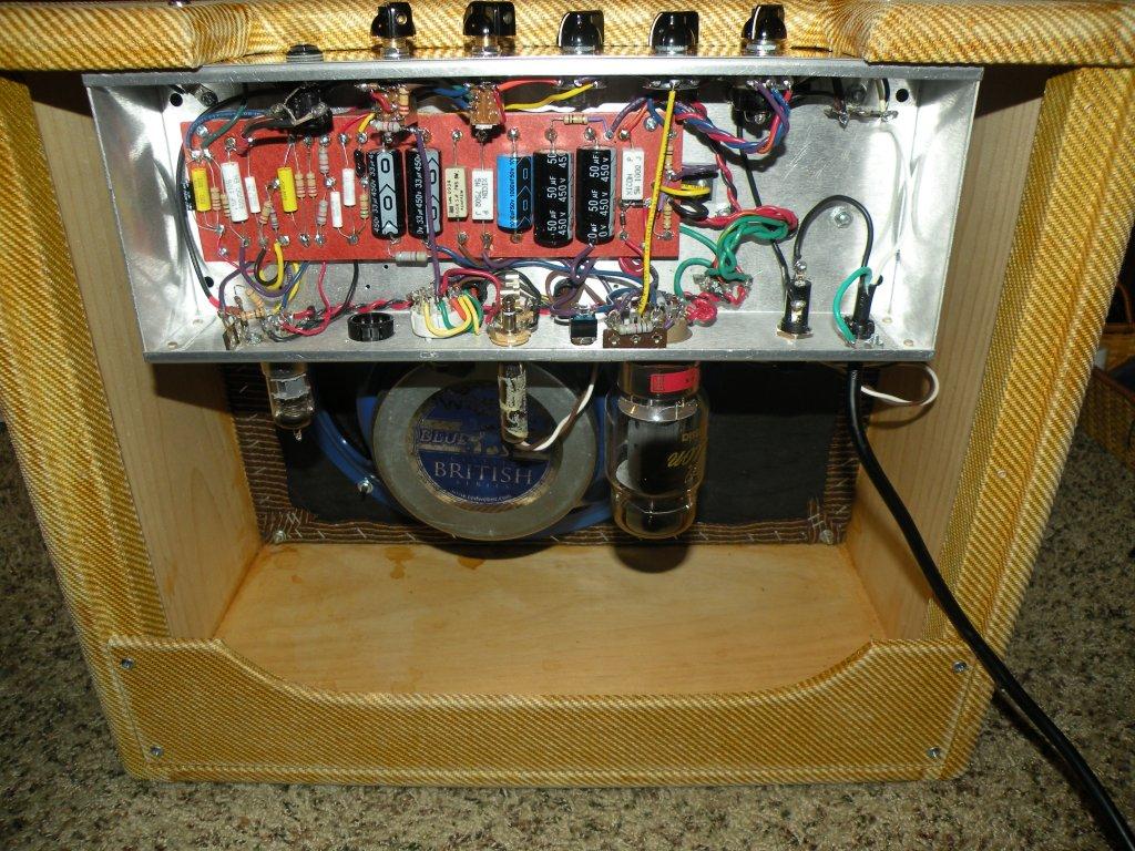

"Vintage" Tramp pictures. The cabinet is a modified 5e3 with the chassis cut out for the Tramp's dimension. I shellaced it with a clear spray first, then four coats of a mixture 1/4 clear, 1/4 amber and 1/2 denatured alcohol. Then I sanded it down to give it a vintage but not tortured look. I think it looks like it is from the "60's" or "70's" and has some wear, but no tears. One of the pictures also shows it with a KT88
The last picture shows a couple of labels for the bias switch and the rotary impedance switch.

Here are three more pictures of my "vintage Tweed" Tramp Combo.
The first is looking down at the control panel.
The second is looking at the back with the KT88. You can see that there is plenty of room for a Celestion Blue, or a Alinco Blue Dog, or a Eminence Red Fang. By moving the speaker opening to the preamp side this allowed for more space in the cabinent.
Finally, one picture of her front.

PostPosted: Wed Jan 16, 2013 7:06 pm
I really do like the look of the "distressed" Tweed, the wear does look quite authentic. :thumbsup:
How's she sounding?

Thanks Snowy :) . I tried not to overdo the distressed look, but did not like the pristine shinny look of all that shellac. So, I sanded it down gradually to take the shine away, and then focused more on the edges and corners where amps usually get more wear. For me it looks used, but not abused, worn but not tattered nor torn.
Last night I played around with it and really like the tonal versatility. I know you prefer to "tweed" more than the "tude", but with my BBQ Ceramic Blue Dog (15W) it sounds pretty good, not muddy, nicely overdriven, still expressive and very nice at moderate volume. As you know, it has a wide tonal pallet. It will take some time to find what all it can do, but I am already impressed. And it is the quietest amp I have ever had. Down the road, I might get a Texas Heat to try down the road, or maybe even a Red Fang. I also want to try your trick of putting a clean boost up front to push the Tweed mode a little.
