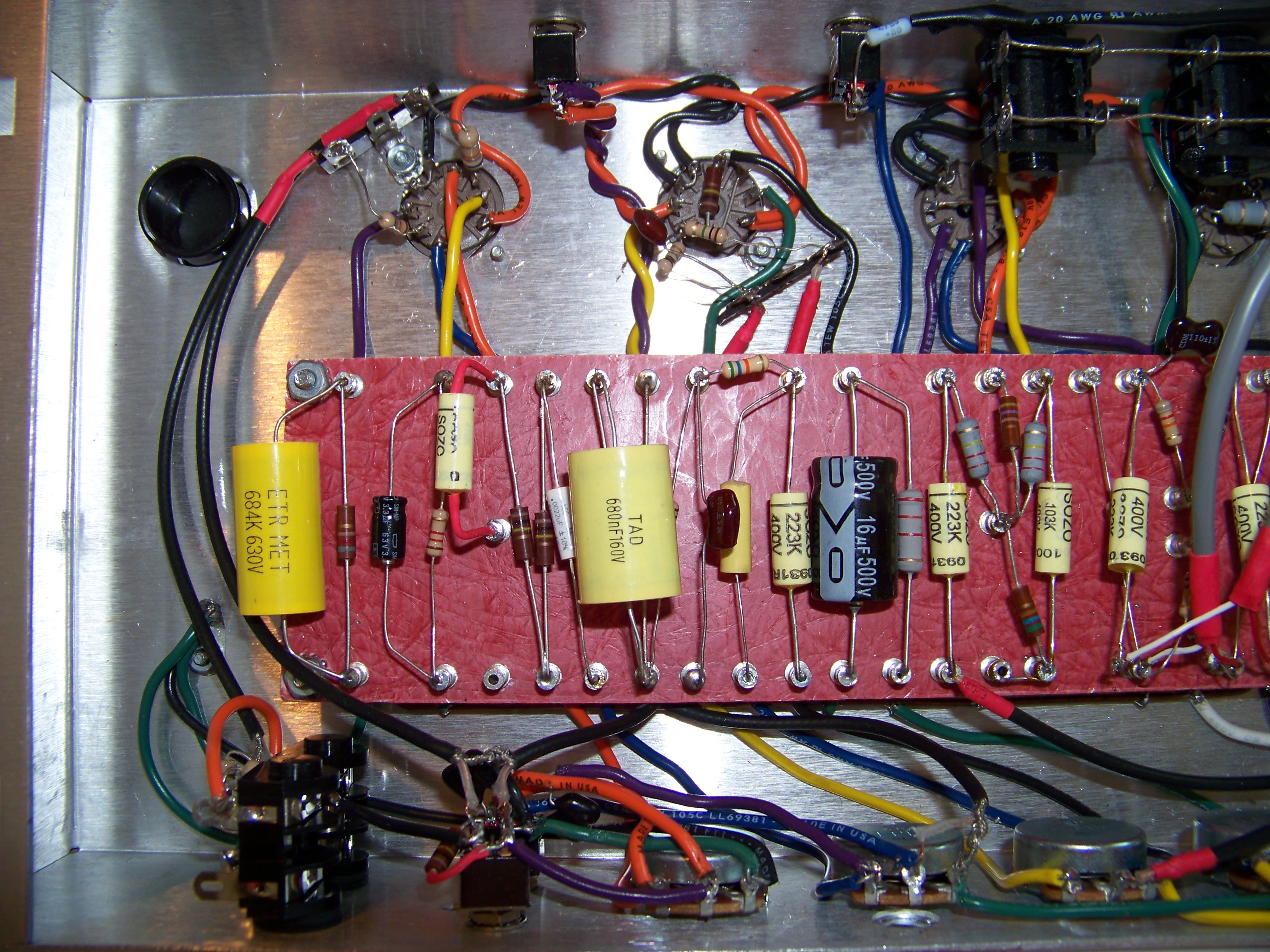

I have now rewired some more. Upped the mix resistors to V2 to 1M to reduce the signal entering V2. Lowered the PI grid reference resistors to 220K to reduce the signal entering the PI. Tried the 'Ruby Mod' (had no affect). Tried the 5pf caps across the plates of V1 A and B (had no affect). Tried removing the V2A cathode bypass cap and the bright channel mix cap to reduce some high end (which I now know did not reduce any high end it just allowed the low end back in). The one thing that has helped very slightly is re-routing the OT secondary wires. That seemed to have a slight affect on the fizz. I have tried other things like using 2.7K resistors on the V1 cathodes, adding 470K grid reference to V2A, changing the cap across the PI plates to 47pf but none of these really had any affect on the fizz. They just lowered the gain a little and/or changed the sound and feel but the fizz is still there.
Here are the latest pics. If anyone has any thoughts or suggestions please let me know.
Les

Two more pics:
Les
