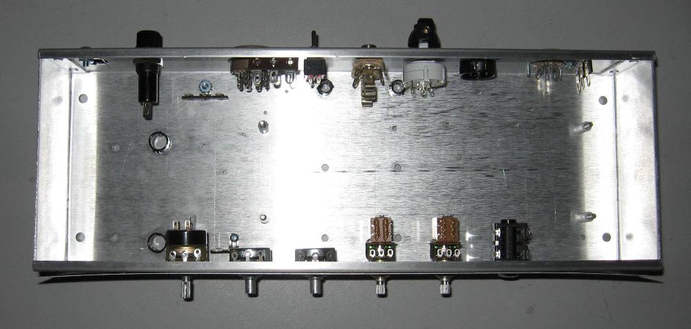

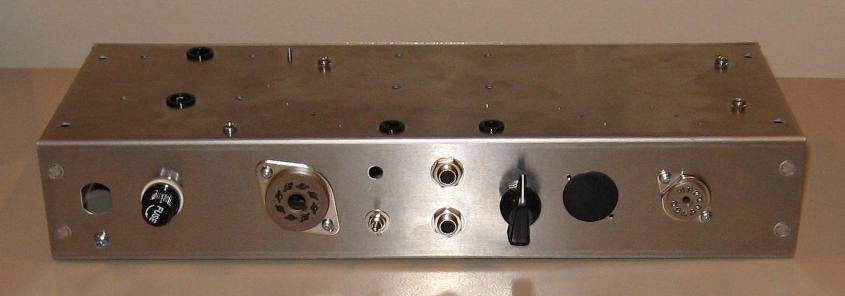

Tramp Chassis - Front (mirrors are hard to photograph!)
Tramp Chassis - Rear
Tramp Chassis - Inside

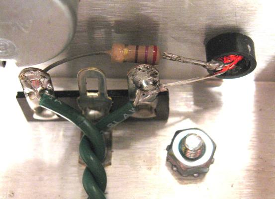

Power Distribution

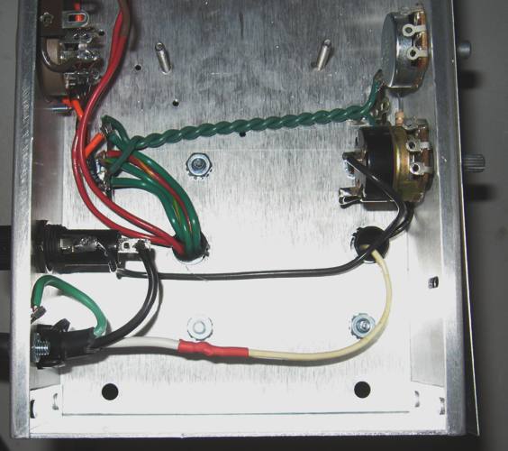

Mains Power connected
Indicator Wiring

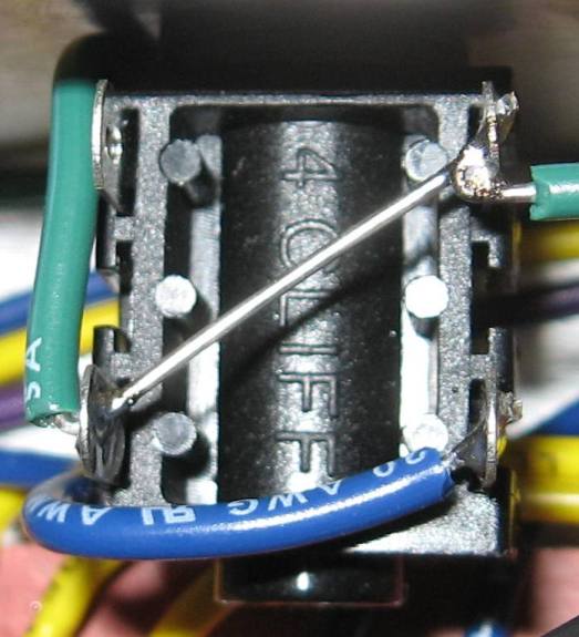

Impedance Switch

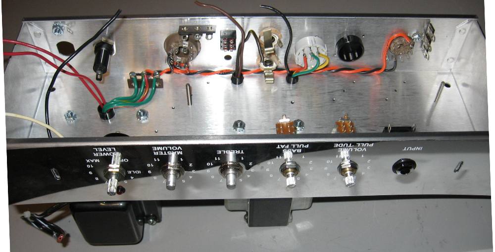

Tramp Wired Up
Very Large Pciture!!

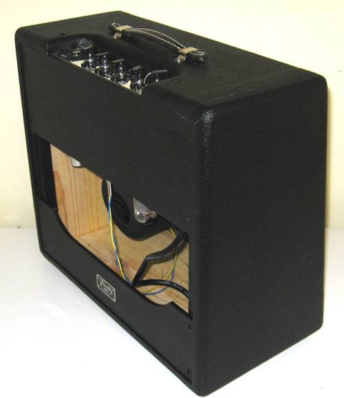

Tramp in a Box!
With the Jensen Blackbird Alnico, the Tramp 110 Combo weighs in at 24.5 pounds.
Just to show that a KT66 will fit the cab! 8)

updated build pics up to impedance switch wiring
PostPosted: Mon May 24, 2010 1:06 pm
updated post with build details. First Build complete, ready to test.

Awesome pics! Can you tell us how much clearance there is (along two axes) between the speaker edge and the power tube?
From the two rear pics (albeit only one is a KT66 ... I think), there seems to be at least an inch or more, but it's tough to really tell.
PostPosted: Tue Jun 08, 2010 11:43 am
I shipped that one so just have to wait a few days for the measurements. Looked to me like about 1" and the depth of that 10" speaker was 5.5"
More measurements are needed to confirm.

There's a bit more than 1" on each side with a 6V6 tube . You couldnt put a 5.5" deep speaker with a magnet diameter bigger than about 5.5". If the depth was 5" you would be OK with any size speaker - or you off-set the speaker cutout more.
