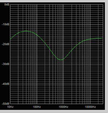

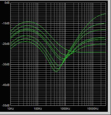

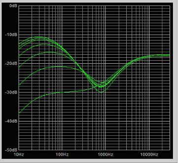

Where is the treble control set? AC30 controls are interactive & it's possible for this to happen. I posted some tone stack curves for the TC-15 and this would be similar.
Try backing off the treble to middle& see if the bass comes back.
Thought this would be of interest to some. These are frequency response simulations of the Trinity15 Tone Stack.
Trinity 15 Tone Stack - all controls set to middle position
Trinity 15 Tone Stack - Sweep Bass; Treble in middle position
Trinity 15 Tone Stack - Sweep Treble; Bass in middle position
