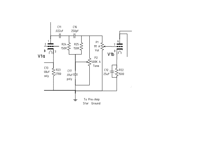

PostPosted: Sat Feb 17, 2007 10:06 am
Here's the schematic for the AC30/4. Thanks Allan.
Allan, what value of choke did you use?

PostPosted: Sun Mar 11, 2007 3:09 pm
:lol: Try this [VW] tone stack if you have the parts. It's very flexible and has a lot of effect on the tone.
