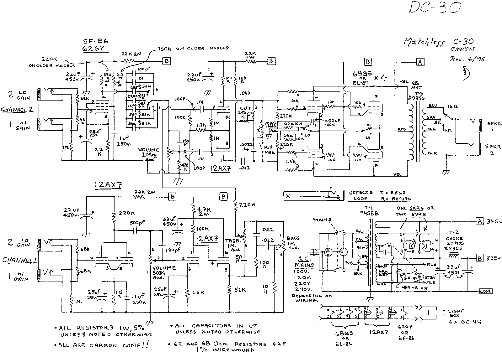

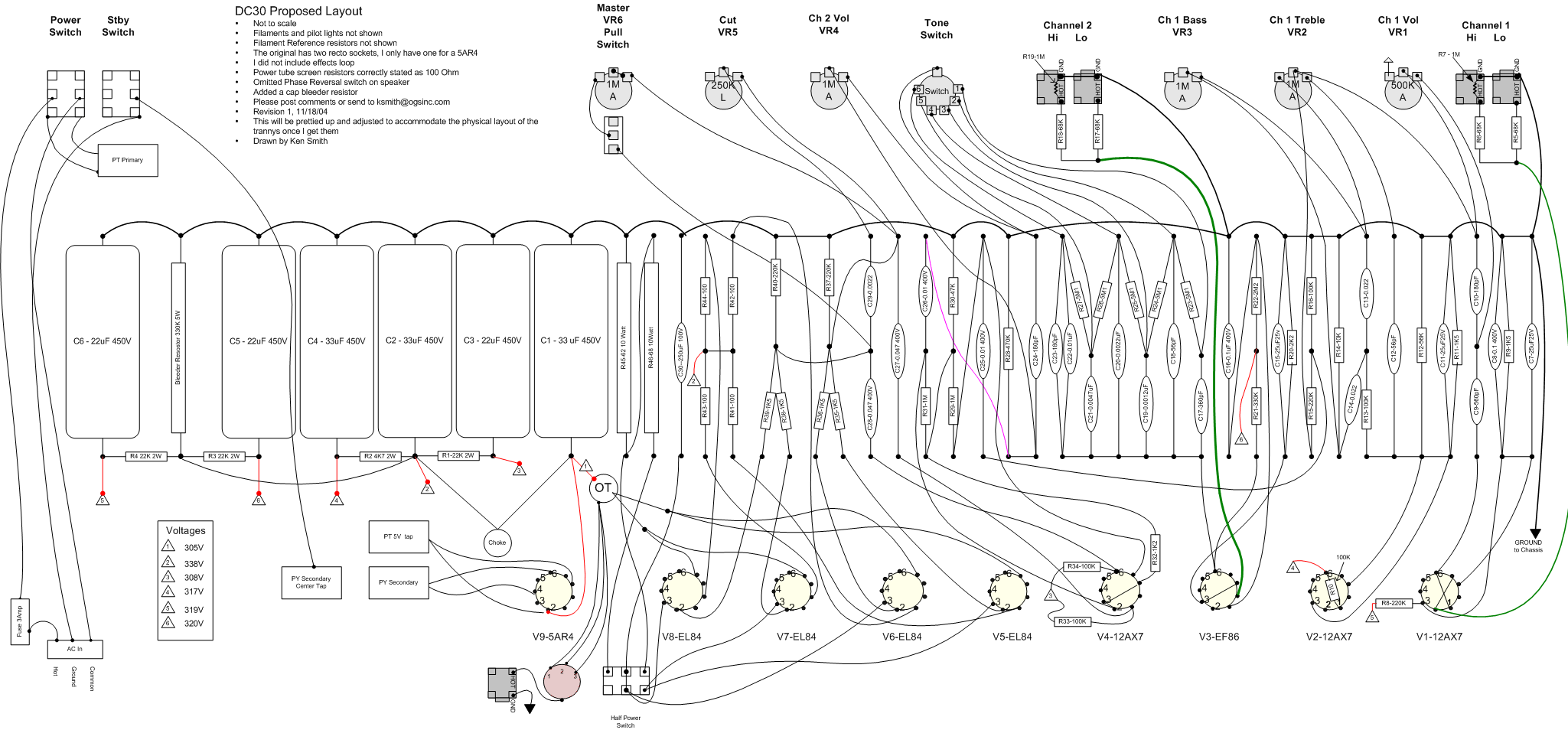

If you are interested in a layout for a 30W, I posted them:
Untested Layout at:
http://www.trinityamps.com/ForumGallery ... layout.gif
This is Ken Smith's prototype layout. I have emailed him to see if there is an update and will post any updates here as well.
Schematic at:
http://www.trinityamps.com/ForumGallery ... ematic.gif

PostPosted: Wed Mar 23, 2005 11:09 pm
Ken replied to me. Looks like a project. Any takers? :idea:
I quit working on that some time ago and decided to just go with the Lightning, built from your layouts, I might add. It works perfectly for me. Since I play mostly low gain, I decided to just build the 12AX7 channel and forgo the EF86, plus the 15 watt power section of the Lightning is MORE than enough noise for me! I need 30 watts like I need a hole in the head.
That layout has some significant errors in it, BTW. It might be a place to start, but it does need lots more work.
Thanks for asking, and I wish you well in your venture. I have seen your forum, and it is great.

PostPosted: Sat Nov 26, 2005 1:57 pm
There is only 1 effective cathode resistor for each configuration. 62 for Hi and 130 (68 + 62) for Lo.
When the 4 tubes are in parallel, the impedance is 4K, when only 2 (Lo power) the impedance is 8K. When they switch this to low power on the 30W OT, which is 4K, you get the "Lightning" output stage with the mismatch and 130 ohm cathode resistor. Back to Hi, you get matched impedances and 62 ohm cathode resitor.
Kind of like getting two amps in one. Matched & Unmatched.
All is Well!

PostPosted: Sun Nov 27, 2005 7:03 pm
Well, I just finished a 30W "Lightning" . Matchless 'designed in' a mismatch for the Lightning. The 30 doesn't. The bonus is, if you build it that way, with the switch, you get a lower power amp that is a Lightning, and a higher power amp that has a DC-30 "Lightning" channel a bit cleaner. So far it works on mine, but I have to do some more testing. I put a 2PST switch in the back to switch in the cathode resistors.
