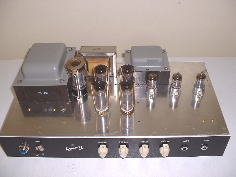

I made a Custom 30W Lightning with switchable Hi & Lo Power, just like the DC-30, but only the single Lighting channel, no EF-86. Here are some first impressions from lbet, the wonder musician.
1. It's nice.
2. Not too much clean headroom
3. There is a lot of distortion coming from the back end. The more you crank the master the more crazy it gets.
4. I leave it at 12 along with the pre gain and plug a strat into the low gain channel. Nice
5. It would be louder and cleaner with a Mesa cab with v30's
6. It is not as clean as compared to the lightning believe it or not.
7. The low power setting was a tad cleaner and spankier than all 4 power tubes lit up.
8. When you switch from low to hi it is definitely louder.
9. It is cleanest with the master at 12 o'clock and the volume at 12 or less. Forget about it with humbuckers.
10. Low input nice distortion but more than the low input with the same amp settings
11. Do you think there is a setting where you can get the lightning sound, but louder? You can get a lightning sound but it is only a little louder. When you crank it it starts to compress a lot.
We both expected more clean headroom than it seems to have right now.

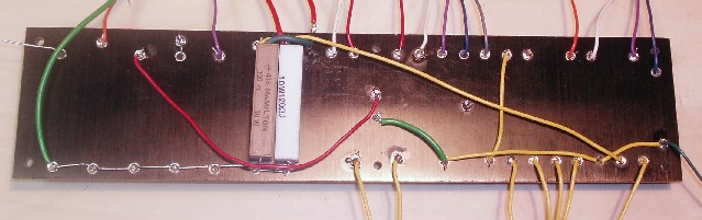

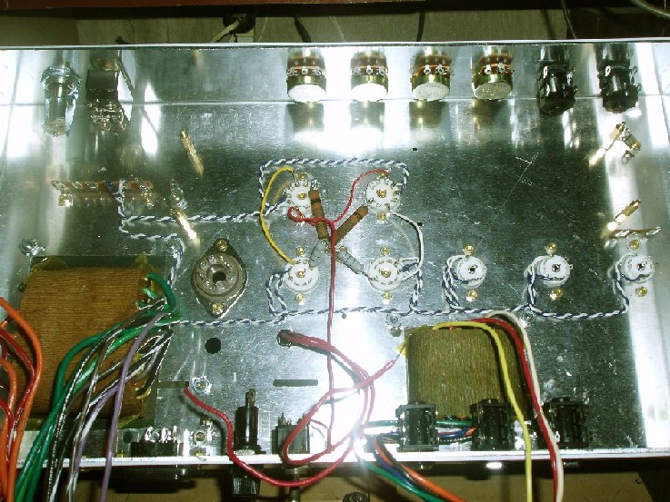

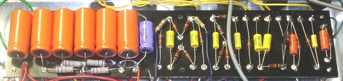

Notice the two extra 1.5K carbon film resistors
Cathode resistors underneath board. Both switched in parallel for 30W operation.

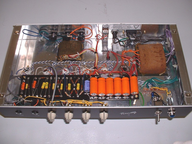

Standard 15 chassis mofdified to suit 30W transformer set. Grid Wires completed.
Wired up and working. Notice Cathode switch on rear panel for 15 / 30 Watt operation!
Standard Lightning on Low power, DC30 with Lightning channel on High power

Did you have to cut your impedance out by half?
Also, how did you disable the two power tubes to go 15? I'm guessing you did it at the other Cathode Resistor? I was thinking of just going with one 60 ohm 10 watt to compensate and take up less space.
PostPosted: Sun Dec 04, 2005 8:34 am
Yes, we did it at the cathode resistor. You need to have 120 ohms for the 15 and 60 ohms for the 30 so you will need two anyway. We put them in parallel and switched them in/out. Matchless puts them in series & switches them in.
The 'mismatch' is part of the 15's sound. 4K is right for the 30 and 8K for the 15. This tranny is 4K so it works according to original design.
I'm going to post a schematic & layout of this amp soon. It's almost done.

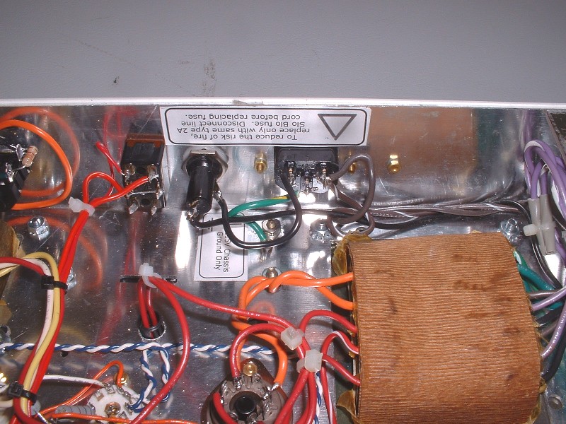

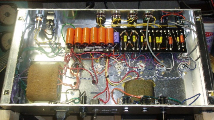

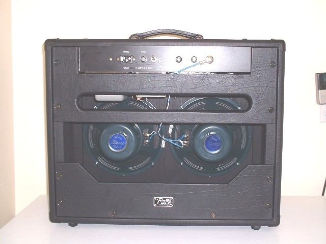

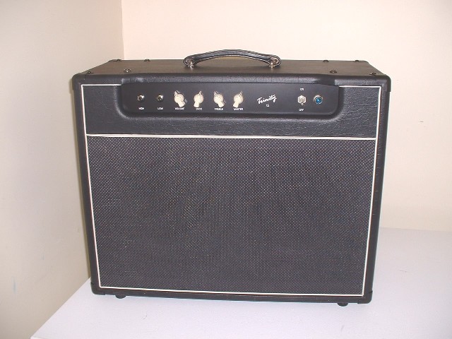

OK guys, here's some pictures of the build I delivered. We haven't recorded anything with it yet, but the owner is doing another CD with his band and he said I'd hear him play it then. I may be able to post them then.
He said the amp was great and was going to be taking it to rehersal and use it with the full band to see how it stood up to the stage levels.
After I built it, it did not seem a big stretch to do a second channel with the EF-86, cut control etc. the layout was clean, if not a bit tight. I'd make a few changes to accommodate the tubes, that's all.

Looks good. Which webers did you load into it. I bet they sound great.
PostPosted: Sun Jan 08, 2006 11:59 am
Webers were the 10A125 Vintage Series AlNiCo 10 inch Speaker. they did sound great! The 2X10 combo is a very nice one.
