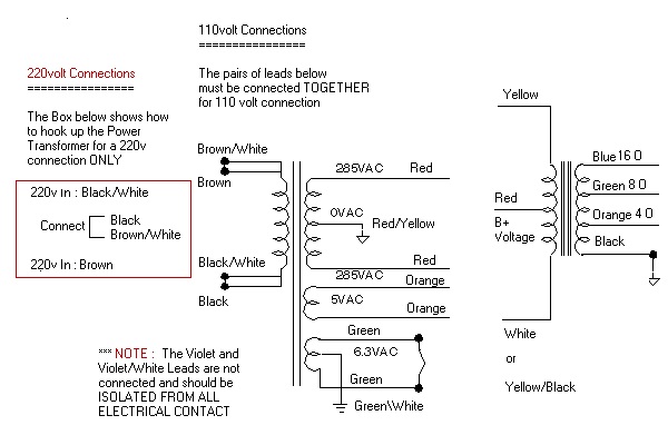

PostPosted: Wed Feb 25, 2015 12:21 pm
Here is the Westlabs docs for the transformers we used to use. 220 V hook up in diagram.

Thanks. You come through yet again!
PostPosted: Thu Feb 26, 2015 10:42 pm
Nothing like being able to search the archives! You're welcome!
