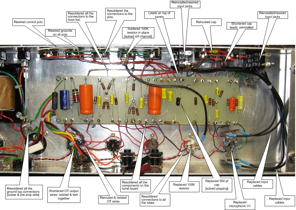

I recently received an amp for service, that was built from a kit. The customer did his best but was never able to get the TMB channel to work -nothing but snap, crackle, pop and a waterfall sound. The porject was started in 2005. He loved the sound of the normal channel and just wanted the amp to be complete. I agreed to look it over and I thought a pictorial of what I did would be useful for others.
One missed solder joint at the 100K on the Volume Pot and a failing 500pf cap on the board were the culprits and the amp is working now. I found the 100K easily enough but the cap was more difficult. I had to deduce it might be a problem and replace it to see if it was.
So far, it seems to be working fine.

That's the same cap that was bad in my kit. That was sometime in 05 also.
Luckily I had a scope and was able to track it down. It would actually work for a couple of seconds, then start popping.

This is actually my amp and my first build. I spent countless hours chopsticking and reflowing joints to no avail. I was pretty discouraged and set the amp aside. A new job with very long hours also got in the way.
Stephen very graciously agreed to have a look at the amp. I don't think I ever would have found that bad cap.
