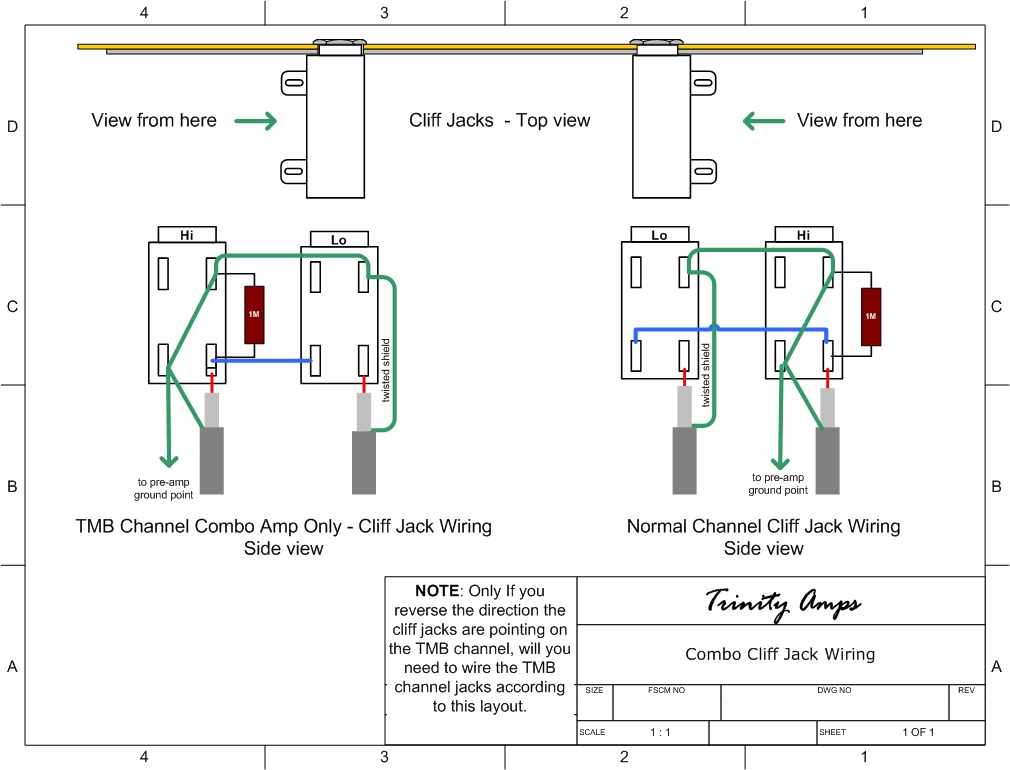

I've got a problem with the inputs on the low input of the normal channel and on both inputs of the TMB channel. No guitar sound through these inputs but the hiss rises and falls with volume change so I think everything is fine except the input itself. This isn't really suprising since I found the inputs to be the most difficult part of the build.

Use this layout to check your input jacks - IF you installed the jacks so that the lugs point in the direction on the diagram.
