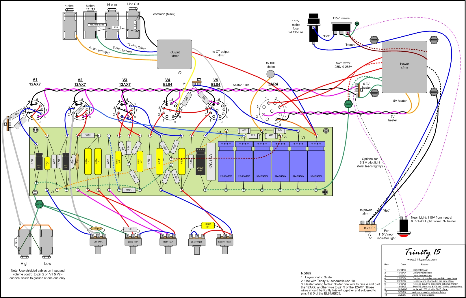

Hey guys, do you have info on providing a line out for direct recording and is it practical? The reason I ask is that when i eventually build an 18 watter, i'd love to mic' it with an sm57 while also recording direct by running it through a speaker cab sim and then into the PC. There are ideas floating around on the 18 watt forum but i was interested with reference to your designs.

There's no reason that the line out on the Lightning wouldn't work.
http://www.trinityamps.com/ForumGallery ... t_rev2.JPG

Agree with LeeMo. Two resistors will do just fine!
