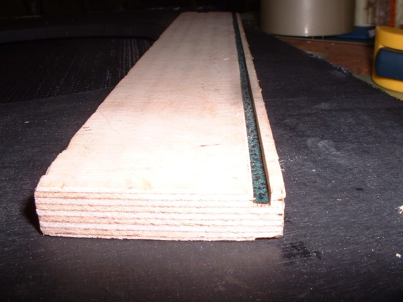

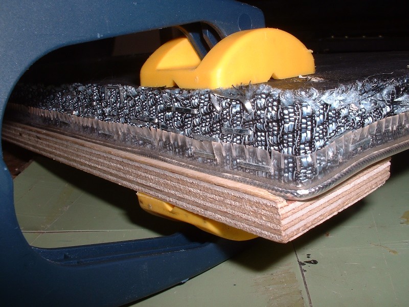

I created a jig to help me because I do so many, and I'm a perfectionist on this.
The jig is a simple piece of wood with a groove cut in it to fit the piping. I use it to align & hold the piping in place, then I clamp it in place and staple the piping with an electric stapler , 1/4" staples.
Works great and makes for a perfect application.

PostPosted: Thu Dec 01, 2005 1:01 am
Piping Jig
Applying the Piping
