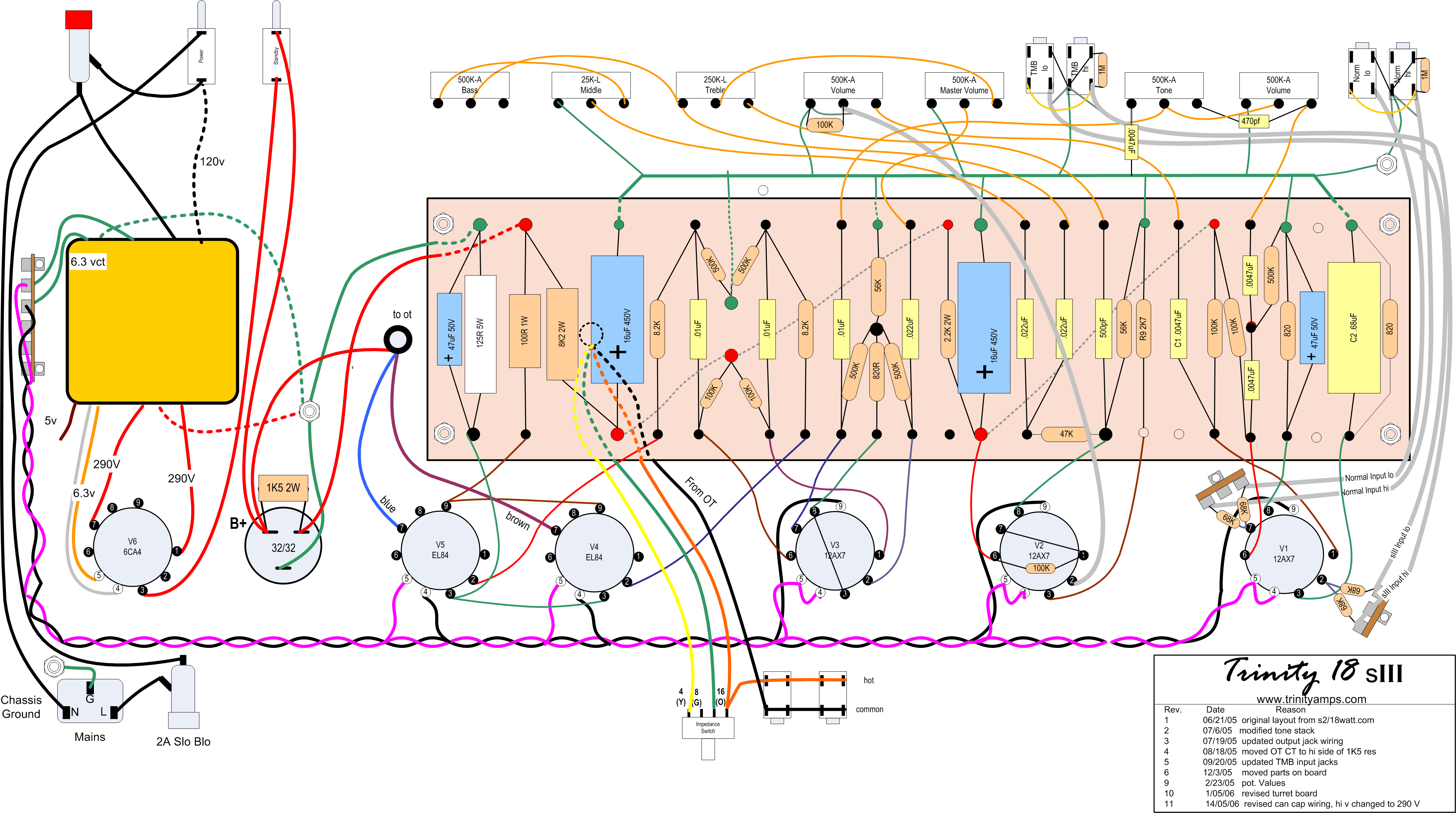

Yes a picture of the general layout is good. What grounding scheme did you use? Was it the same as the layout here?
PostPosted: Wed Aug 23, 2006 6:50 am
PostPosted: Wed Aug 23, 2006 6:51 am
http://www.trinityamps.com/ForumGallery ... _v1.93.gif

Yes
Basicaly it's the same layout, and the same chassis shape, trannies on the same side als valves potmeters, and inputjacks are the same.
The groundings for the inputs are at the input-jacks-end. the potmeters are as needed grounded at the thick copper wire at the board.
I used shielded wire for the inputs and because they are so extremly hot also to the tone stack. (this may cost some high freqs but we ll see about tahat)
I am going to ground the input caps at the phaseshifter to see how the hum ends up.
Next I will disconnect the TMB part and only connect the other part.
I am almost shure it has to do with unpropper grounding.
