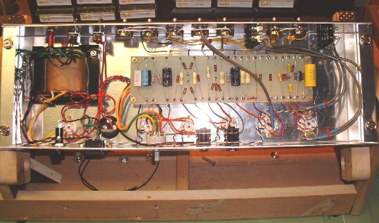

A shiny new sIII for Lawrence! Reused some SOZO caps, otherwise stock.
Here are the voltages:
TUBE....Pin1....Pin2...Pin3...Pin4...Pin5...Pin6...Pin7...Pin8...Pin9
V1......154......--....0.93......--.......--......154......--......094.....--
V2......175......--....1.5.......--.......--......265......--......175.....--
V3(PI)..206......54.....80.......--.......--......209......55.......80.....--
V4.......--......--.....11.....--.......--......--.....347........--.....336
V5.......--......--.....11.....--.....--......--.....347........--.....336
V6.......303(AC).--....362....--.......--.......--......303(AC)...--.....--

I am continuing to hammer my sIII. It is still a chasis sitting on particle board. I this pair of clips have exactly the same settings on the amp and use different guitars. I am going into a 2x12 cab with a pair of tone tubbies. I am surprised how close the neck pickup of the Les Paul sounds for the smokey clip.

Cool. I also added some "secret sauce" at Coco's direction. It is a boost switch that I added to the stock sIII that is on during the clip. It brightens things up a bit as well as adding some fur and compression.

Here's the secret recipe for the sauce:
Take a 1 uF electrolytic cap;
Place across the 2.7K on V2;
Turn on, play, listen.
For icing, try combinations of different caps to get 1 uf in total
- mylar, poly, mica, orange drops etc.
Turn on, play, listen, repeat.
Note: values greater than 1 uf not recommended.
When fully simmered to taste, add toggle switch to chassis.
- or try a foot switch with shielded wire.

I messed around with different types of caps until I got a sound and feel that I could live with. (I am cork sniffing caps now...can you believe it!?)
Anyway each type sounded differnt and the difference was not too subtle sometimes.
Electorlytic - The polarized caps seemed to offer a more compressed and distorted tone. There was buzzyness but in a good way kinda like greenbacks. This trait worked ok in conbination with other caps with different sounds.
Mylar - I put a big ass 1uf mylar cap in there and the sound was cleaner and punchier than the electrolytic.
Polyester - At least I think it was. It came out of a guitar, looks like a chicklet and has a rainbow of colours around it. .47uf I think. Sounds like mylar but not so bold and uncompressed.
Tantalum - Almost identical to Electrolytic in tone.
In the end I went for two .5uf caps in parallel. One mylar and one rainbow chicklet. It gave me an overlay of sounds that my ear liked. (I do need more caps for continued testing though).
BTW, at Coco's suggestion I added a mini toggle switch that lets me manually switch the boost caps in and out. There is a little tiny hole in the chassis that's predrilled for such a swtich. I just had to drill out the plastic back panel.

OK are we now suggesting a 22uf and 2K7 combination over this earlier mod?
Nigel
P.S. Why do quotes not work any more Stephen?
PostPosted: Tue Oct 24, 2006 7:17 am
22uF takes you into a very broad range frequency boost. 1uf accentuated the highs more. It's really a matter of taste. Currently using 22uf but that can change!
