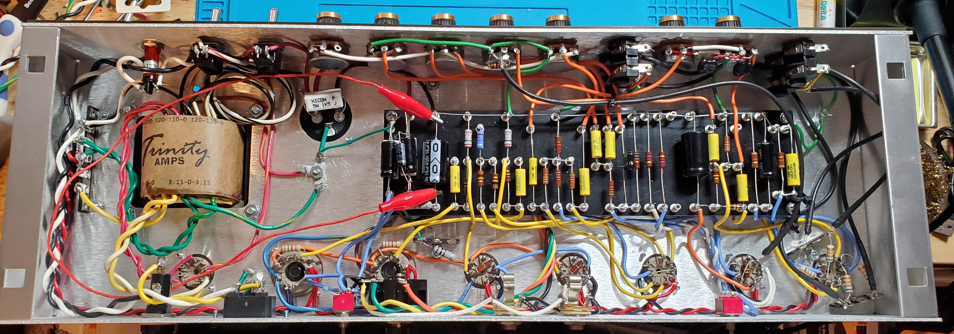

It might help if you post a few pictures of the chassis and the wiring.

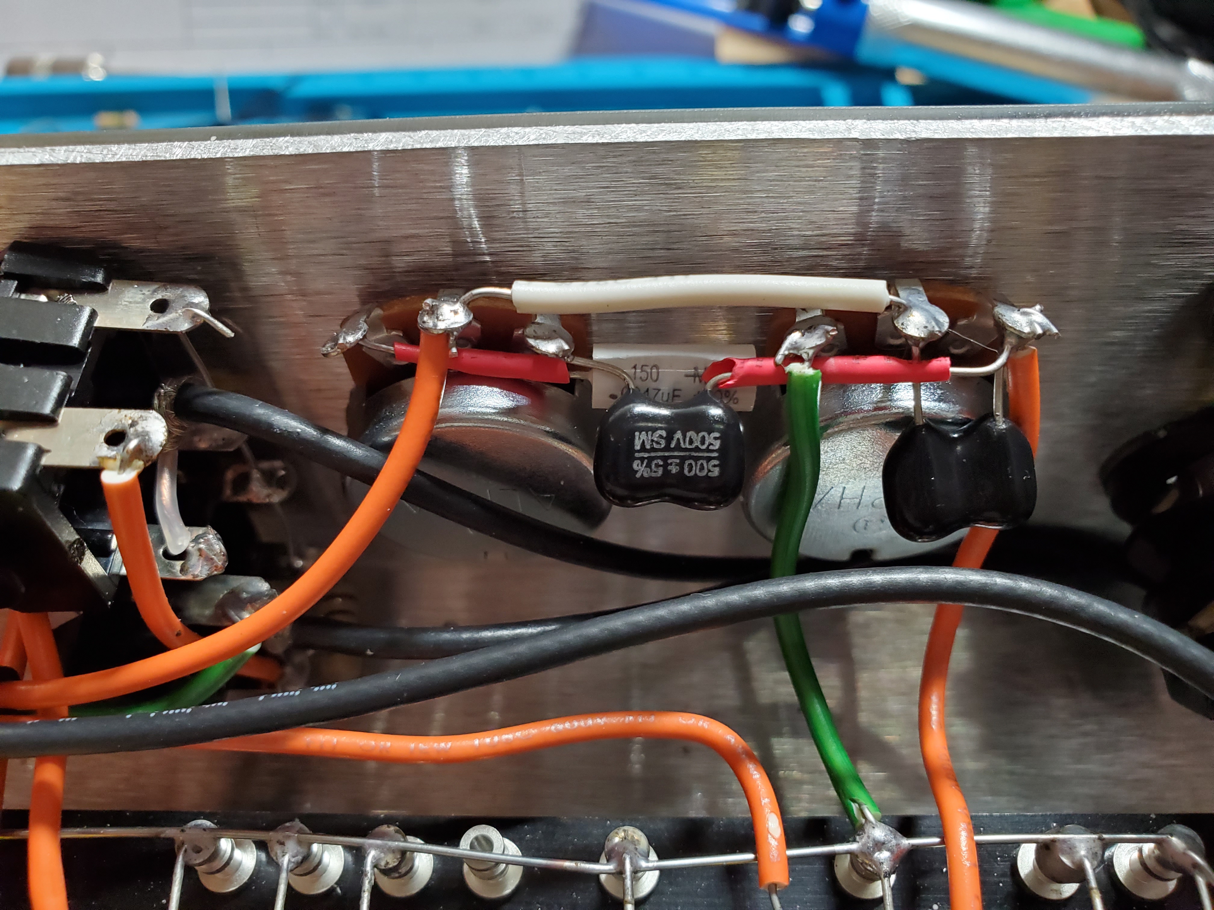

Here are two pictures of the amp.
The closeup pic is of the normal side. The red is some heatshrink helping protect the capacitors. The right capacitor looks like it's touching but it's actually lifted up and out away a bit.

Check the layout on the 500 pf cap(s) connection, they look wrong compared to the layout?? To me anyway, but then I'm looking at a pic and comparing it to a drawing :bugeye:
PostPosted: Sun Mar 15, 2020 11:20 pm
Oops, I'm wrong. But there seems to be a thin wire running between the center and right side lug on the volume control in you closeup shot of two pots, you can see it when you click on the picture and enlarge it. Maybe?

I went back and looked closer at the pots and blew some air on them and it moved. Most likely a small hair or something since it's not on there anymore like the pic now

I was wondering about that object between the terminals on the volume control, too. Sounds like that wasn't the problem, though.
The wiring looks correct. And you say you checked the pot itself and it's good. Can you see the resistance changing if you measure between the center terminal and each of the outer terminals as you rotate the shaft? And you see about 500k measuring across the two outer terminals? You might have to disconnect the wires and capacitors from the pot to get a true reading.

Just a thought triggered by Saz's post. Is it possible where the first 500pf cap's left lead crosses the second one's lead, behind the Volume pot, you melted though the heat shrink insulation and they're touching? Just spitballing here.

Hankules, I did a closer inspection on that heat shrink area and after some partial rebuilding on the pots, the tone knob works now! I think it was something to do with the heat shrink failing on me!
