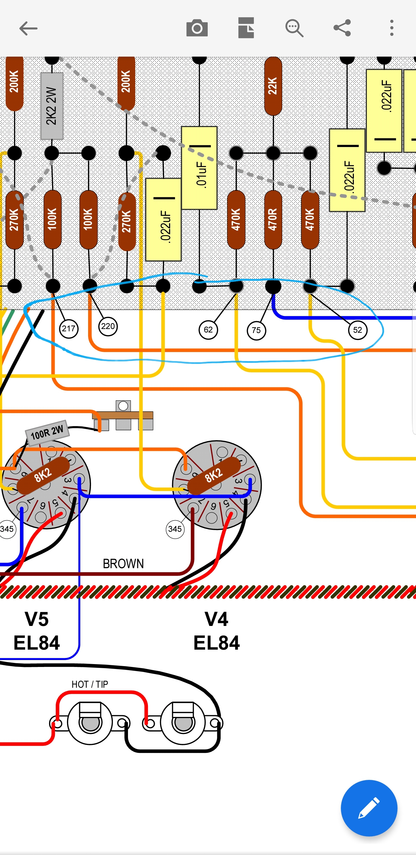

I just ordered a plexi kit with the 6v6 and vrm option. Very excited to start building my kit but as I was looking at the layout for the plexi I noticed circle numbers that's pointing to the turret boards. What do those numbers mean?

The circled numbers are the approximate DC voltages you should see on the turrets they point to.
Good luck with your build!

So the kits come with this kind of layout to follow? That sounds much easier than following a schematic.

Yes, when you are wiring an amp it is easier to follow a good layout diagram rather than a schematic. However, it's easier to see how the circuits function and follow the signal flow if you look at the schematic. So it's a good idea to familiarize yourself with the schematic, especially if you have to troubleshoot or you want to modify the amp.
Learning to read schematics is essential in electronics if you want to progress beyond kit building.
