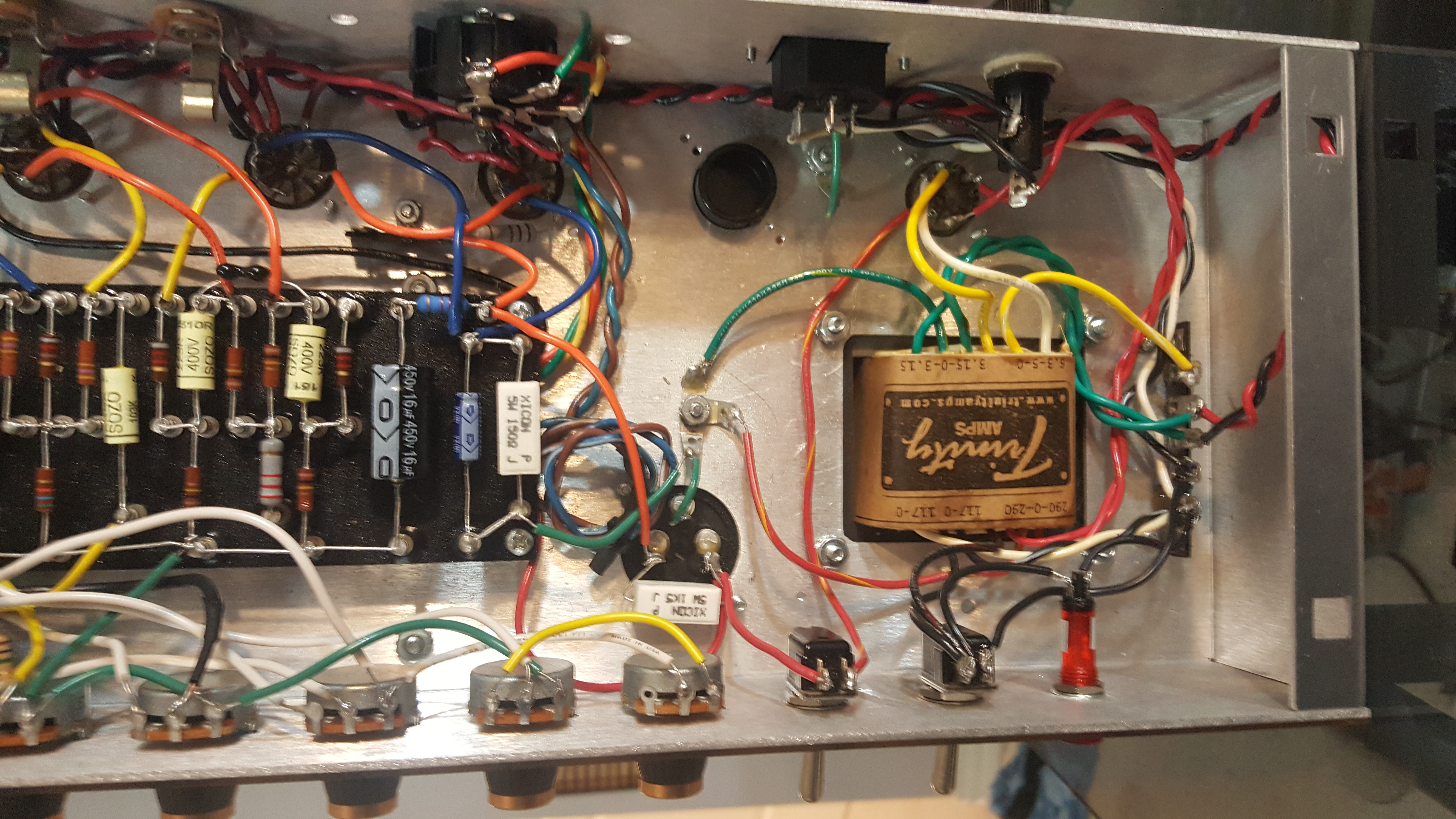

I finished assembly of my 18 watt plexi mk ii, and I have run into some issues that I was hopping you could help me with. My amp seems to work, but just barley. What I noticed is the Normal channels work but sound very crackly and don't have any low decibel response. I really have to dig into my guitar to make a sound, but the sound it makes isn't quiet. Next, I noticed that the brown channels don't work at all. I have double checked the wiring and haven't found anything wrong. Finally, I noticed that my V5 output tube was glowing hotter than the V4 output tube. I swapped the tubes out with each other and still the V5 tube was glowing hotter than the V4. After some research I found that it looks like my tubes aren't biased correctly. I took voltage readings from ground to the heater wire on tube V5 and V4 and they where equal. I have also isolated the "biasing" problem to when the amp ins't in stand by. By this I mean that when I flip the power switch everything looks good, but when I flip the standby switch the V5 output tube quickly overheats, even when all nobs are at 0.
My finally, is how close should all the voltage readings be? I took readings from all the points indicated on the schematic diagram, and most where very close but some where further off. Some of the further off readings are, (listed as what it should be- then what I measured) 12-27.25, 340-286, 217-168, 180-223, 180-111, 155-113, 1-0.57. All these voltages were measured in DC, from ground to the point shown on the wiring schematic.

Might want to post a picture of the build

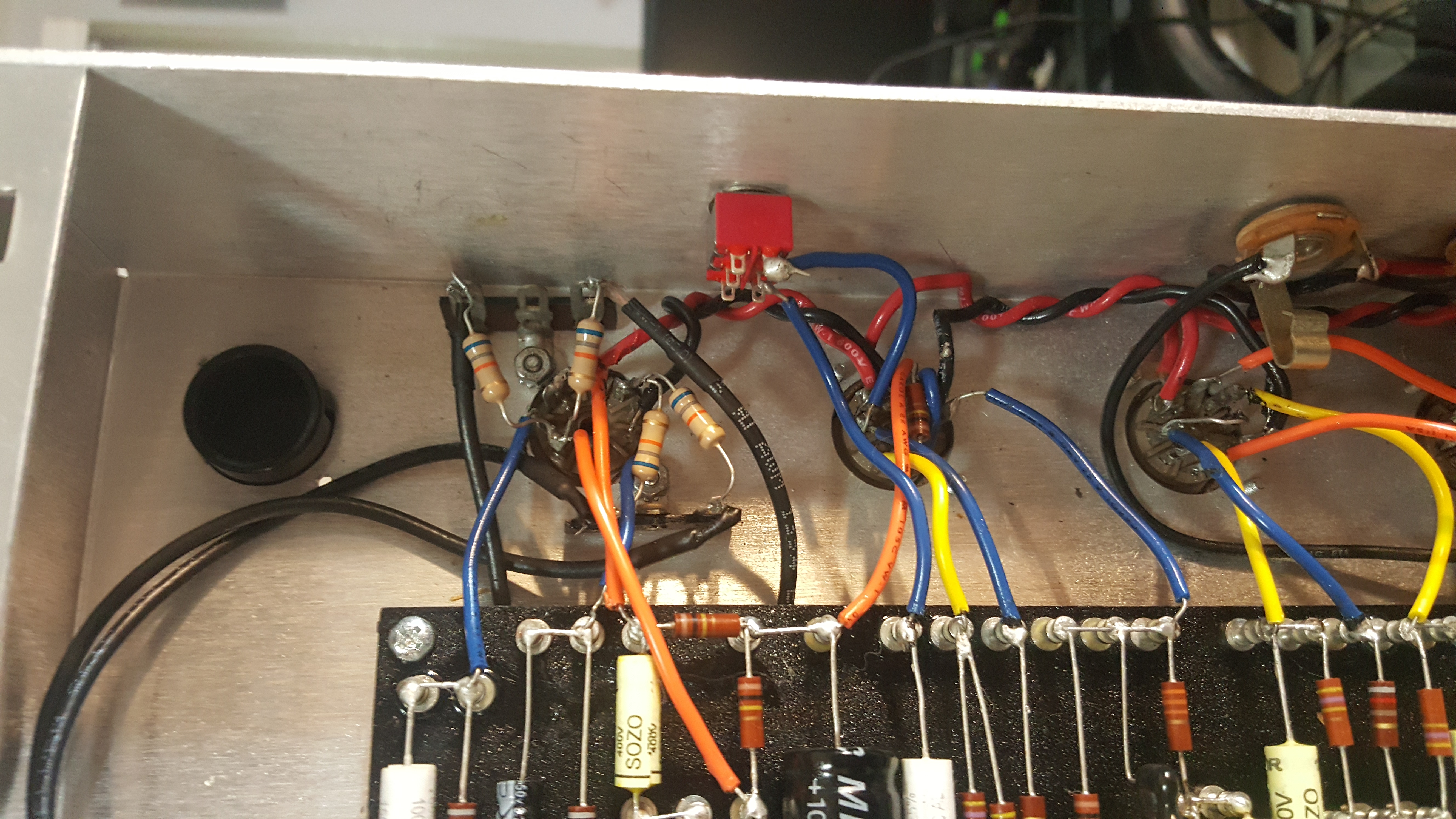

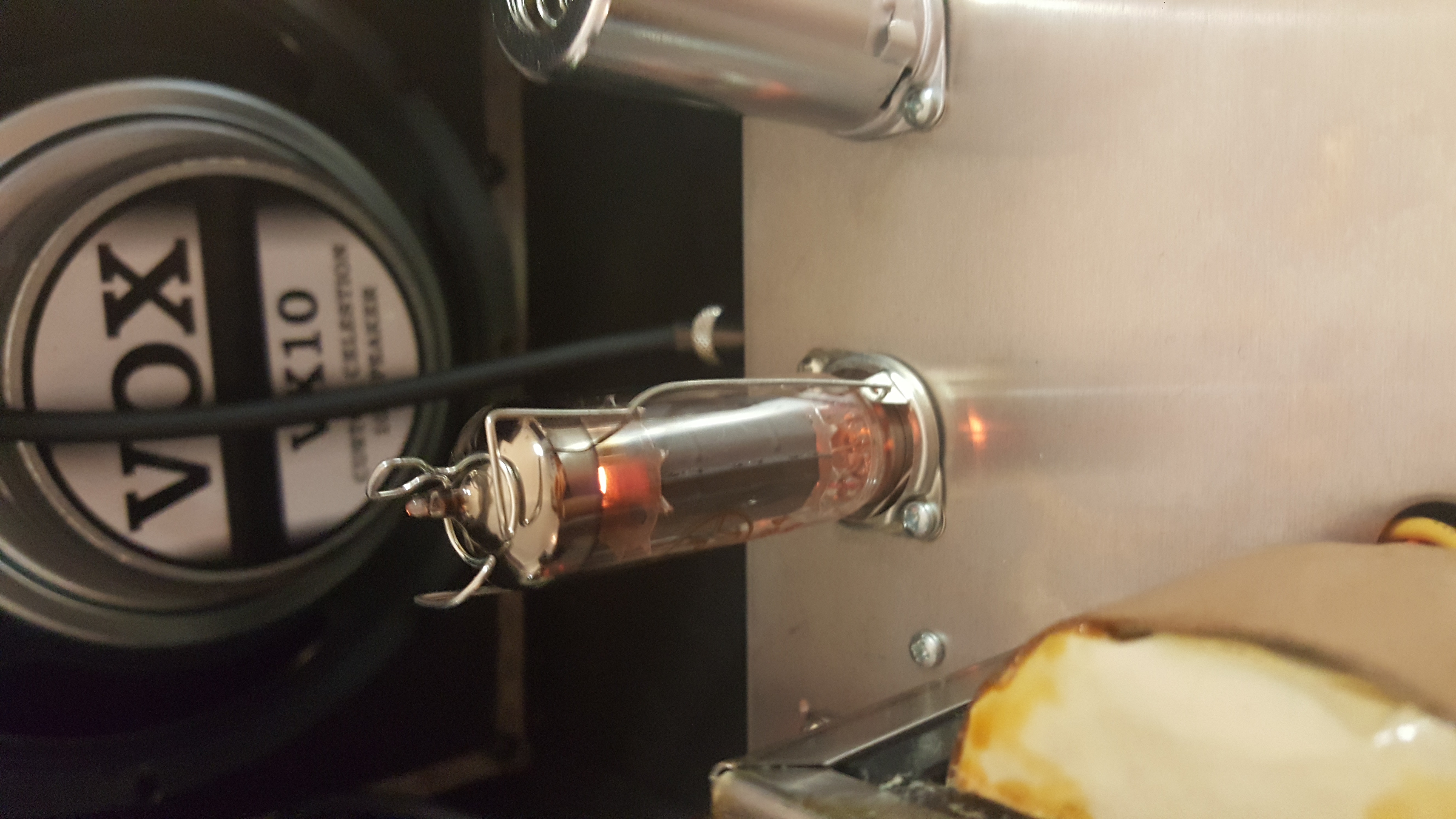

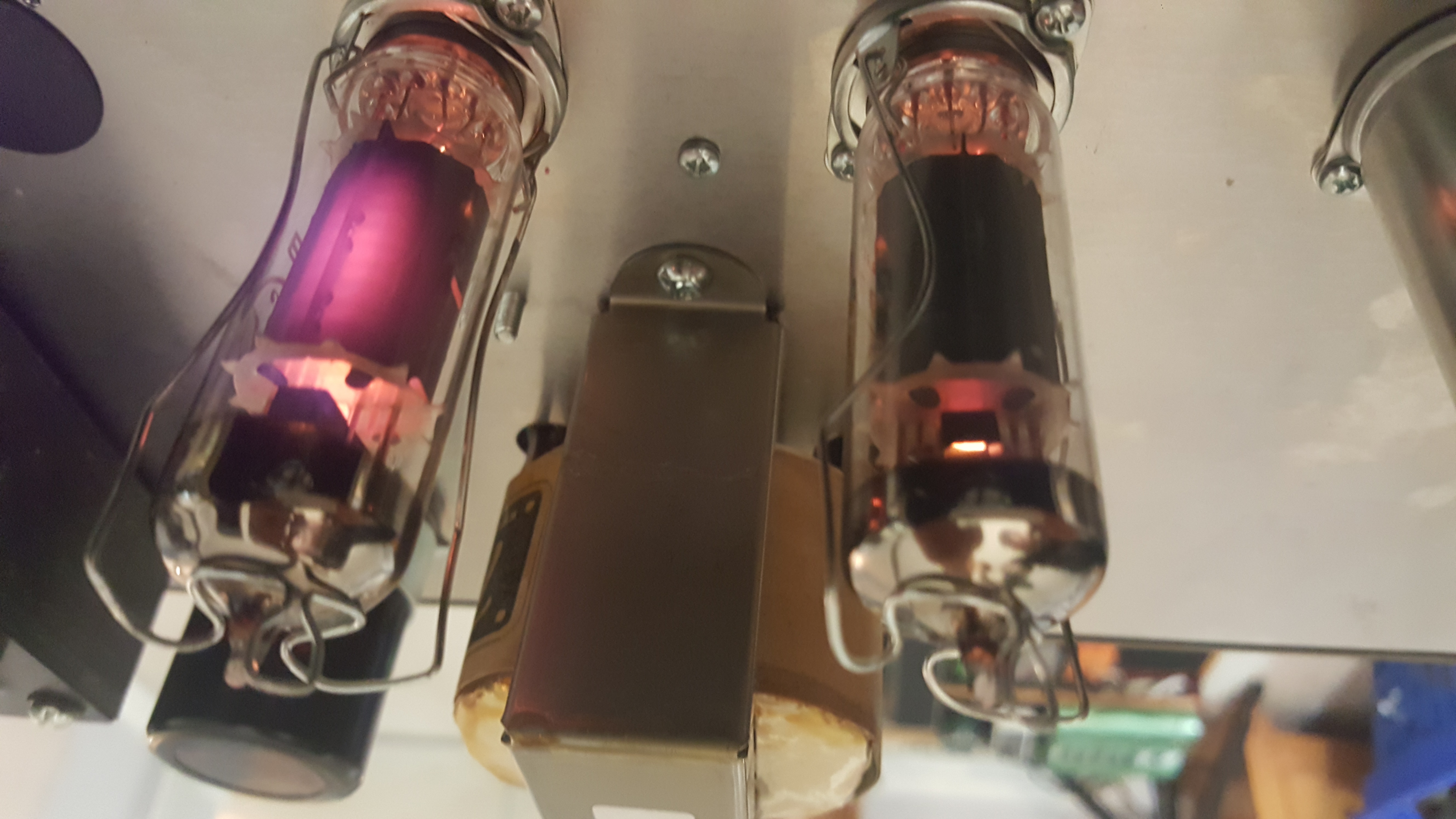

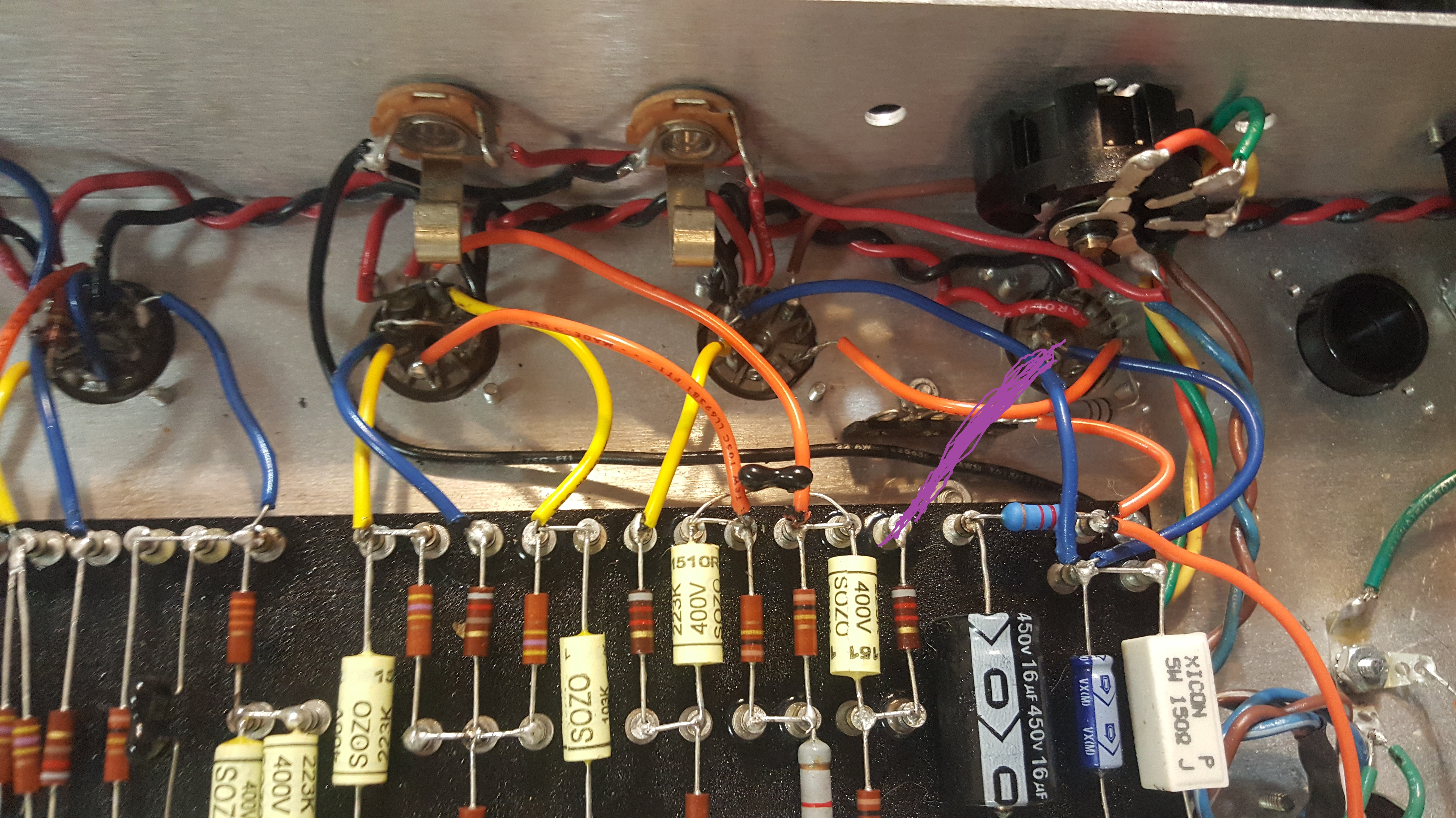

Cant get a good look until i get home but i can see that you do not have a wire going to the grid of what i am presuming is the glowing tube . (pin 2) . the output of the phase inverter has a yellow wire to one el84. and the output of the other side of the P.I has no wire going to the other el84. and i hope that that tubes survives that amount of red plating

the purple scribble is the one your missing

First, I added in the wire from the turret board to pin 2 of V 5. I then proceeded to to a sound check and it appears that not much had changed. With help from a friend who has far more experience working on tube amps we checked the wiring of the amp and made sure that the component values were correct. All of the resisters and capacitors checked out. We also switched around the tubes to see if that could have been the problem. This didn't change anything. The V 5 tube was still glowing far hotter and the amp sounded very crackly and didn't make sound as low decibels.

One question the 100 ohm resistor that is from the screen supply attaches at pin 9 of v5 wit a jumper to pin 9 of v4. Is that resistor touching the screw that holds the tube socket of v5 ?

What i meant was the screw on the tube socket it just looked in the picture that it was just touching the screw
