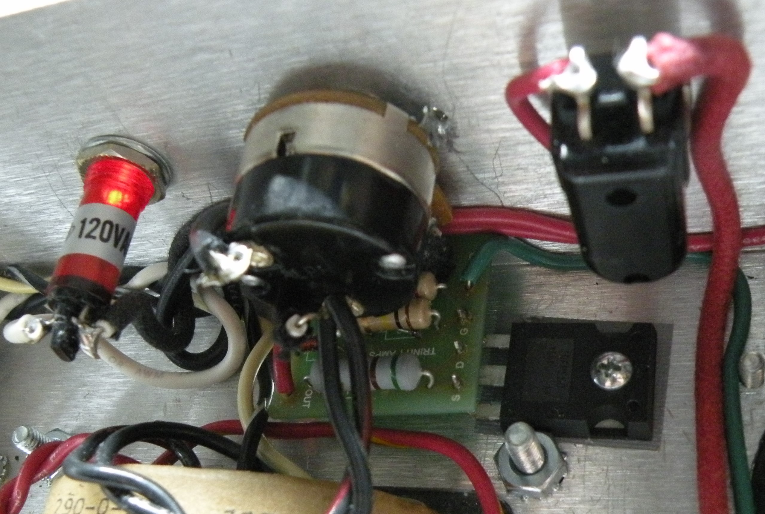

I wanted to post some pictures of my gradual progress. I should have posted these earlier, but I am just now getting to posting the pictures.
The first picture is of the hardware installed on the chassis. I made a few changes/upgrades. First I added an 8-tag terminal strip. The reason for this is that I wanted to have two extra tags available down the line for when I add footswitch relays (which will require an extra capacitor to go on these extra tags). Next, I also changed the 3-tag terminals around V1 to 4-tag terminals (these are for extra convenience when I eventually wire the two VRM DC Coupling Capacitors, which I will install on the fourth tags). The Third, Fourth and Fifth changes are the push-pull 500k potentiomenters for the Bass, Gain and Volume pots on the TMB channel. I will use the Bass push/pull pot for the cathode switch; I will use the Gain push/pull pot for the gain Boost switch; and finally, I will use the Volume push/pull pot for the Cascade Mod (cascading the TMB into the Normal Channel). These three push/pull switches will be more convenient for me to have on the front panel.

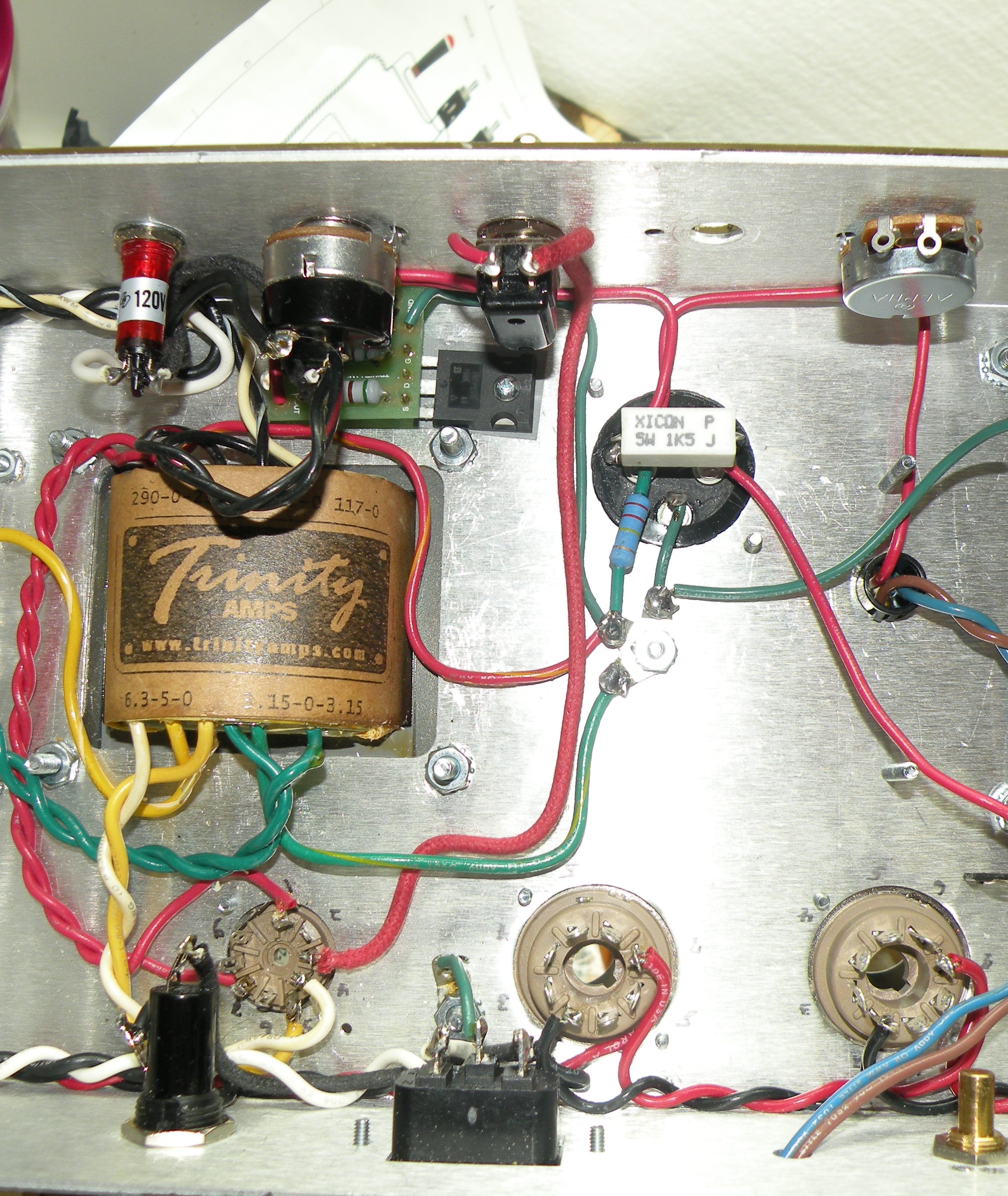

PostPosted: Fri Sep 08, 2017 8:48 pm
Posts: 108
Here are some more pics:
First, Power Transformer and Output Transformer installed (OT primaries twisted and OT secondaries braided). The two extra 5k primary (blue-white, brown-white) tied off with heat-shrink and put outside the chassis (tucked under the OT).
Second, Power Transformer wired to mains, to switch with VRM, to terminal strip and to rectifier.
