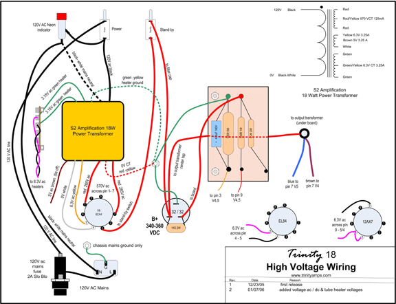

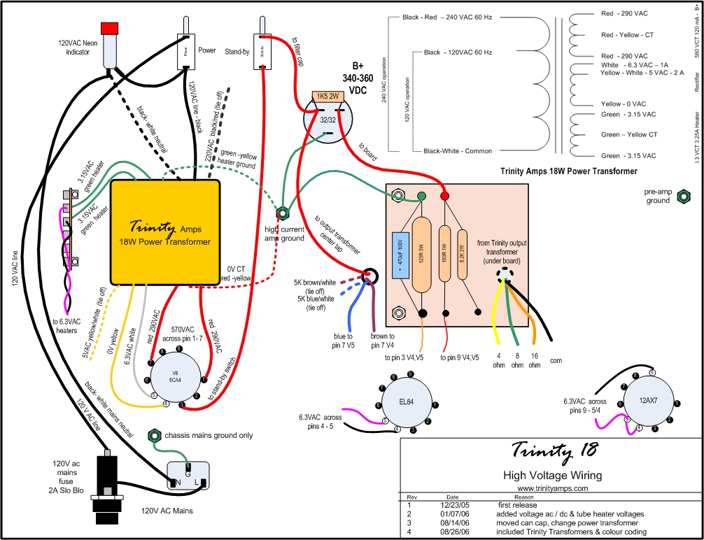

The Trinity 18 High Voltage Diagram Using Trinity Transformers
Full Size for Printing (right click to download):
http://www.trinityamps.com/ForumGallery/trinity/Trinity18_High_Voltage_Wiring_v3.1_print.jpg
The Trinity 18 High Voltage Diagram Using s2 Transformers
http://www.trinityamps.com/ForumGallery ... ngv2sm.jpg

Stephen, could you make this a "sticky" so that it stays with the other build documentation? I found it real helpful when you sent it to me.
PostPosted: Sun Mar 05, 2006 10:29 pm
Thanks, now I'll be able to find it for my next build.
PostPosted: Mon Mar 06, 2006 8:43 am
One's not enough? :D I hear you (all the way from Toronto!)
PostPosted: Fri May 19, 2006 6:35 am
Trinity Transfomers Schematic:
http://www.trinityamps.com/ForumGallery ... ormers.pdf
