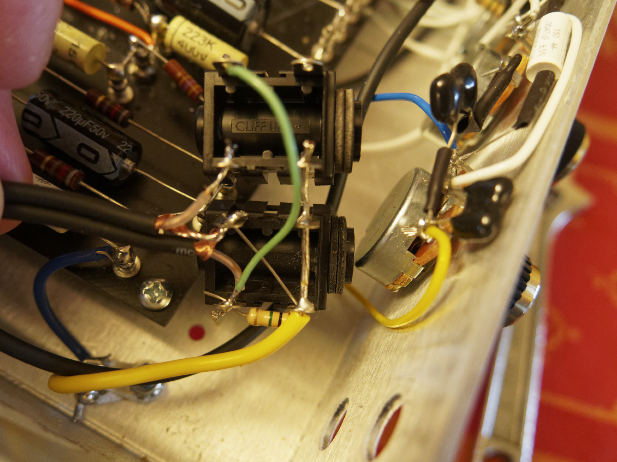

What I did:
Checked, double-checked and rechecked layout to make sure everything is wired correctly. I decided to be fancy this time and have my flying leads (mostly) under the board. They were checked by continuity.
Checked grounds, all at fractions of an ohm.
Replaced 32/32 500V cap can (suspected filtering).
While checking the PI socket, touching pin 7 gave me the slight hum and whoosh of a properly running amp. Plugged in and TMB channel had good output. Then it went back to low, spitty and distorted. I assumed there was a bad solder joint and redid the entire socket. Turned it on and all back to NG.
Rewired input jacks.
Checked continuity of shielded leads and made sure ground were isolated with plug in socket. All look good.
Reflowed anything that looked marginal. Board was built by Trinity and looked wonderful, but I still checked through.
Suspected OT, but the short time I had with good output and the popping while testing lets me think it's OK.
Installed known good tubes (My Lightning is naked now!!)
At wit's end here, I don't know where to go next.

Some progress. I did flying leads on the bottom of the board for the first time because it looks so cool. Obviously I don't know what I'm doing.
I removed the controls to allow me to flip the board. Reflowed every joint except 2 which just didn't look right to me. I reconnected these to the top of the board, wrapping the turret as I like to do.
Now Normal channel works fine, loud, clear and sounding good. There is a little background sputtering but I'm sure it's related to TMB channel problems.
TMB is still low in volume, spitty and distorted. Since Normal channel bypasses V2, while TMB channel doesn't I'm going to concentrate there. I've got my Saturday morning cut out for me.

'I give up.
Tomorrow I'm stripping the whole thing down and rewiring from scratch. This is just weird.
Normal channel sounds good, so OT, PT, PI and Power section are fine.
Nothing plugged into input jack hums real bad like open circuit.
Either a coupling cap is dead and wide open or I screwed up the wiring, although I can't find anything.
I have no way to check caps, although I'm sure I didn't overheat anything, so I'm rewiring from scratch, top of the board.

Too late, I did rewire everything, to no avail.
Connections have been checked and double-checked.
But, went over board with layout and schematic in hand and found one error. Moved one jumper and IT'S ALIVE!!
