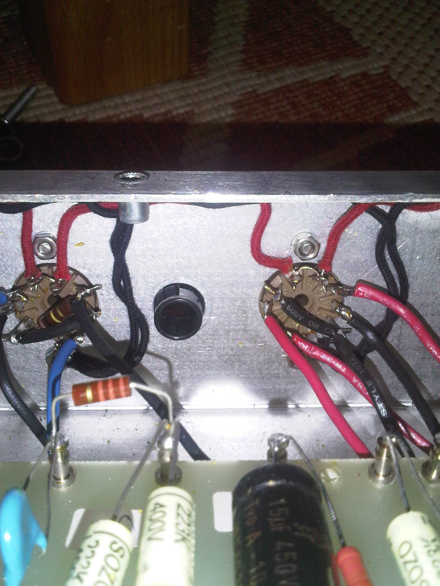

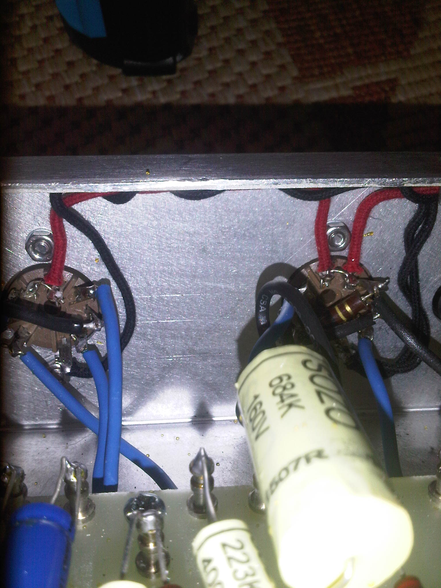

OK, for the AC hum, it's definitely 50Hz (Europe), so from what I've read it's probably du to electromagnetical prb, between heaters and DC. Some leak trhough the signal. I've made a test : this 50Hz hum is present even if the three 12Ax7 are out the chassis, I may not suspect them. Does it mean that the prb could come from the wiring near the power tubes?
The 6,3V (green) for heating power and preamp tubes is center taped.
I don't know if i correctly wired the heaters. here are some pics.
thanks to let me know if you see something like : :shock:
PS: when I see the mess in my '73 princeton rev with no hum at all, i'm shocked.

PostPosted: Fri Aug 07, 2015 12:33 pm
Make sure the heaters wires go to the same pins on all the tubes. i.e. keep the polarity the same.
You can connect the output jack common directly to the OT. The Jack can be isoalted from the chassi or not.
See if the output tubes are not badly mismatched.
The twisted heater wires look Ok but it seems the issue is at the output stage
Tale a look at one of our layouts in the resource section and compare the grounding and output layout.

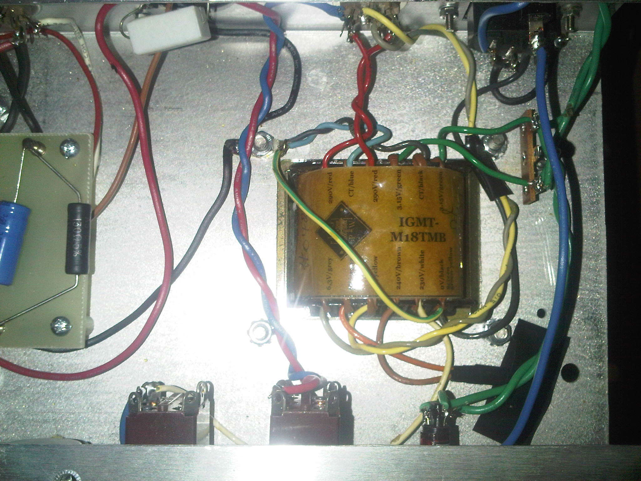

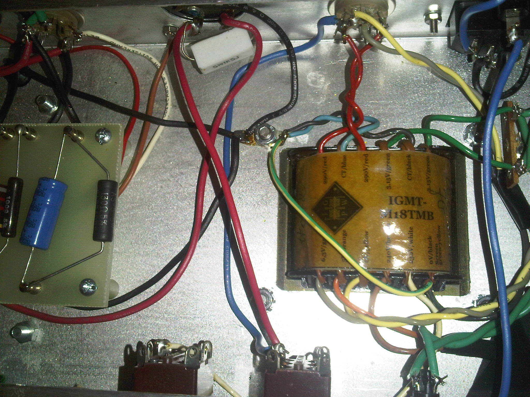

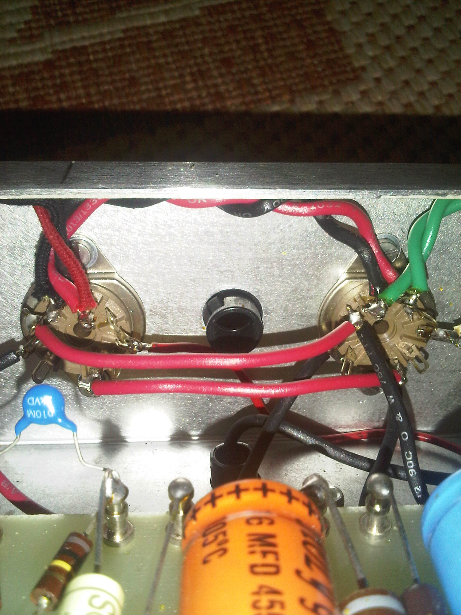

PostPosted: Fri Aug 07, 2015 8:15 pm
Joined: Wed Jul 29, 2015 4:37 am
Posts: 16
I'm not far from giving up...
I've redone the wiring of the power section. Here are two pics, showing before and after the changes.
The amp still amplifies 50 cycles (with or without all 3 preamp tubes)...
in the second pic (the actual wiring), the blue and red twisted wires are B+. B+ and grounds lie on the chassis. on the left, the brown one (from OT) and the red one (from board) go to the cap can. The blue one on the right is lifted and is the hot wire from AC outlet.
I've also disconnected ground to common on OT.
I've read some installs a hum pot for this kind of issue, as Fender did during Silverface period. Don't know if it could change anything here.
if you have others suggestions...

PostPosted: Fri Aug 07, 2015 11:16 pm
Yes a hum pot can,ale a difference. You can also lift the heater ground off and use two 100R from each to ground in case the 0V is not perfect. You could measure that as well.
Finally, you can 'lift' the heater voltages to a DC level by connecting the heater centre. tap to the power tube cathode point. See the 18W build by kurtlives
