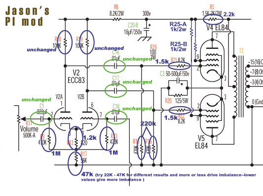

I read somewhere that there is a mod for 18W called "jason mod" or something ike that wich can increase the amps headroom.

Haven't heard of that specific mod but if I had to guess I would be inclined to think it has to deal with the bias of the PI and the "tail" resistor. You can essentially manipulate the headroom (swing) of the PI with one resistor value.
Google PIG mod (Phase inverter gain), tail resistor headroom, etc.
PostPosted: Mon Mar 09, 2015 12:40 pm
Lower the PI Tail resistor to get more gain of go the opposit way. Add 10K at a time or put in a 50K trim pot in series with the existing 56K tail resistor. you can also decrease the TMB Volume / Gain pot to 500K from 1M if you havent already done that. Or reduce the Pre amp drive with a small voltage divider just before the next stage (470K /470K ) is also a decent starting point.

For more clean range you can also change the EL84s' grid reference (grid leak) resistors R18, R19 from 470k to 220k.
PostPosted: Wed Mar 11, 2015 10:43 am
Jason's Phase Inverter Mod

I've tried 12AT7 and 12AY7 in the 18-watter and while it was "cleaner" it was not anywhere near "clean" at higher volume. It cleans-up somewhat with the guitar knob at the sacrifice of overall volume but frankly this amp is not known for stellar clean tones. Most of the distortion is created in the phase inverter and the power amp so messing with the preamp tube only goes so far. That's why the Jason mods focus on the phase inverter and power amp resistor values.
