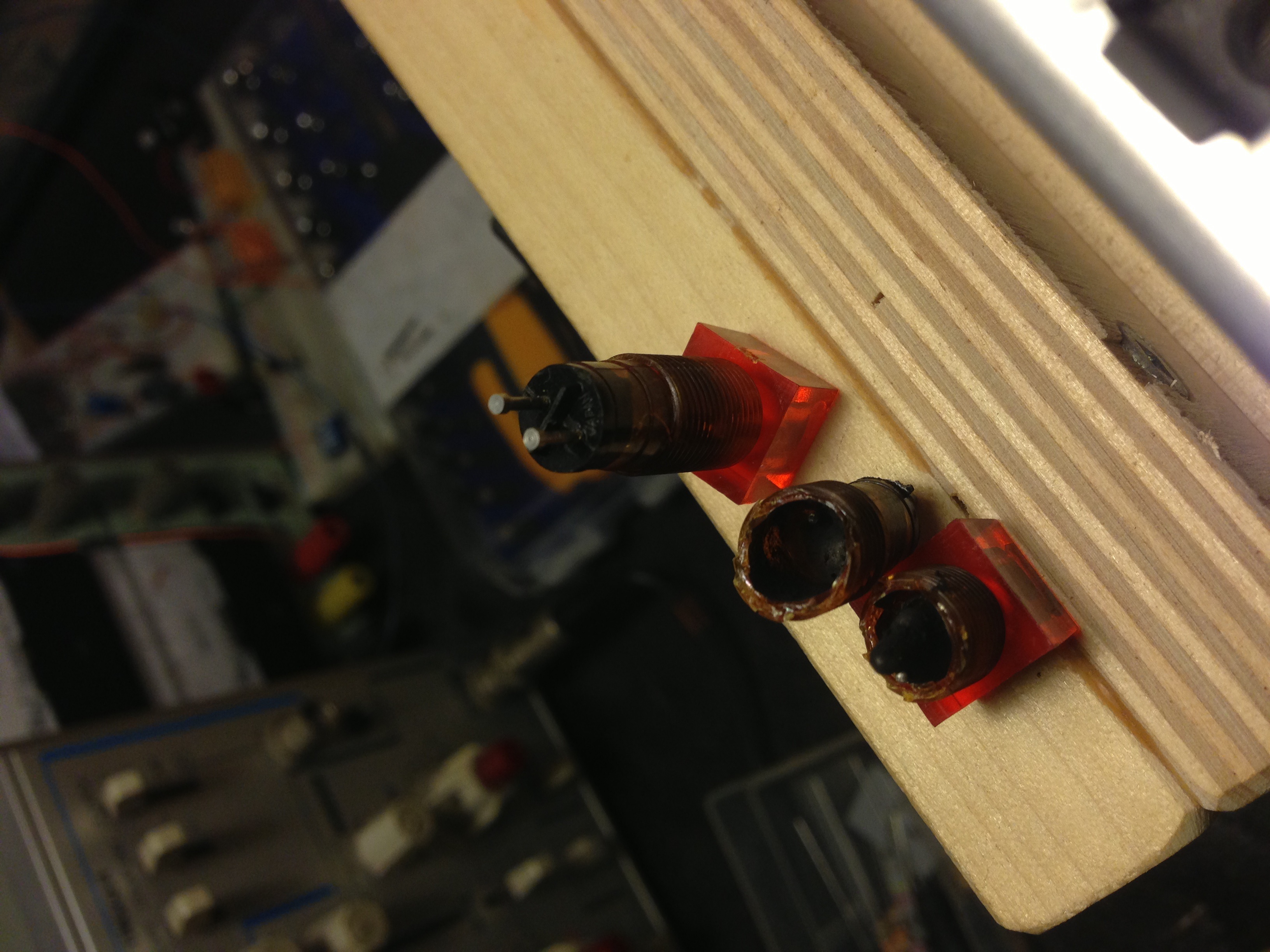

Got some parts in today...
Finally got the square neon indicators I've been looking for. I bought four of them. Two of them I already blew up in a smokey flashy mess. Turns out these indicators don't have the limiting resistors in them that I'm used to. Fffffff :bugeye: :damntech: :x
The neon indicator Trinity provides in their kits have 33K 1/4W resistors built in so I'll probably use that value.

PostPosted: Mon Dec 10, 2012 8:10 pm
Yep these indicators are burnt
PostPosted: Mon Dec 10, 2012 9:10 pm
Science experiments - 101. :P
