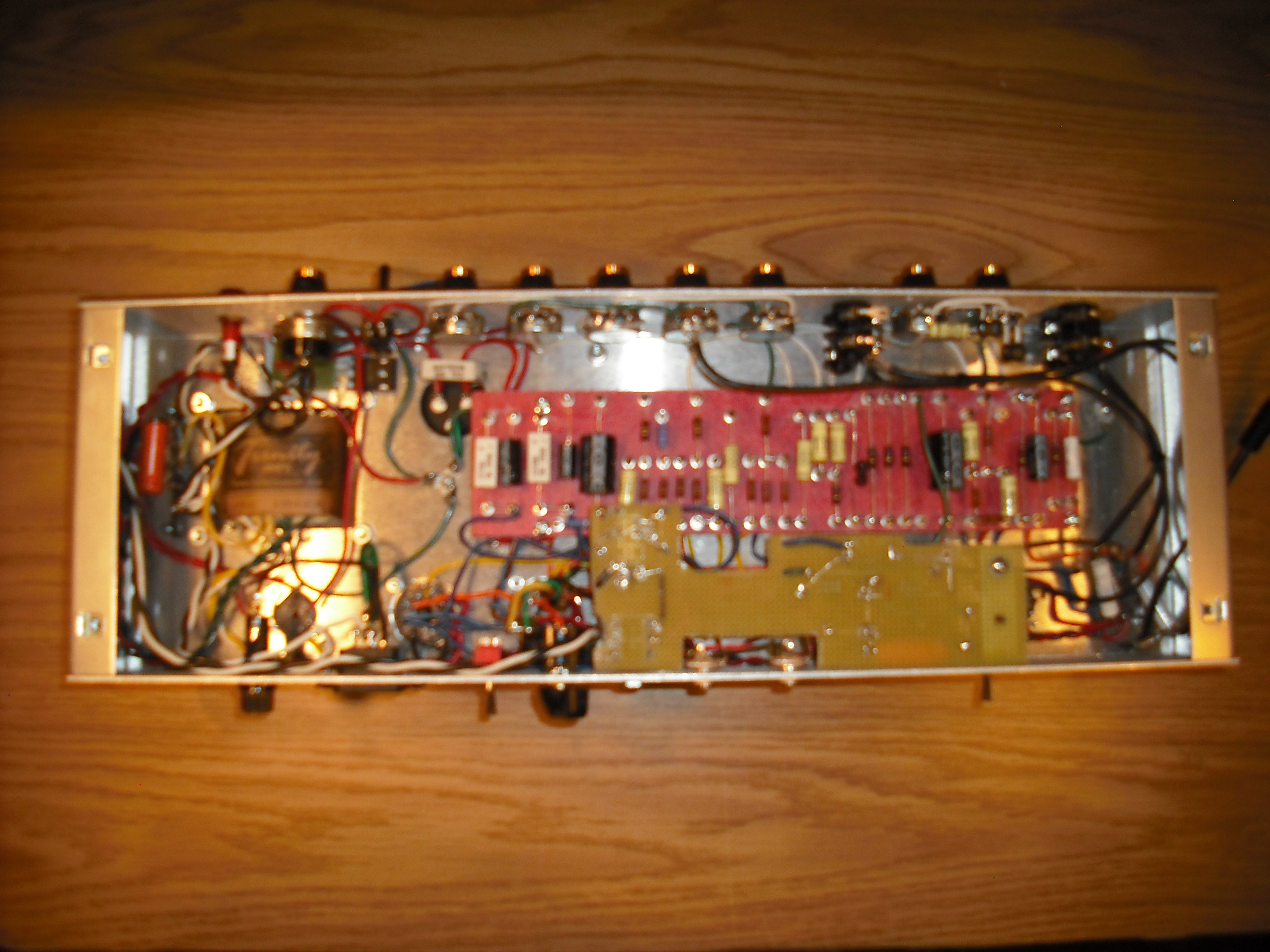

couple of high res pictures left side right side would help
 Post subject: Re: Plexi v6 Build
PostPosted: Sun Aug 03, 2014 10:19 pm
Posts: 49
Very Clean Kit - happened to get the wrong layout and schematic, but downloaded the correct ones from the website...

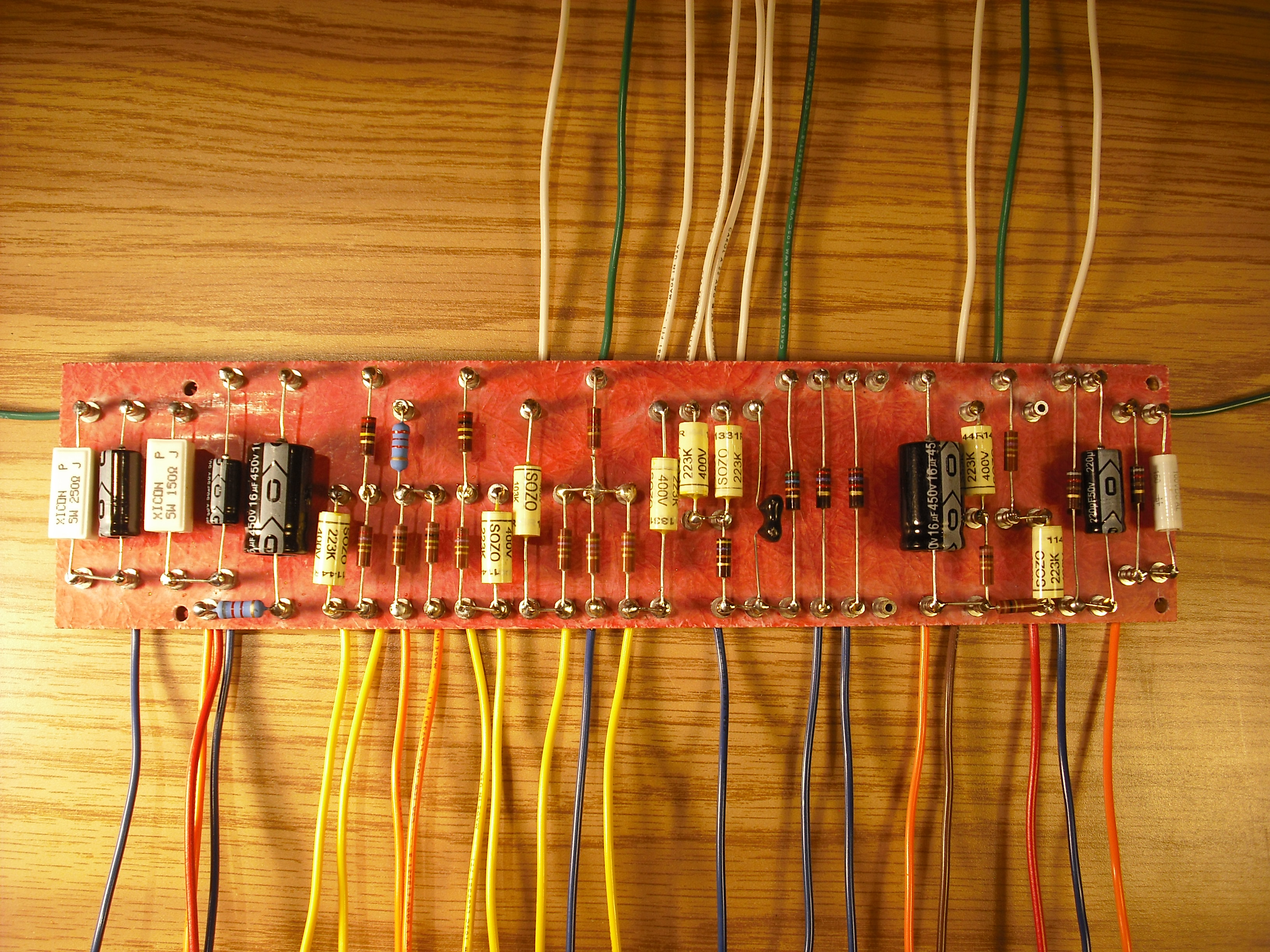

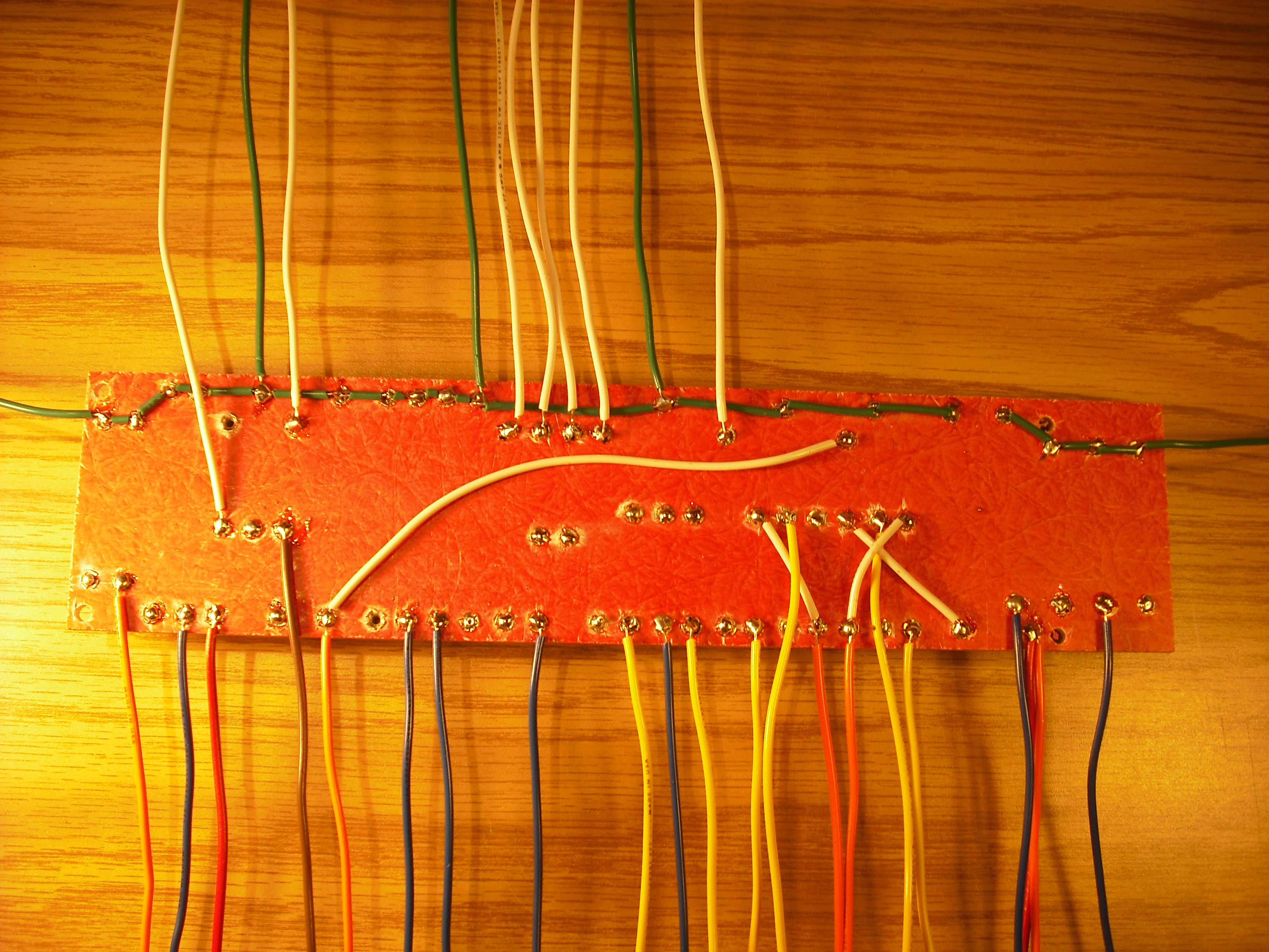

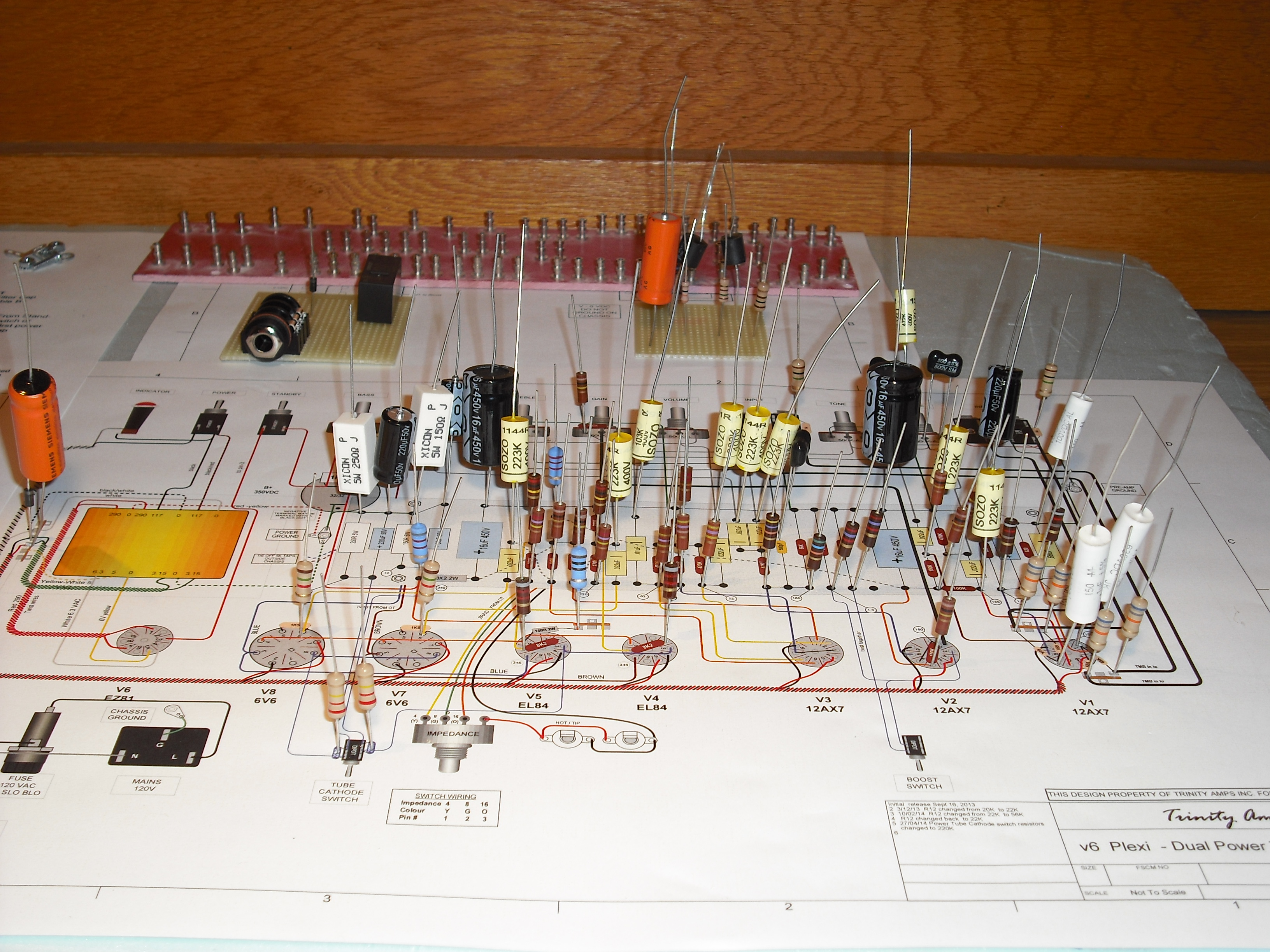

Layout all the parts and get ready to solder.

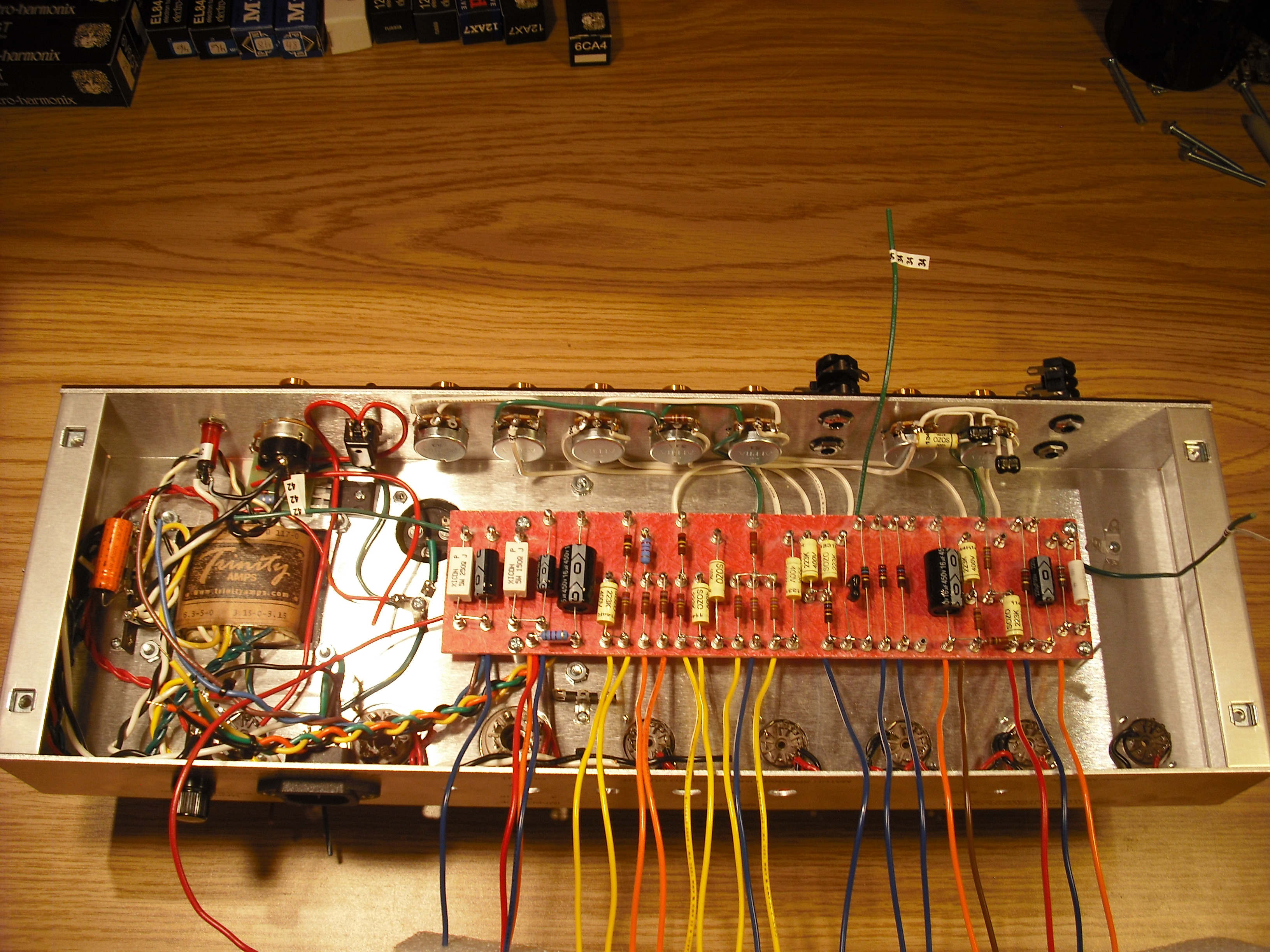

Board complete... Soldered the fly wires to the bottom of the turret to try to keep the build neat...

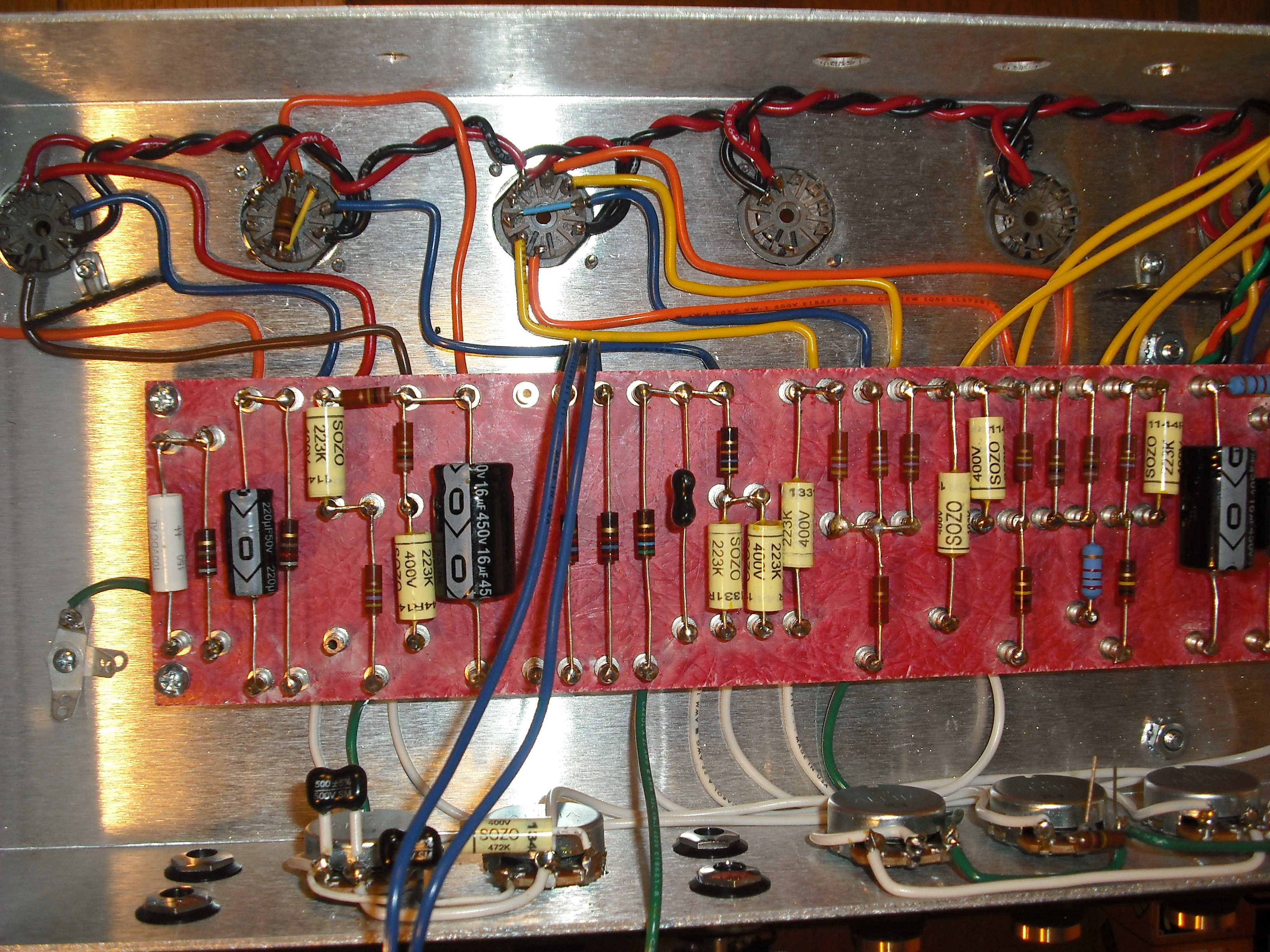

Ground bus on the bottom of the board as well.

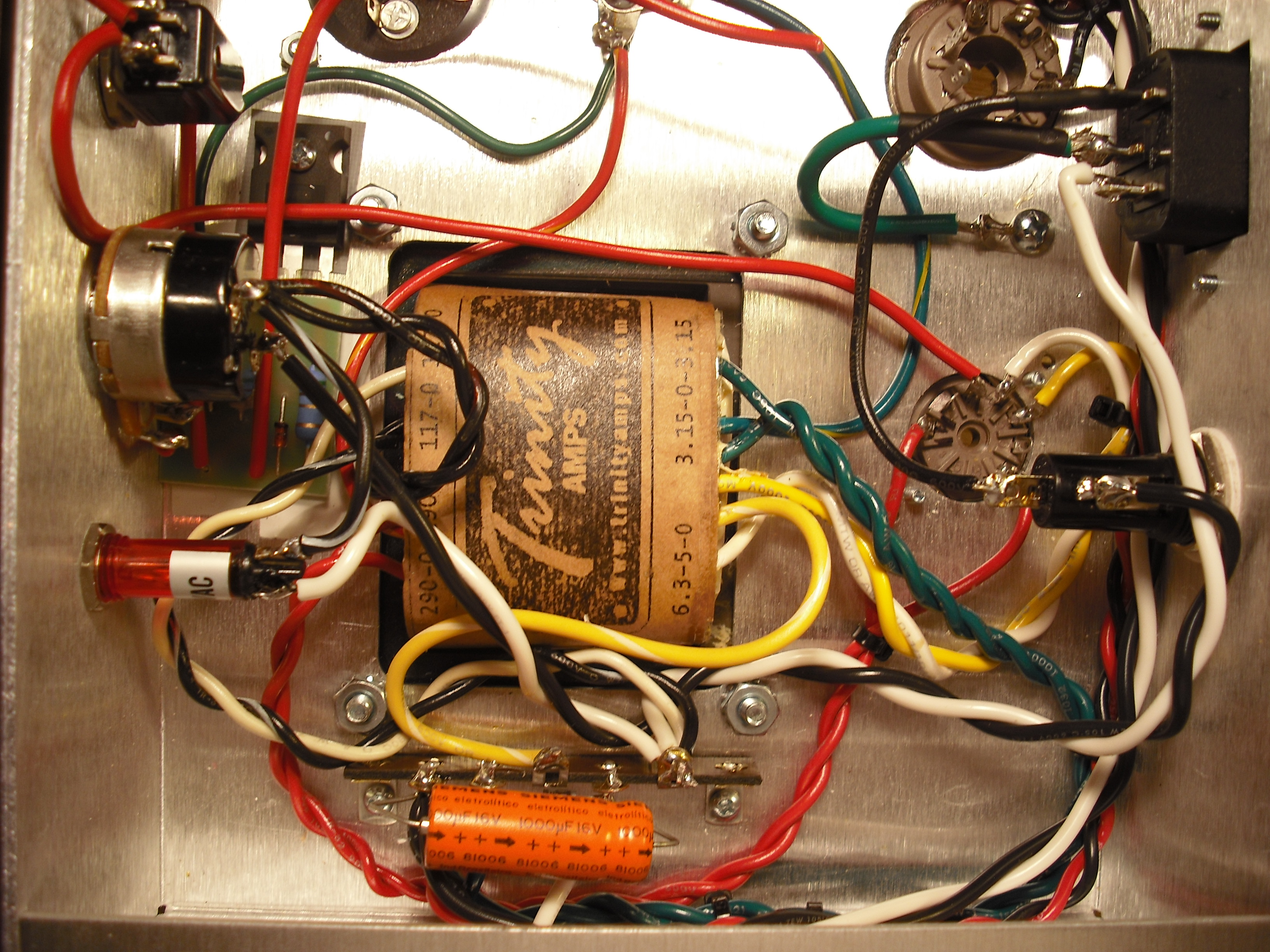

Wired up and tested the PT.

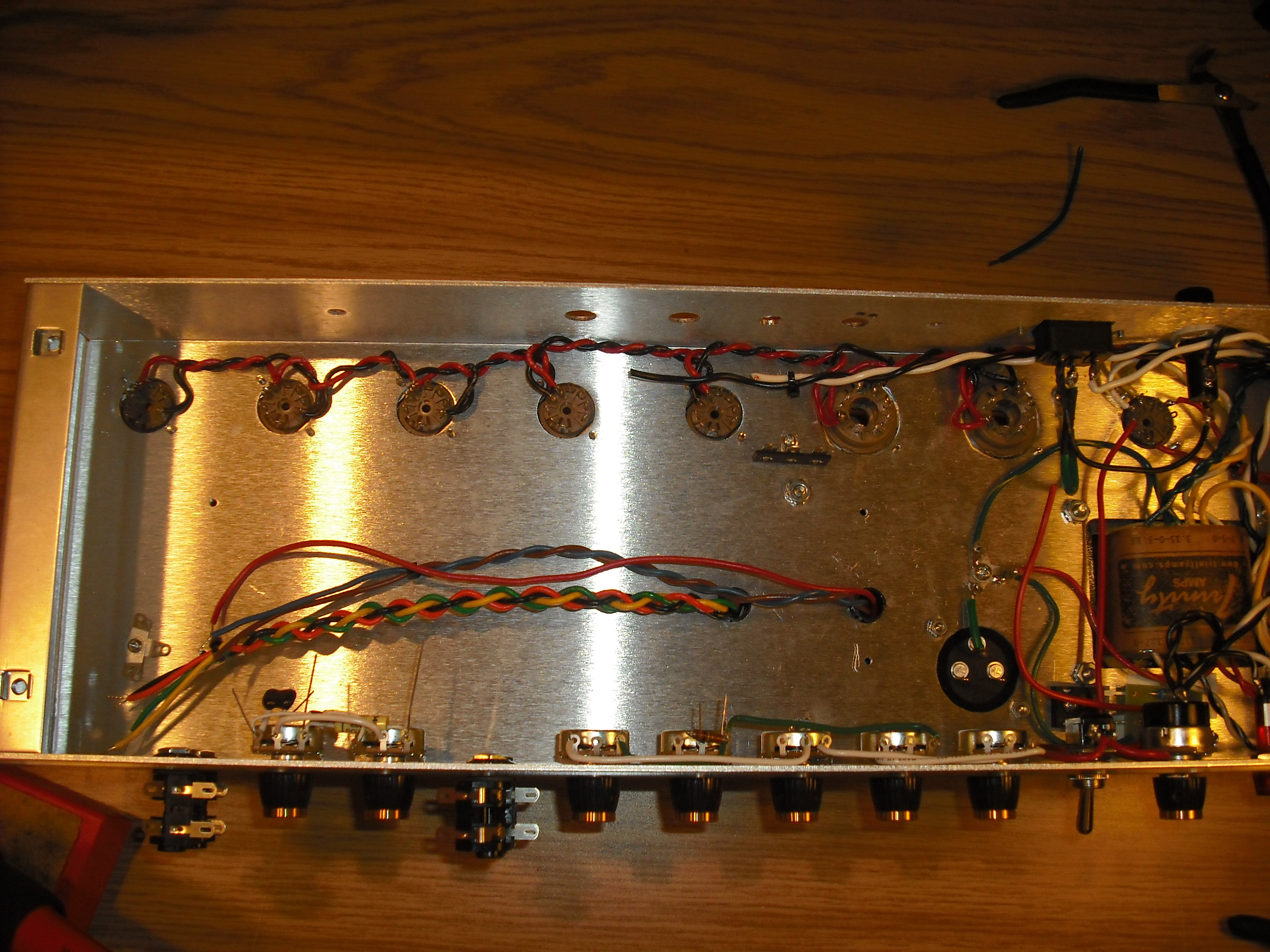

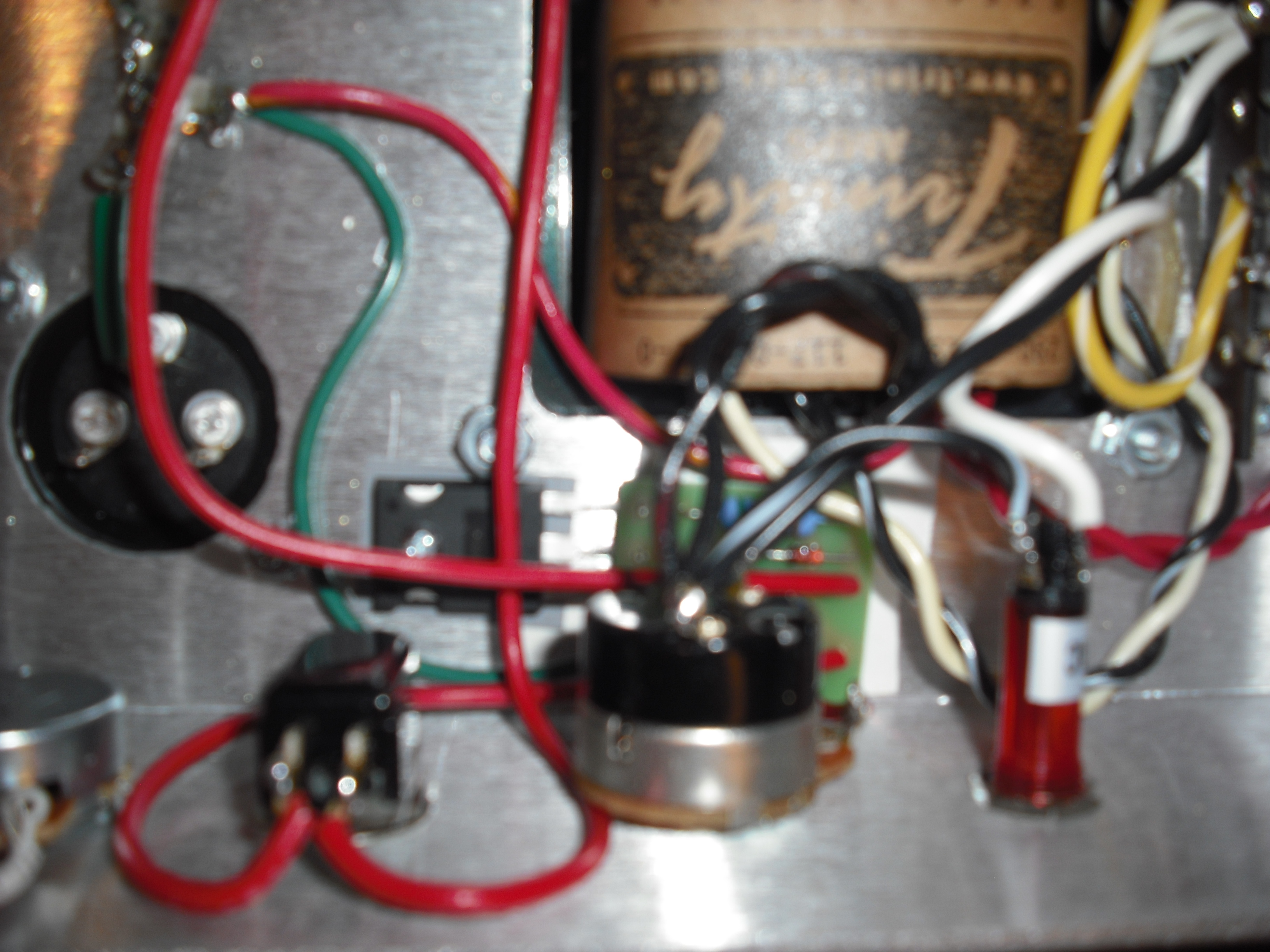

Wired up the Heaters.
Connect up the VRM.

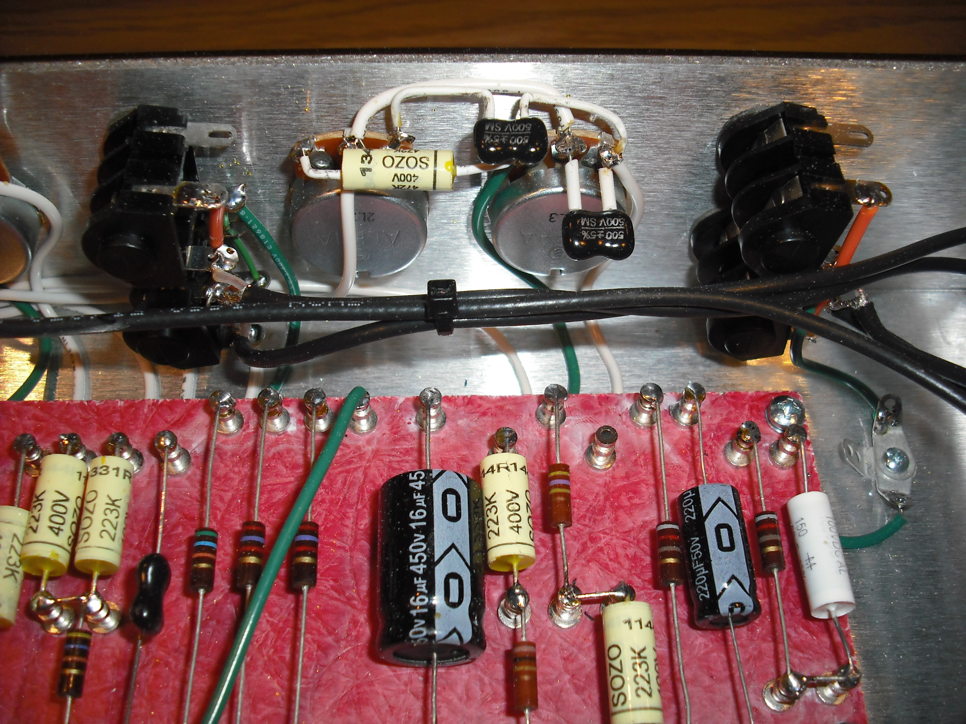

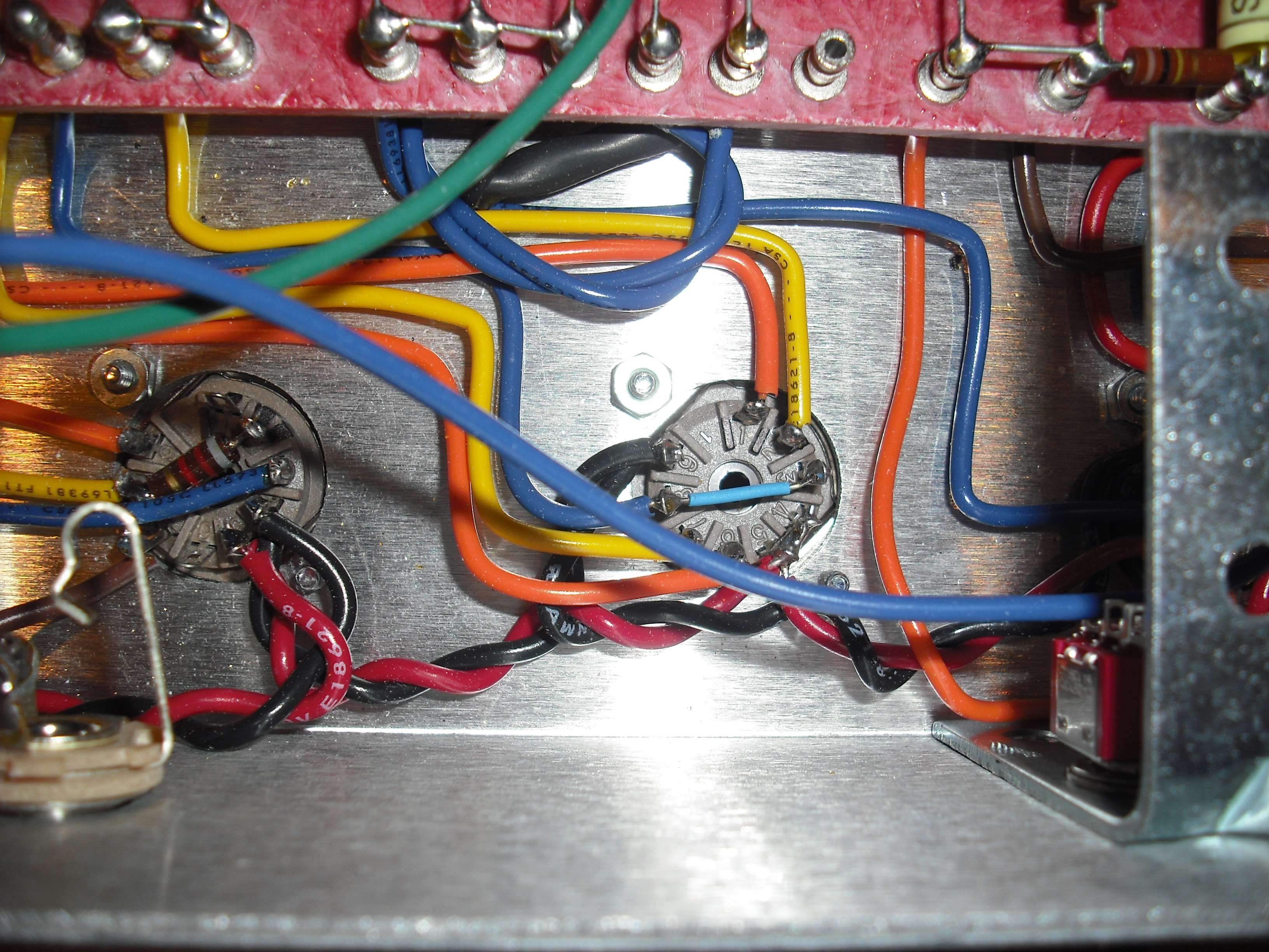

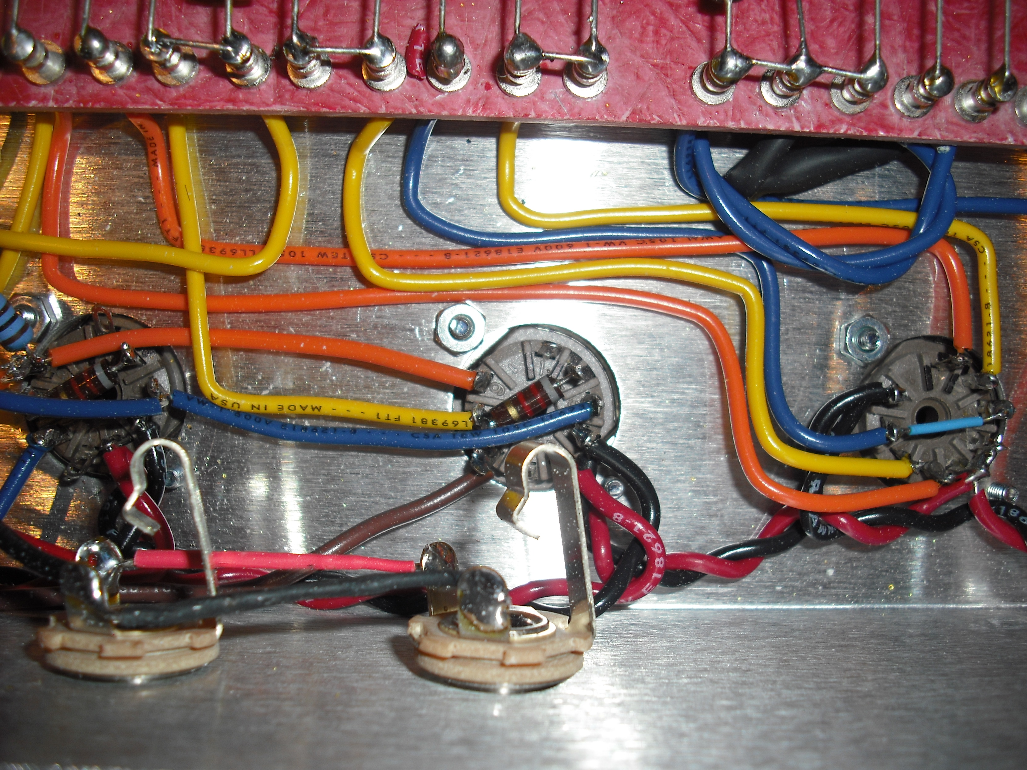

Wire up the pre amps.
Finish wiring up the input jacks.
Connect the Input Jacks to V1 and the Gain to V2.
Finish V3.
Note : Originally I was connecting up the boost and cathode switch boards, but, I had an issue and went back and removed these and went back to the stock design to make sure everything works correctly... I am in the process of debugging some voltage issues and once they are solved, I will go back and try to get the boards working..

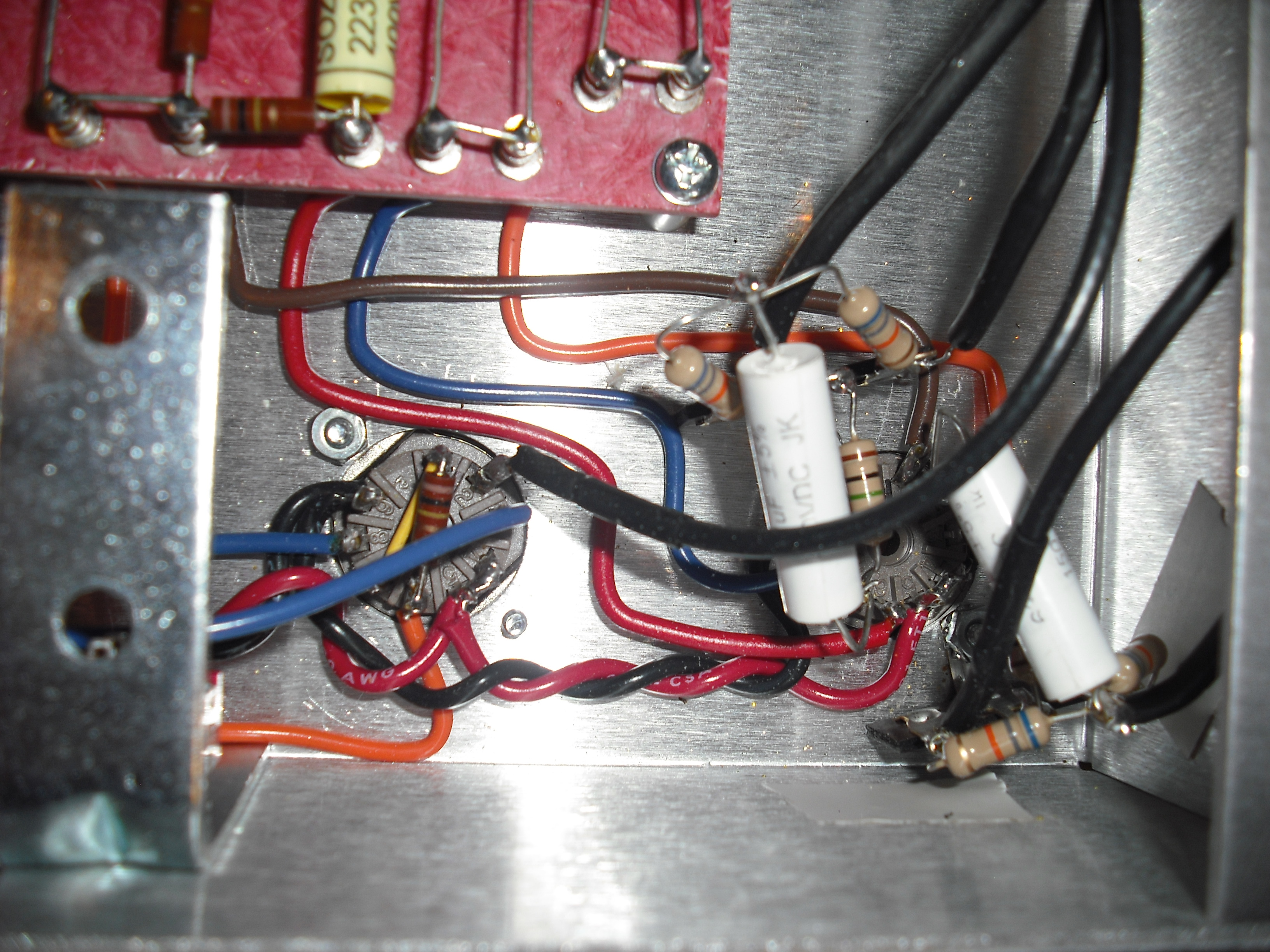

V4 & V5 EL84's an the output jacks.
V6 & V7 6V6's

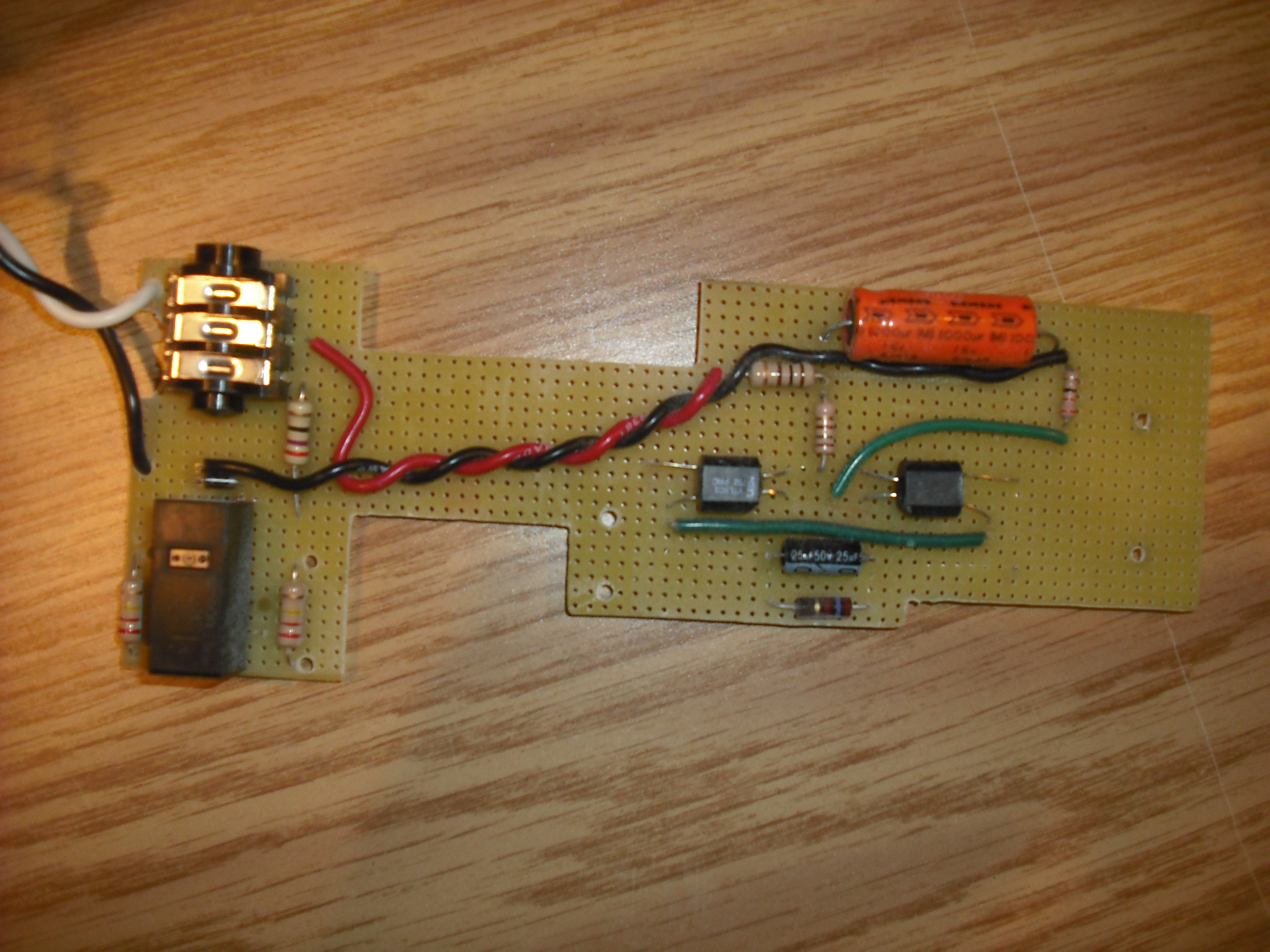

Custom board - combine the boost and switch into one board..
This allows the use of an "L" bracket to hold the entire board.
(Note - I have removed this till I get the correct voltages.)
This is what the board will eventually look like...
NOTES : The next time i make one of these boards, i will turn the relay 90 degrees so that it does not hit the turret board...

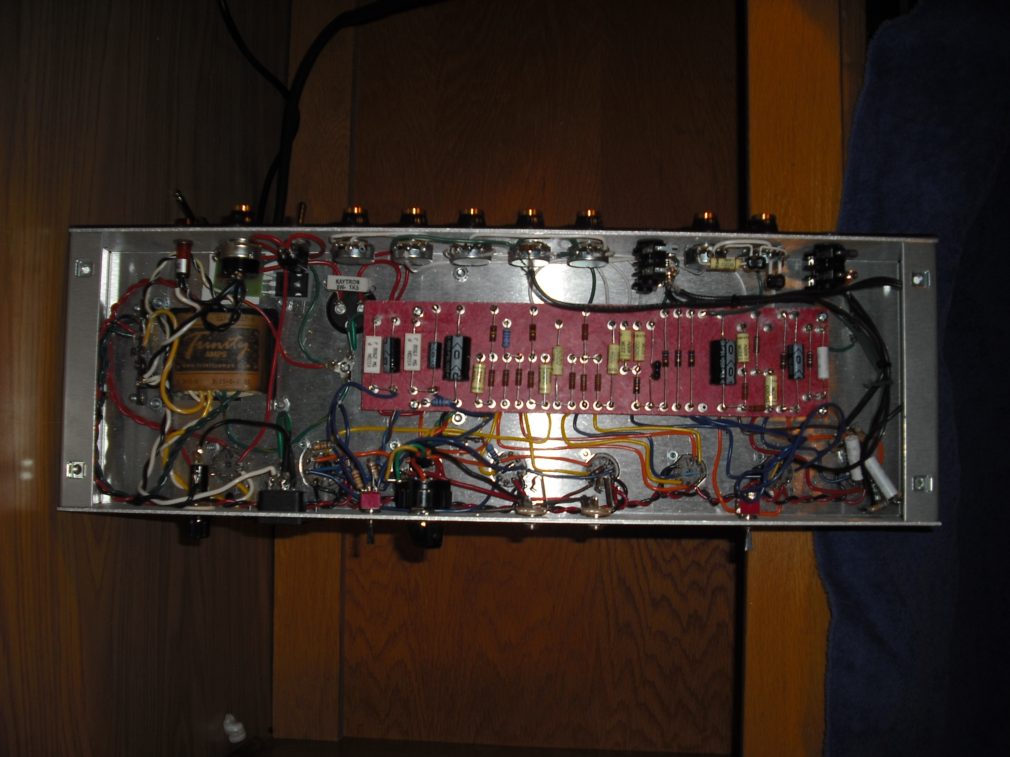

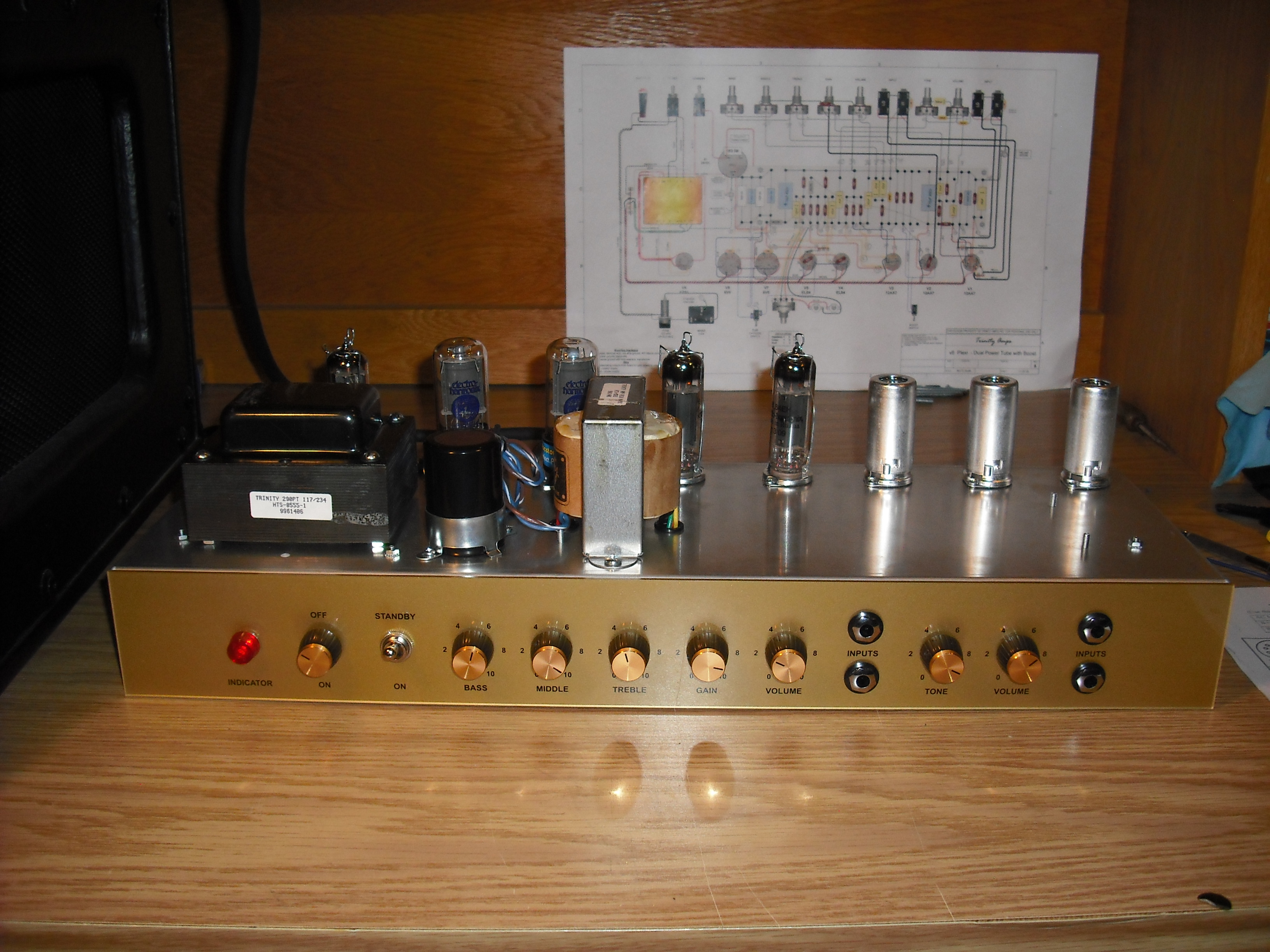

Current state of the build.

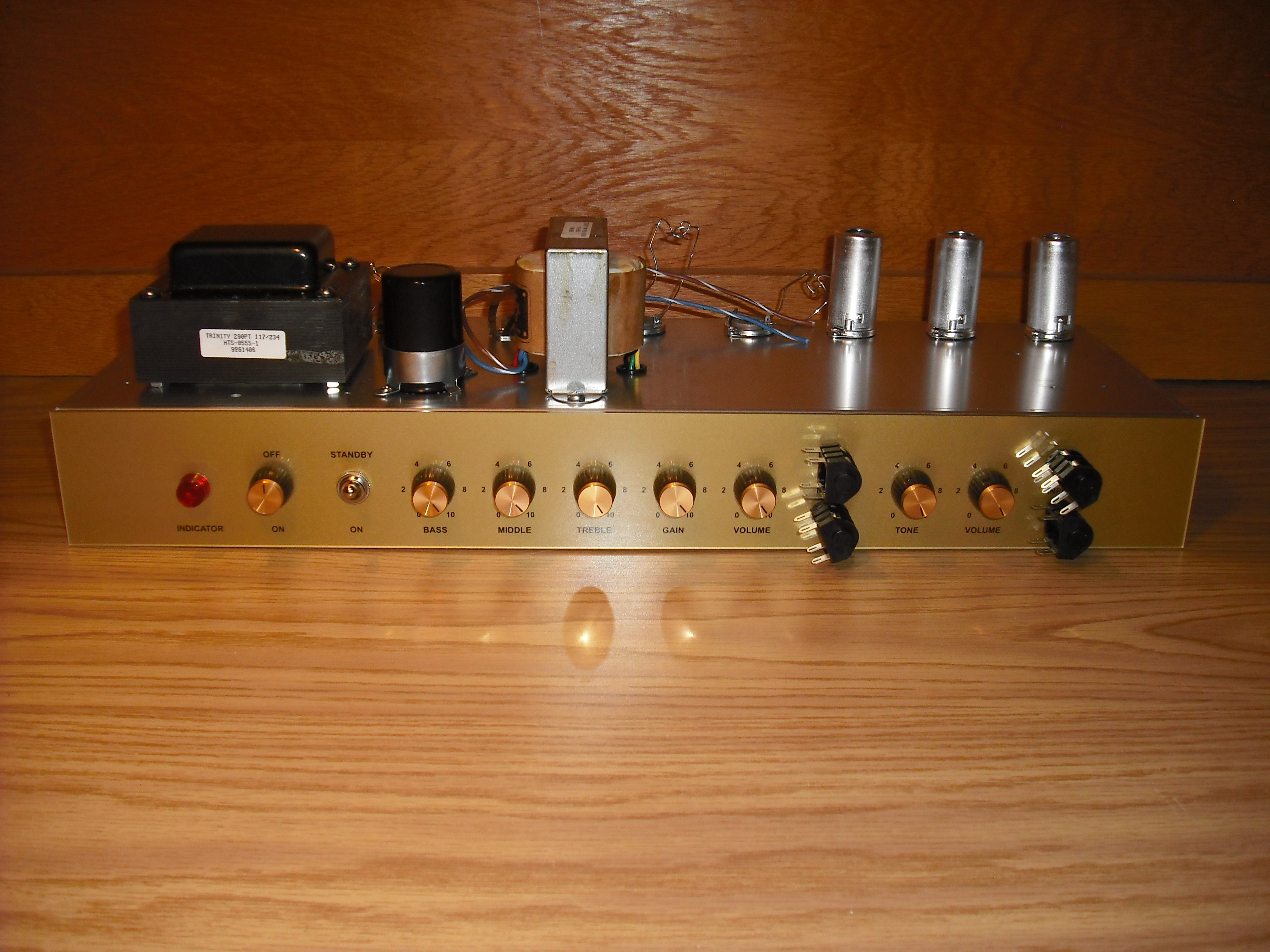

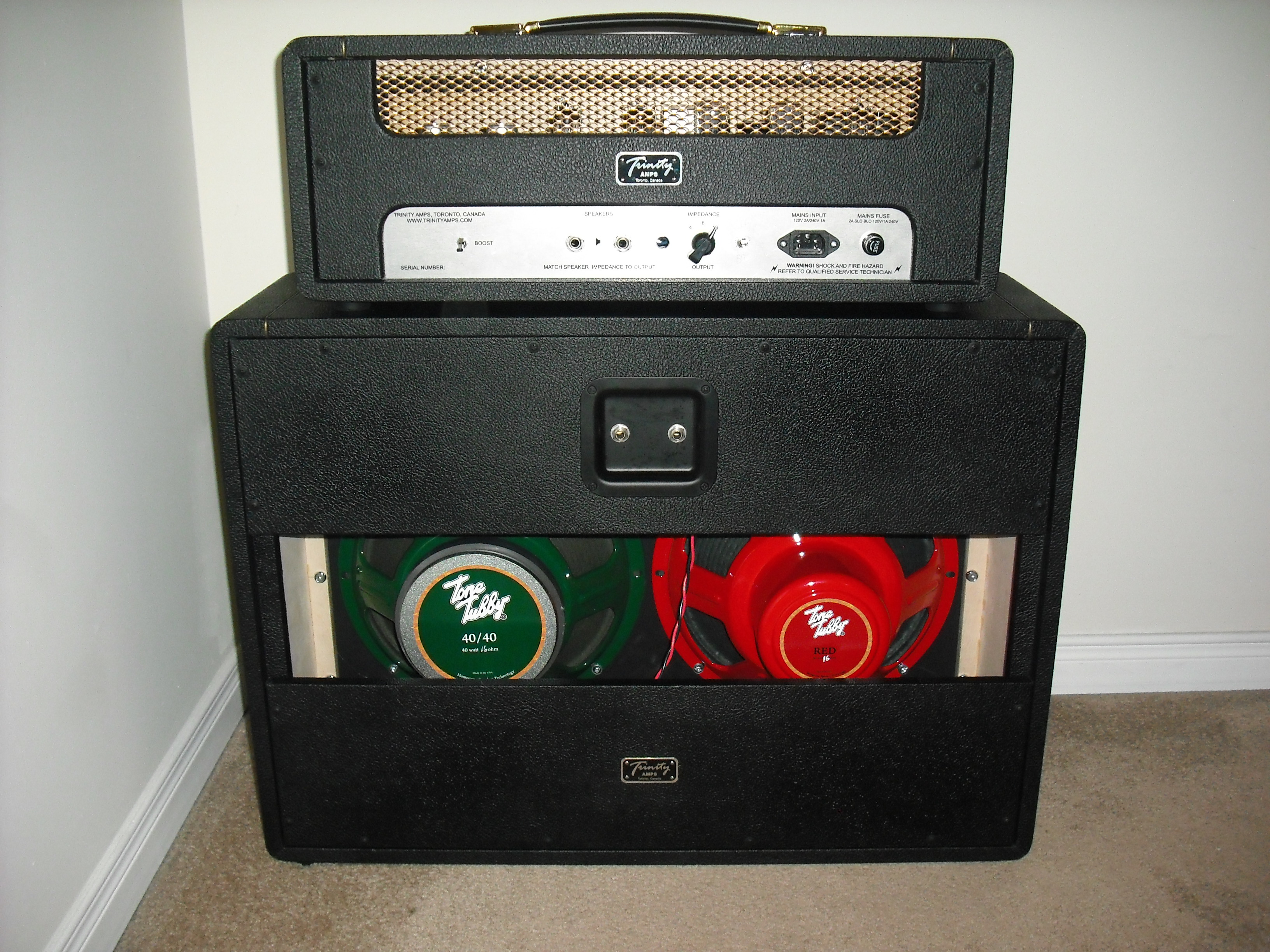

Head and Cabinet.
Back of the Head and Cabinet.
