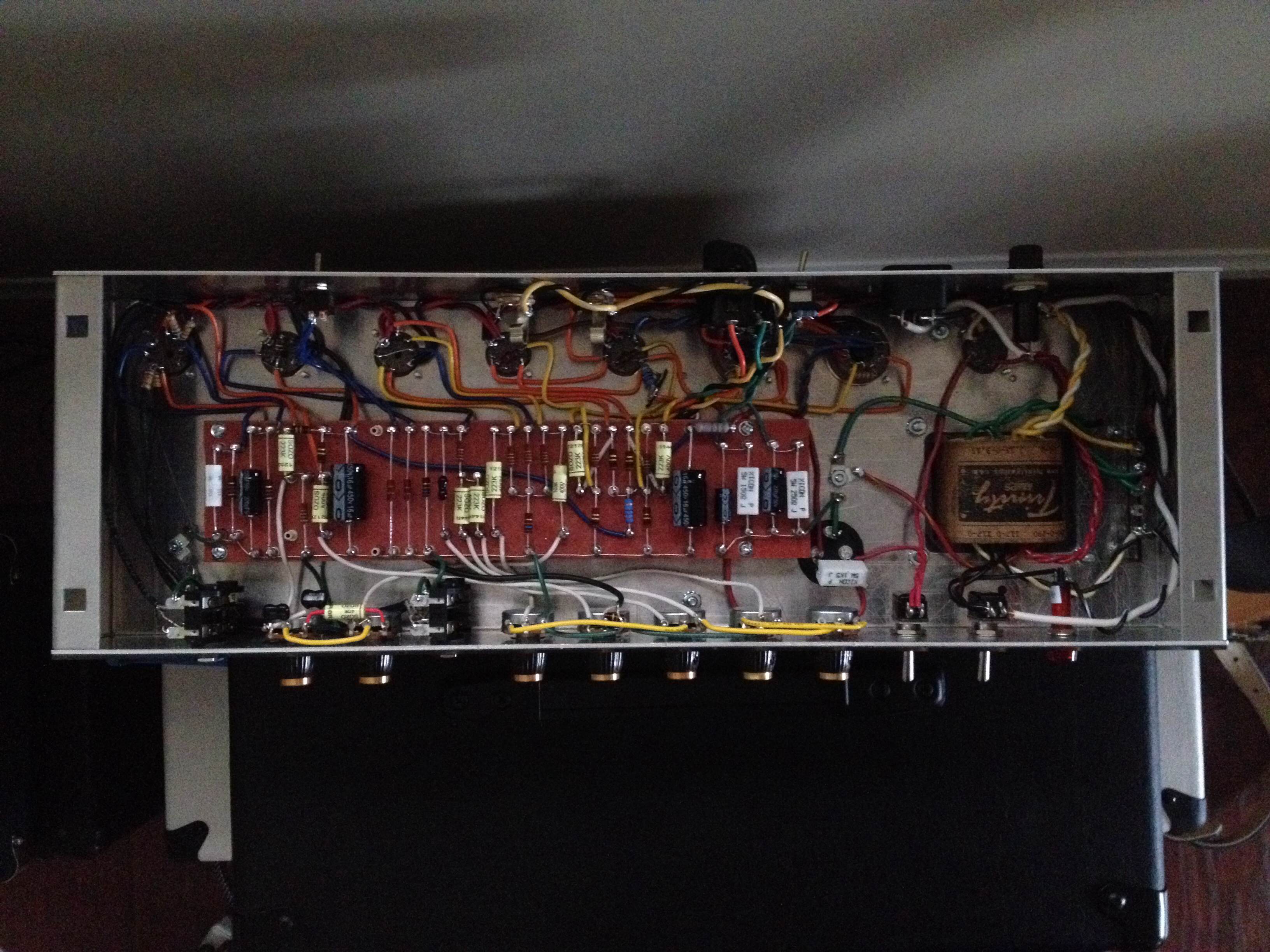

So my wife was out of town for the weekend, and is gone all week this week. So I decided to do some work on the amp. Saturday morning when I started I already had the heaters wired, and the transformers mounted, along with all the hardware mounted, and ready to go. I started with the board Saturday morning, and finished the amp completely by about 3:00 in the afternoon Sunday!!! That was a lot of soldering!!!
The 6V6 side worked perfect, but I forgot a jumper to get the EL84s working. Once I installed those jumpers, everything works perfect, and it is nice, and quiet!!!! I have to say that this amp has balls!!!! It is a very gutsy aggressive sound with the gain cranked, and it is killer with a boost :evil: I am thinking I will be making some clips this week since there are no real hard rock clips for these amps that I can find.

I just finished doing a bunch of tweaking, and I almost have the amp where I want it. So far I have changed
C2 to 1uF
R4, and R7 to 220k
Removed R8
Put a 25uF cap in parallel with R34 so the gain boost adds bass
I am thinking about changing VR7 to a lower value, and I just want the bass to stay together a bit more. It almost feels like there is a bit too much sag, so I am thinking I have a spare 9H 40mADC choke. I might put that in in place of R28, but I am not sure what effect the choke will have other than raising the voltage.
What are your thoughts about using a choke in place of R28??
So far with these changes this amp can breath some fire, and when I turn the boost off it is back to being like a vintage amp!! Very cool so far.

Yes those changes will certainly heat things up a bit. A choke will tighten things up but probably increase voltage. But it will almost certainly affect the standby switch reliability as well so be careful.
PostPosted: Sun Dec 08, 2013 11:03 am
Add a 10nF or so cap across the standby switch if you add a choke (use a high kV rating for the cap).
