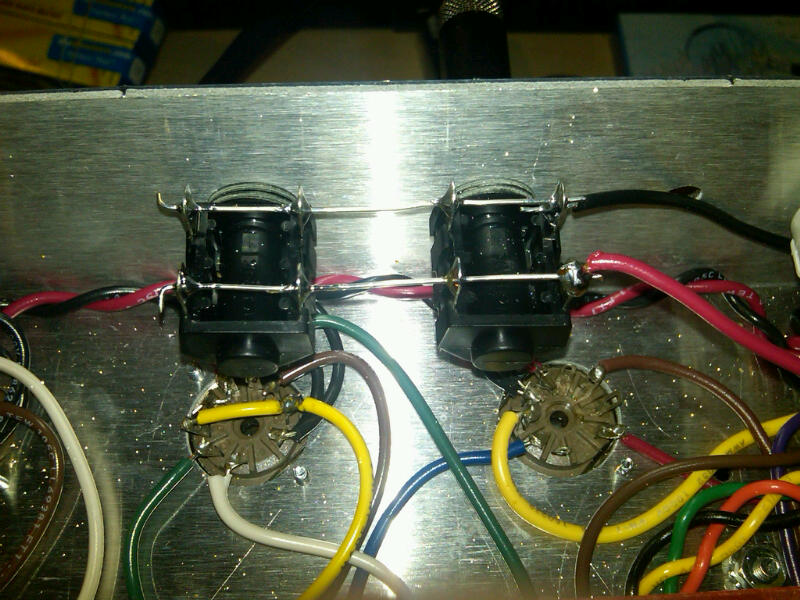

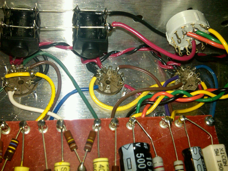

here are a couple more pics too...

You your DMM's continuity function to check the jumpers.
Are all the ground connections on the pots actually grounded?
What's happening with that brown wire on the bass pot, looks like it's touching the pots case.

Your input jacks are reversed from the layout. Can you check your input jack wiring please. The 1M resistor goes on the jack closest to the chassis, so I'm thinking, you may have made some wiring errors in this area.
download/file.php?id=463&mode=view
See pic at:
download/file.php?id=442&mode=view
Also, the coax shield can melt the inner conductors insulation if you are not careful and use too much heat.

awesomesauce....so....I redid the input wiring and bingo bango....we've got lift off...didn't have much time to play with it today...but so far...me likely!

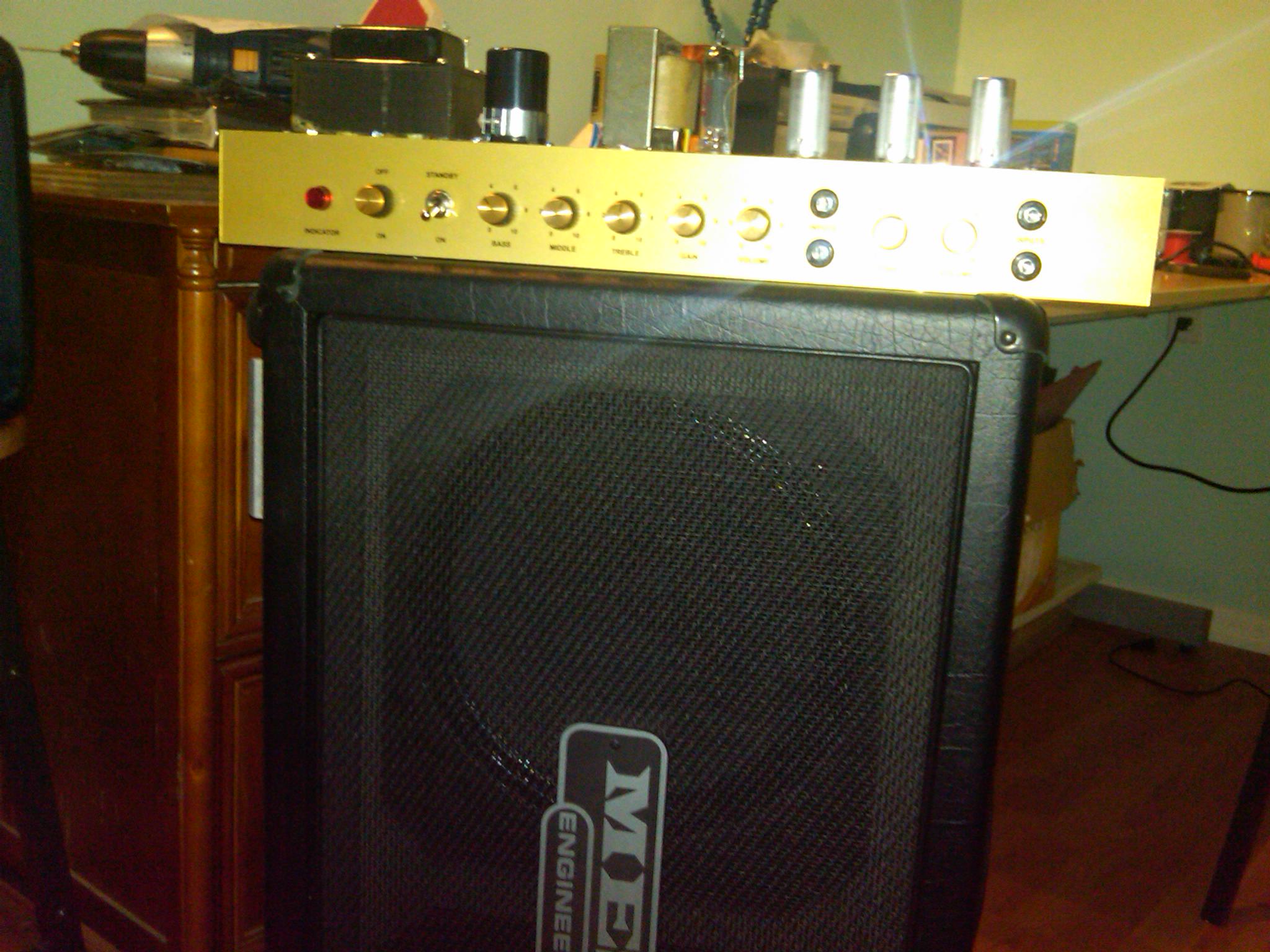

soon as i get the shell for it...i'll post a finished pic...but here it is so far...

all done...many thanks to all of you!
finished it last night by installing a bleed resistor and doing the cascade mod...
 Post subject: Re: a Plexi journey
PostPosted: Mon Feb 25, 2013 9:04 pm
Looks good. Where did the head cab come from?
PostPosted: Mon Feb 25, 2013 10:39 pm
Nice logo too!
PostPosted: Tue Feb 26, 2013 2:50 pm
Posts: 138
Stephen made it for me...i did the logo...its my personal logo i guess!
