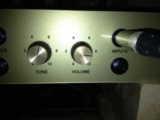

Process sm57 -stein berg c12- garage band with uniminds EQish and a bit of track verb and echo
Picture shows knobs and at about 3:10 in the clip i moved the input from low gain to high gain
After listening back I rushed some of the cuts and played a little sloppy sorry :oops:

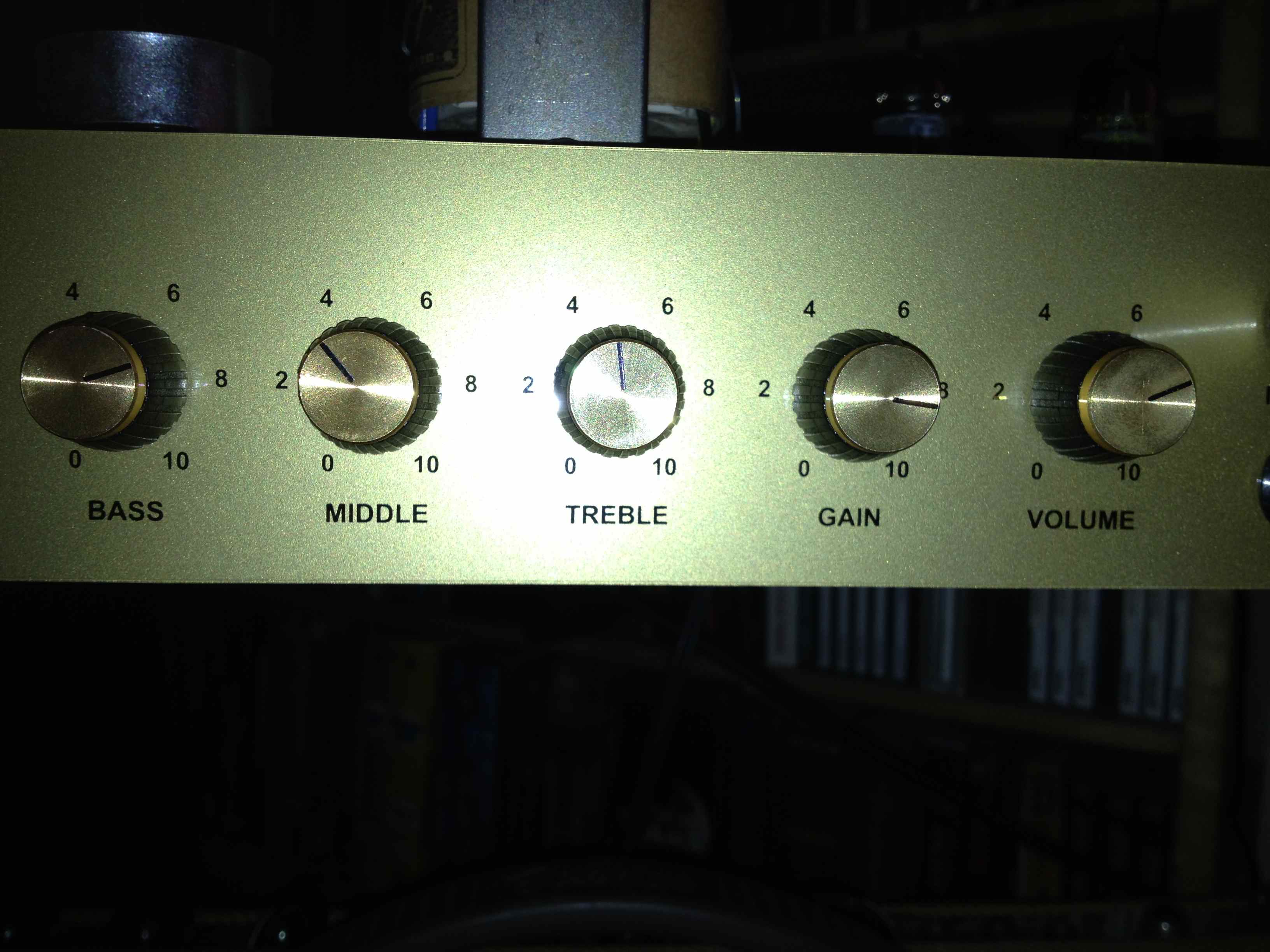

This is what i'm getting out of the tmb side (still a little bassy have not mastered the sm57 thing. I was not getting this much gain when i first modded it.
