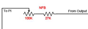

I have actually been thinking about adding a variable negative feedback control so that I can dial the amp from soft to stiff.
There is a video by Pete Thorn demoing his amp that has this type of variable negative feedback control. Check it out here. http://www.youtube.com/watch?v=QGErfbbJ ... age#t=200s
Les
