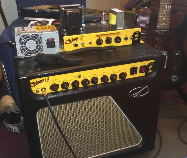

I had my brother-in-law's dead Epi Valve Standard on the bone pile (swapped him for some guitar mods), so I gutted it & started over. It already had Merc trannys so I didn't really need much other than a turret board, cap cans, better tubes, & a VRM. It has a Celestion Vintage 30 in it at the moment, but it's a bit harsh. I have an extension cab with a G12K that sounds MUCH better.
BTW- Perched on top is the much-evolved single-ended amp you & Z helped me with quite a while back

Nice attenuator you have there. :)
