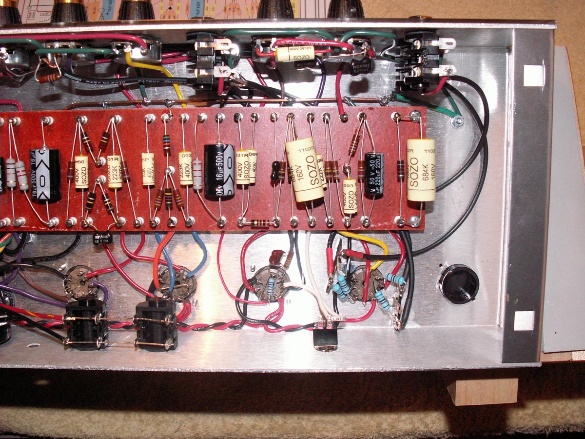

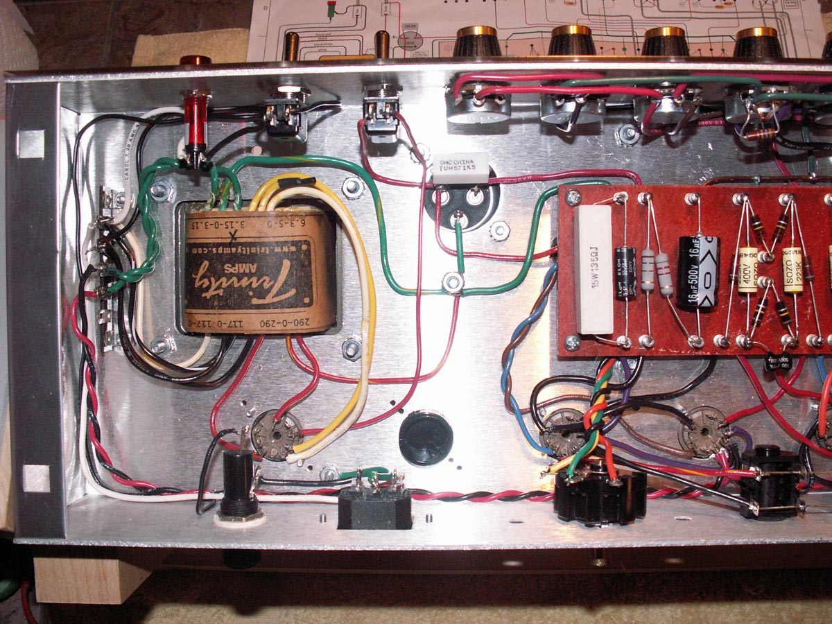

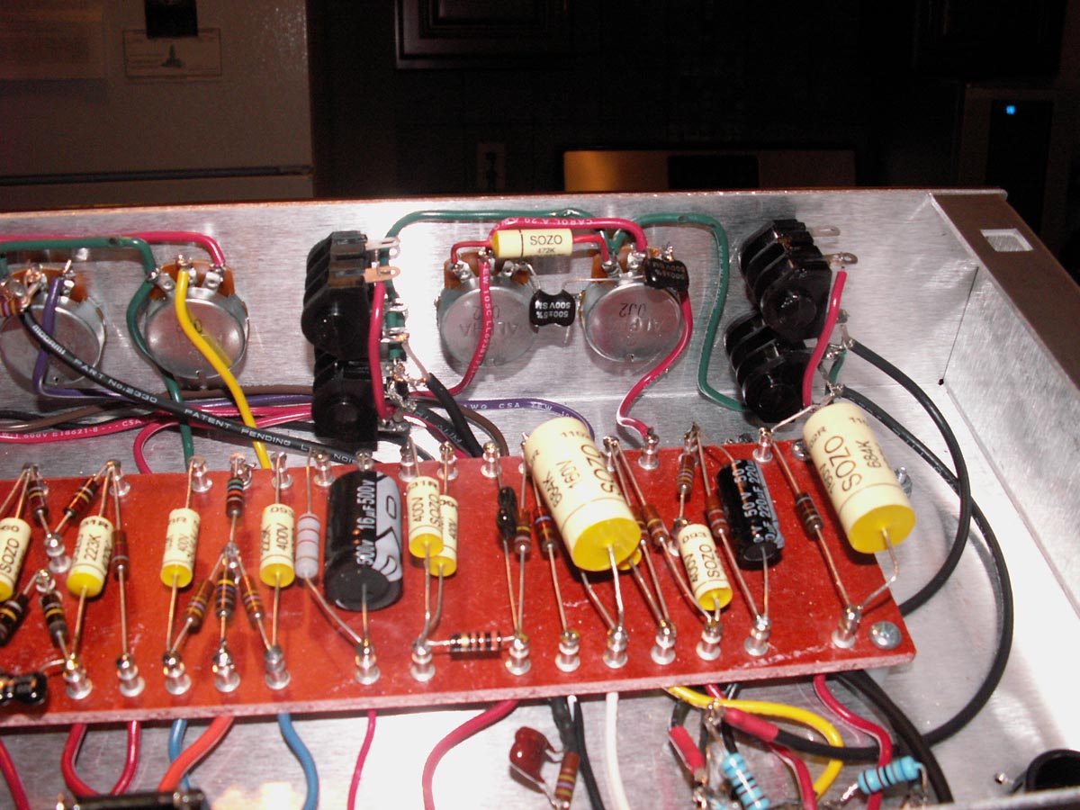

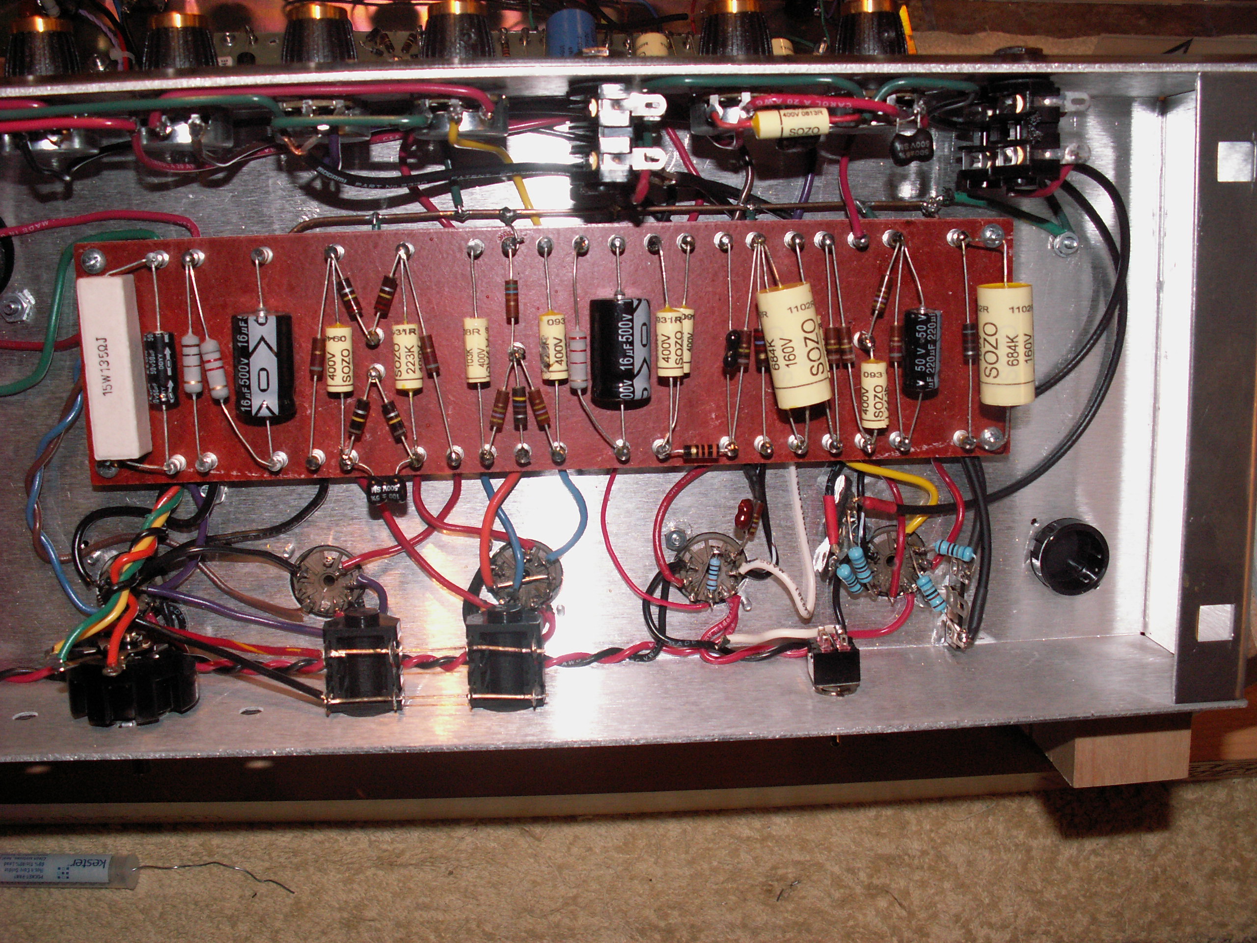

I finished my Trinity Plexi build this evening (Plexi brown layout with no cascade). Was stoked that voltages etc. were in spec and it booted up with no major issues first try. Normal channel sounds great
But alas, it appears I have an issue with the TMB channel ... volume is quite low, sounds OK (good tone but very little gain). Tone pots seem to work OK. Completely dimed it is still clean, barely clipping and not nearly as loud as normal channel. Boost switch works but boosts the clean to louder semi-clean and still not nearly as loud as it should be. Its like I am missing a gain stage
Any suggestions what I should be looking at? - I've spent a couple hours now trying to figure it out but can't seem to figure it out. I've gone over the layout a few times, and have re-soldered a lot of connections - I could use some suggestions or fresh eyes - a few pics attached
Perhaps one of the more experienced builders can help walk me through likely issues or how they would diagnose something like this.

I had a similar problem.. double check your wiring on the gain pot.. if you like you can remove resistor R8 and try it. My TMB channel is still not as loud as the normal channel, so mine isn't 100% yet. You should also triple check all your soldering... also try swapping the 12aX7 tubes around, and the power tubes... and I also understand that voltages are critical, so measure them all.

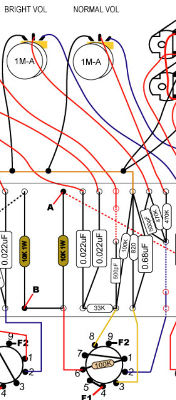

so after a ton of checking values, rechecking connections, re-soldering etc I found that by removing the 470k resistor across the 1 + 2 lugs on the gain pot that I all of the sudden I had some decent gain
Is there supposed to be BOTH the 470k resistor on the V2 tube grid pin AND the 470k on the pot as per the Plexi Brown layout? The regular plexi layout only has a 100k on the pot which got me thinking maybe there should not be 2 resistors, so I removed one pin of the resistor on the pot to test if that would help my gain issue and it sure does.
any comments would be appreciated
PostPosted: Sat Aug 27, 2011 11:29 pm
Posts: 226
Location: Dallas, Tx
There should be two resistors but after looking again, the layout is wrong. The way the layout has the 470K on the pot before the signal goes to pin 2 is creating a voltage divider with the 470k resistor on pin 2 which will reduce the signal considerably. The Schematic is correct where the second 470k should come after the inline 470k with the cap across it. It should go from pin 2 to ground.

b0b0, R24 in your layout is still creating a voltage divider. It needs to connect from pin 2 to ground.
Like this:
This is the area we are looking at (green circle):
Les

PostPosted: Mon Aug 29, 2011 9:45 pm
Updated the layout to fix this error.
