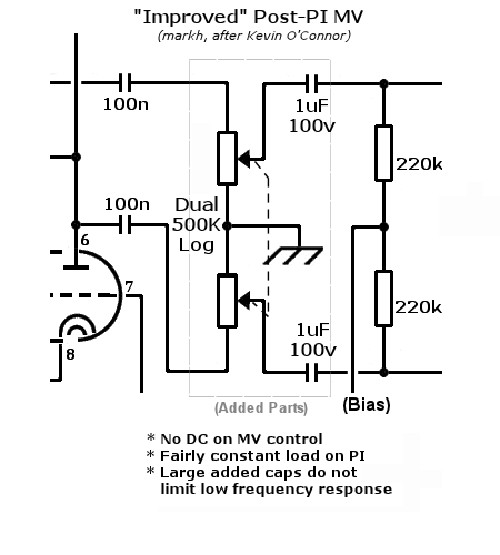

I have also ordered parts for a PPIMV too just to see if I can also dial out the buzz as Unimind did.
If you are interested, here is the PPIMV I implemented except I use a 1M dual pot.

Posts: 78
Thanks for the link - I already ordered a pot etc and have a few examples of Lar/mar and other PPIMV types that I bookmarked as well so I am confident I can hook it up.
what do you think about the Ruby mod or the link I posted from GP mag? Both seem possibly relevant to the issue we are having. In my case I just am a little too green to figure out the particular resistors and diodes necessary to hook a Ruby mod up hence my request for help. The guitar player article is pretty simplified and even I could do that and may try hooking it up just to see how it sounds and what it does
You have more electronics knowledge than I .. maybe try hooking one or both of them up to see if they help (or help me with a layman's Ruby mod parts list and idiot proof layout so I can try it - ha ha)
What lead me to that instead of the Larmar is that it is DC isolated.
