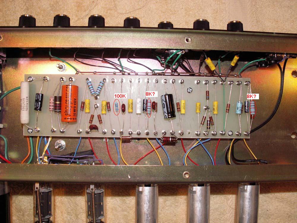

You had said that some of the components are different types than what I had in my amp. Can you post what and where they are (i.e. V1a plate - 100k carbon comp 1/2 watt)? Could you also post some gut shots of the board? I don't know if guys are reluctant to help because it is not a Trinity amp but I can try to help if I can since you have converted it the 'Brown' layout.

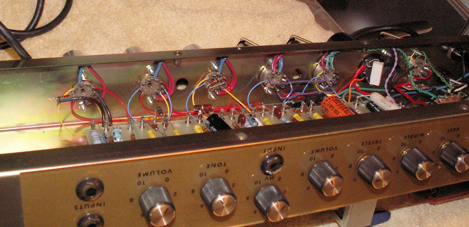

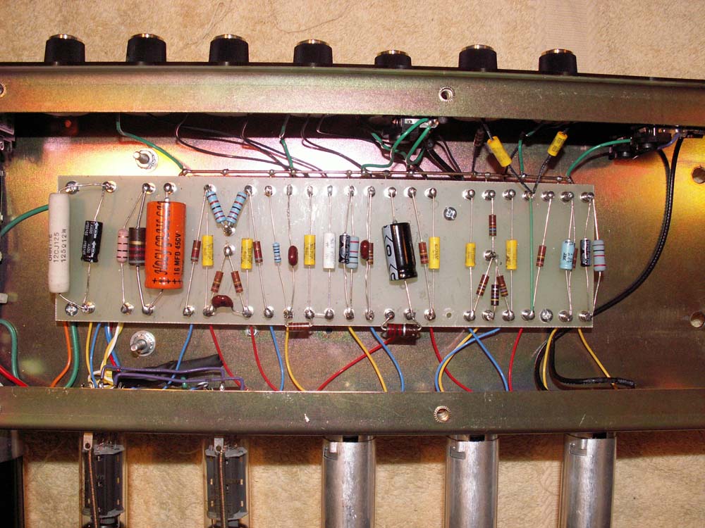

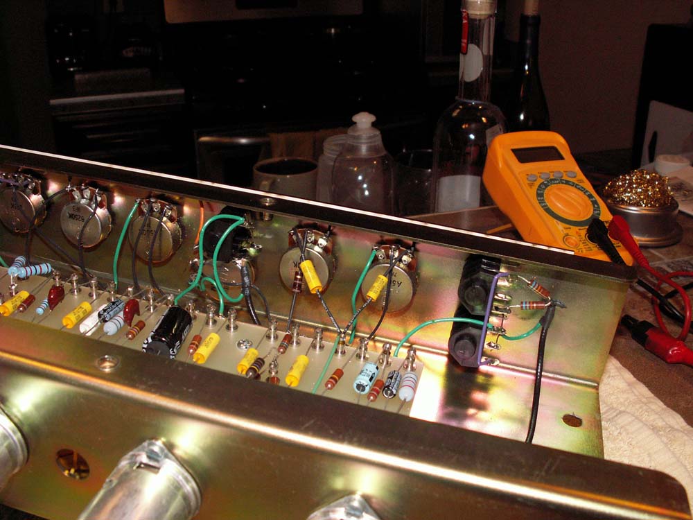

Pics below - I did mention in my first post in the Brown Plexi thread that I was not trying to freeload on the forum and had ordered an 18 watt head kit from Trinity a couple weeks back - I have not got it yet as they were waiting on some Transformers, but none the less I thought that should earn me the right to ask a few questions here without breaking any forum etiquette.
As a first time builder that has not really messed much with electronics, I thought an 18 watt would be a good first project and Trinity's kits looked suitable for a rookie with the forum, manual etc. I actually bought the Ceria-tone chassis off Ebay so I would have a working 18 watt in front of me during my first build. The layout is a little different than Trinity's but I thought it would be good to have something right in front of me that I could really study.
After following your thread I got a little impatient and started messing with it in the mean time - Its been good experience .
3 pics below - board view, pots view and tube socket view - since it is a combo chassis its a little harder to see components from just the top view -
Also the Ceria-tone layout swaps the position of V2 and V3 on the Chassis so it will look a little confusing vs Trinity
I have already tried swapping a few resistors so you will see some metal film and metal oxide in a few places where there was carbon comp. Still hissy as hell - I'm curious if you think the non shielded wire from V2 I mention above would be an issue - does shielding quiet hiss and white noise or just hum (or both)?

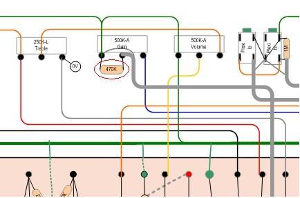

I see a few things that we can try.
First is the grid leak to V2a. This is the 470k resistor on the TMB ch gain pot in the picture below. This will reduce the gain a little going into V2. This is in addition to the mix resistor that you have on the board already.

Next is the V2b cathode resistor marked 100k in the next pic. This will also reduce gain a bit. I am not sure what you have in there now. It looks like you have gray,blue,blue which would be 86Mohm which can't be right. In any case you want it to be 100k (brown,black,yellow).
Also in that last pic I circled 2 resistors. Are those gray,black,red 8k? Or are they brown,black,red 1k? They should be 820R gray,red,brown. If you have 1k there it should be ok but I am not sure what 8k would do.

the 2 resistors that should be 820r are 1k - I was just trying the 1k resistors I happened to have at the house in a few places to see if they would quiet it down vs the 1/2 watt carbon comp. I have ordered a variety of other types at the correct values that I will try in a few days when they arrive. My thought is I might try and quiet it down then get back to the tone quest
The 100k you marked is 100k - double checked it - perhaps the colors look off on the picture
Ironically I had just pulled the 470k grid leak resistor to see if it might be a noise culprit
