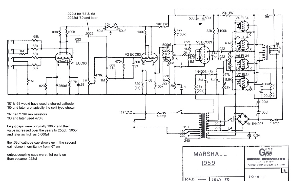

My goal was to take the 1959 Plexi schematic (http://www.unimind.us/images/1959_Plexi_Schematic.jpg) and apply it to an 18 watt amp. Trinity Amps 18 watt Plexi schematic was pretty close already so only minor changes were needed. And then I would throw a little "Brown" tweaks in there for good measure.
Some of these changes are similar to the sIII version so you may want to start with those changes first and see if you like them. viewtopic.php?f=12&t=689

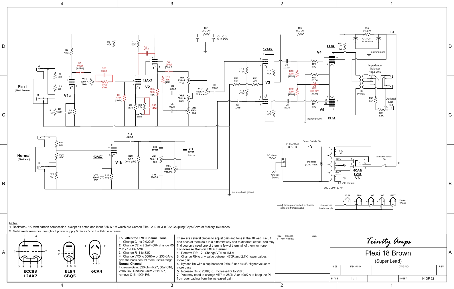

Here is the Plexi Brown schematic I put together. (Edit: Removed link. Please see coco's final version later in this thread.)
Experts.. Please chime in and correct me on any of this information.
Starting with C1 - V1a coupling cap. Lowering the value to .0022uF reduces the bass going to the next stage.
Added the V1a mix resistor (or V2a grid stopper) R42 (470K) which reduces gain to V2a.
The mix resistor bypass capacitor C20 will allow certain frequencies to pass. The 1959 value is 500pF(mica). The "Brown" value is 330pF(mica) (less bass).
Changed R8 to 470K. This the normal channel mix resistor in the 1959 circuit and acts as a grid leak to V2a. Also reduces gain to V2a.
Added C21 - V2a cathode bypass capacitor. .68uF reduces the bass and increases gain in V2a.
Increased V2b cathode resistor to 100K reduces gain.
Changed R11 tone stack slope resistor to 33k. Shifts the tone stack frequencies to upper mids.
Changed treble capacitor to 250pF. Another "Brown" value. Increases treble frequencies (or in reality, lowers the bass frequencies).
Check the value of R15. The Plexi value is 470R if you do not have the Plexi version you will need to change this. Lowering this value increases gain in the phase inverter.
Changed C10 - V4/V5 cathode bypass capacitor to 50uF 50V. This lowers the bass in the power tubes.
R18 and R19 - V4/V5 grid leaks. I lowered these to 220k because with fixed bias (which I am using) the maximum value is 330K for EL84s. I chose the 220K because it matched the 1959 circuit. Lower values I believe increase gain. It may shorten the life of the EL84s. Need the experts to chime in on this one.
R30 and R31 - V4/V5 grid stoppers. Again the 1959 circuit has 5.6K there which should increase gain. It may shorten the life of the EL84s. Need the experts for this one as well.
One more tweak that I am thinking of doing is to reduce R9 - V2a cathode resistor and R34 - boost resistor to 1.8K. This will then be 900R when the boost switch is on which closely matches the 1959 circuit value of 820R-1K. This will increase the gain of V2a slightly more.
You may want to add the "Bright Cap" to VR1 volume pot. The 1959 circuit has 500pF for the value. This will allow certain frequencies to pass as the volume pot is reduced. I left it out as most people do because when you have the volume at 10 it does nothing.
So there you have it. The 18 watt Plexi Brown mods. That should get you pretty close to the "Brown" sound. The rest is the guitar, the player, the speakers, the mic, the recording console, the engineer etc. etc. etc. :roll:
I hope this is of value to some of you and again all you experts please correct any of this information as I am definitely not an expert. I have only been learning this stuff over the last 8-12 months and have only built one amp. :bugeye:

Here are some comments:
Check the value of R15. The Plexi value is 470K if you do not have the Plexi version you will need to change this. Lowering this value increases gain in the phase inverter.
- Changing V2b's cathode resistor has no effect on gain at all. It will just subtly alter how it clips.
- R15 should be 470 ohms, not 470k :)
- Changing the slope resistor R11 to 33k increases mids, and reduces scoop. I also recommend reducing the Mid cap C4 in the tone stack to 0.01uF to give a more useful sweep range on the Bass control.
- Lower values for R18 & 19 decreases drive to the power tubes and overall gain. You will get quite a bit less power amp distortion. It has zero effect on tube lifetime.
- Reducing grid blocking resistors R30 & R31 has zero effect on gain and will just make the amp a little brighter, which IMO isn't needed. Personally I would leave them the way they are. The EL84 design guides actually recommend 10k as the minimum value. I've actually been thinking about trying larger values, like 22k, to smooth the distortion a little more.
- Alternatively increasing C10 to 1000uF or above also tightens bass, and stiffens the feel of the amp at the same time, more like a fixed-bias big Marshall. You said something about also having fixed-bias in your amp, but I can't see it anywhere. With the huge cap, you might want to cool the bias a bit, by increasing cathode resistor R20 to 180 ohms.
- Reducing V2a's cathode resistor only affects gain when the bypass cap isn't there - ie when boost is off.
- The Plexi bright cap gets snipped off by a lot of people, so I suspect it may not be real popular here either...

zaphod, thanks for your comments. As I said I am no expert and don't fully understand all of this. This all comes from my thinking why not build the 1959 plexi circuit with el84s in the power section.
That is correct. I will edit my post and correct that.
This is good to know. I chose those values only because that is what the 1959 circuit has with fixed bias.
I left out the fixed-bias here because this was mainly for those that do not have fixed bias and just want to try these mods in their circuit. I also left out the negative feedback loop which I also think helps smooth out the power section. Along with the NFB I also have a 100pF mica (another Brown value) across the PI plates. I read that this tames some of the high end fizz. The 1959 circuit value is 47pF.

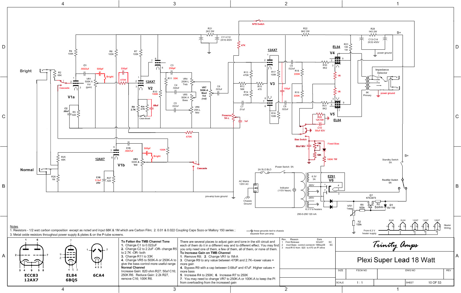

Here is the schematic for my amp. http://www.unimind.us/images/Trinity18_ ... ematic.jpg
Are there other changes I need to make to the PI? Should I be using the 10k tail and 1M grid leaks from the 1959 circuit as well? I thought they mainly controlled the impendence and since I don't really understand all that yet I thought it best leave that the way it is. :?
The NFB works well as I have it. Takes the harsh edge off the top end. Lowers output a little.
-Les
Les

Yes, the way you're applying the NFB to the PI tail means it's having very little actual effect apart from removing a little fizziness. However, that seems to be a worthwhile improvement. In a true 1959 or 1987, the two preamp channels are mixed at the second preamp stage and the NFB is then applied tp the "B" input of the PI, which has a much more massive effect. In the case of your 18W, that would tend to make the amp feel less lively.
You absolutely don't want a 10k tail resistor in the PI, as your EL84s will start to crap out with the excessive drive from the PI. The 15k (10k+5k pot) tail resistor value is meant for driving much lower gain octal power tubes. I would however say that the regular value for a Marshall 18W or Vox/Matchless tail resistor is 47k. What you have right now is effectively 56k+5k = 61k, so you aren't really providing much drive to the EL84s, and even more so given the low value 220k grid reference resistors. So I would suggest changing your fixed tail resistor to something in the 9k to 47k range to allow the EL84s to work a little more. The 1M or 470k reference resistors make on the PI make virtually no difference either way.

You should see in my schematic that I do mix the channels at the second stage and the NFB does connect to the tail and second PI input.
Thanks for this. I have been trying to research this but there is very little information on NFB in 18 watt designs. There are a few schematics over at 18watt dot com but little information as to how they came up with the values. I think I just usally see 47k on the tail. I had picked up resistors of various values to try there (47K, 33K, 22K and 15K) but I wanted to understand a little more what I was doing so I didn't blow something up. The other reason I left it alone was I have the NFB on a switch and didn't want things out of wack when the NFB is switched off.

I think this captured most of unimind changes. Added the 50pf PI plate cap, left the 8.2K grid stoppers and lefft the normal channel as per plexi lead (220uf/820R).
Can you guys take a look?
see follow-up schematic

Here it is with the posted brown circuit above (+100pf on PI plates), without the attenuator, EZ81, cathode bias, NO NFB, Boost ON, Bright ON, cascade OFF, Bright channel dimed.
http://www.unimind.us/DimedBright1.mp3
It's an excellent demo clip and listening to it thru small speakers it sounds very good, I bet it's pretty realistic thru your rig.
That was based on which schematic yours or mine but with (100pf on PI plates?
Nice chops too!!
 Post subject: Re: Plexi Brown Mods
PostPosted: Thu Mar 10, 2011 5:45 pm
Posts: 226
Location: Dallas, Tx
I think on that last clip you can hear a thickness to the bottom end that wasn't there on the other clips. Must be the speakers pushing air. 8)
Based on my original. I also made this one last night. (Edit: Removed link. Please see coco's final version later in this thread.) The 100pf is across the PI plates. You have a 47pf across V2 plates in your schematic.
Nice chops too!!
Thanks. It was so loud it was making me nervous. I haven't played an amp that loud in over 15 years. :bugeye:
-Les
