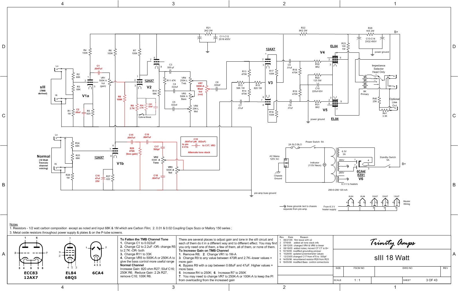

Amp is wired like this:
http://www.trinityamps.com/ForumGallery ... ematic.jpg
I've gotta read up on my zeners again.
