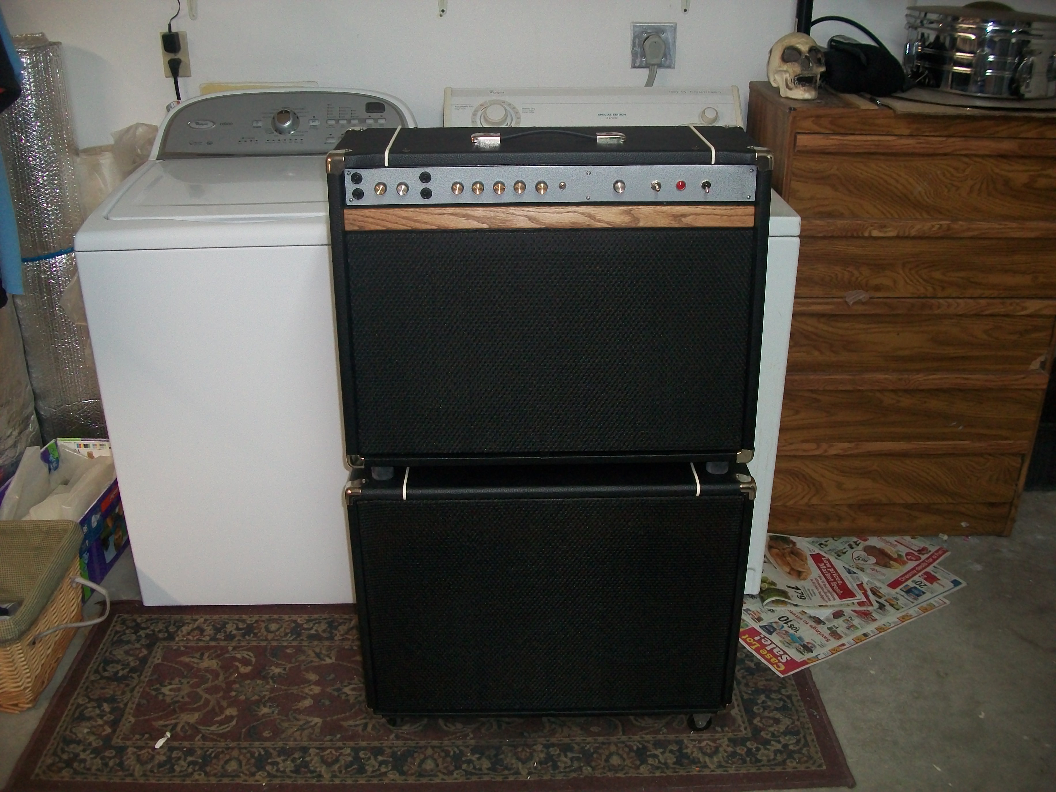

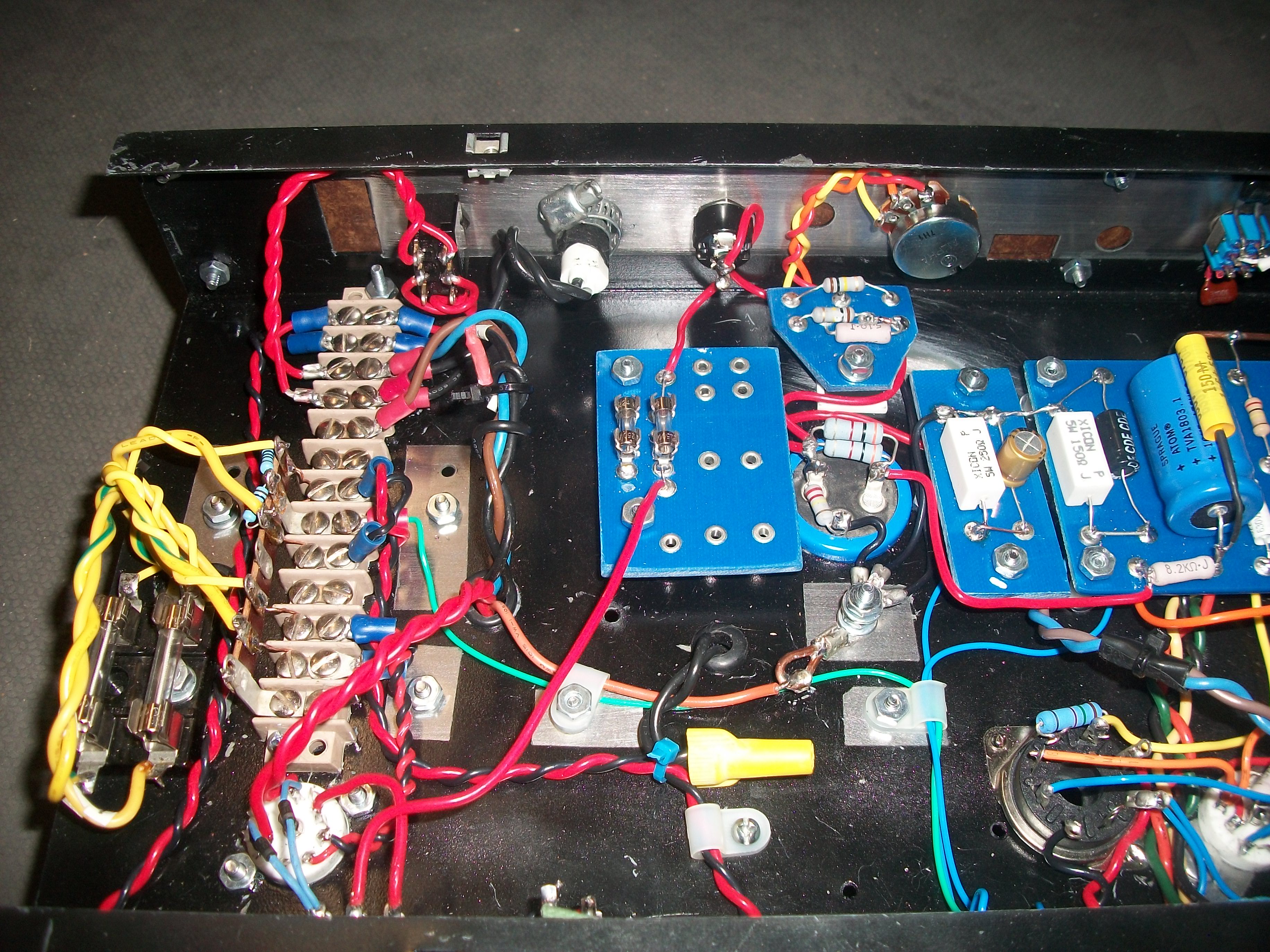

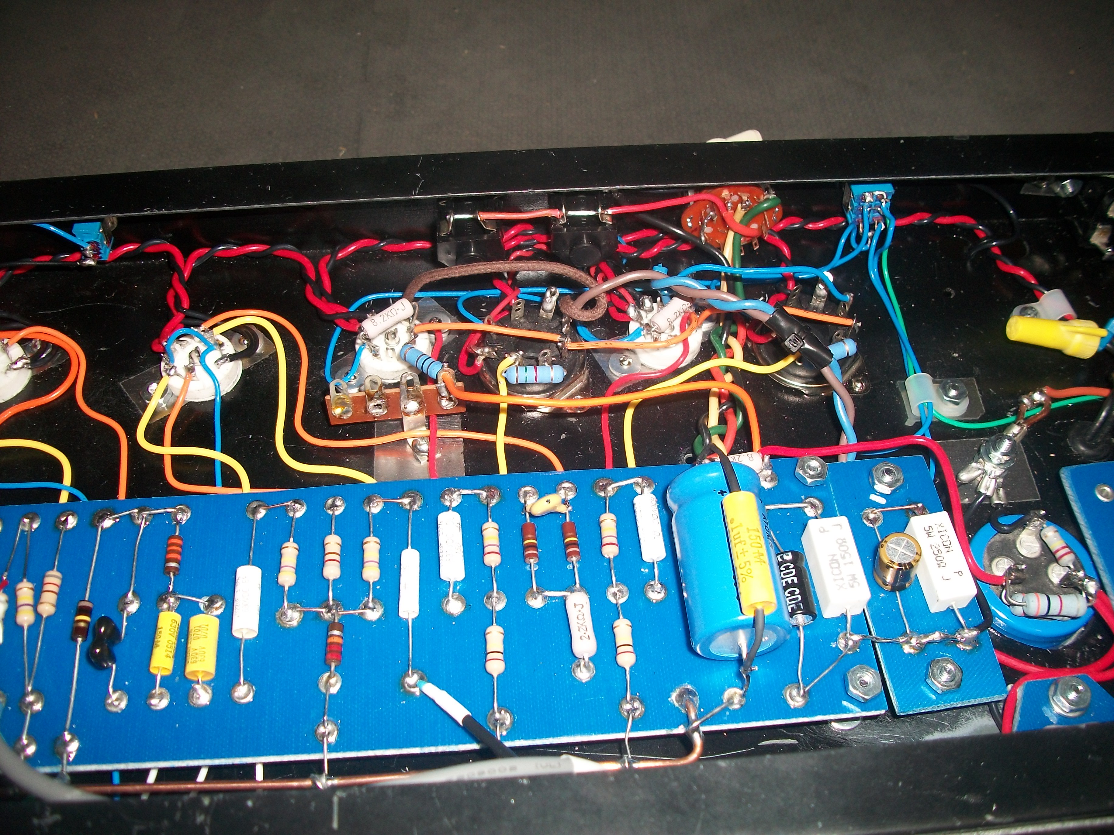

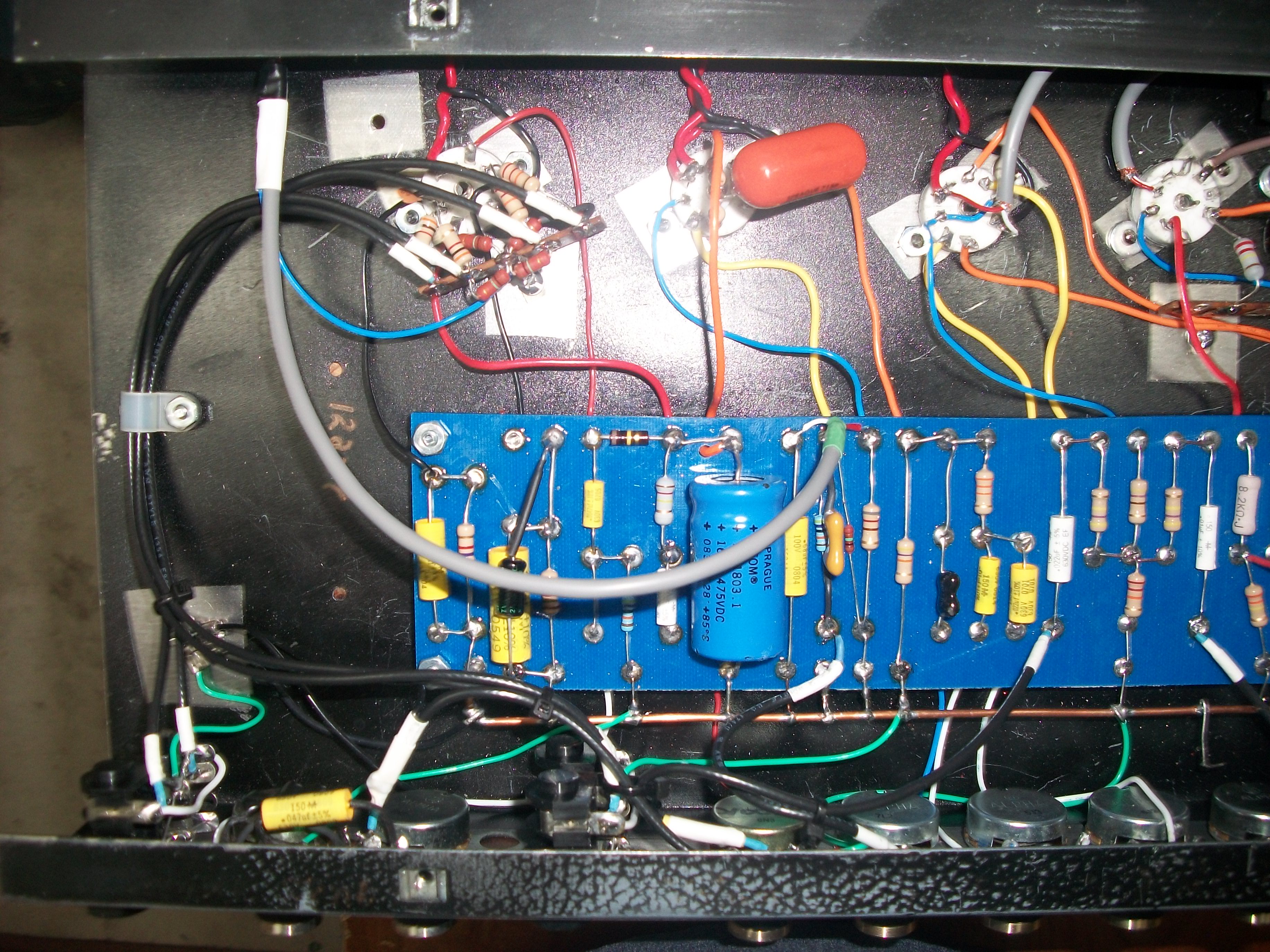

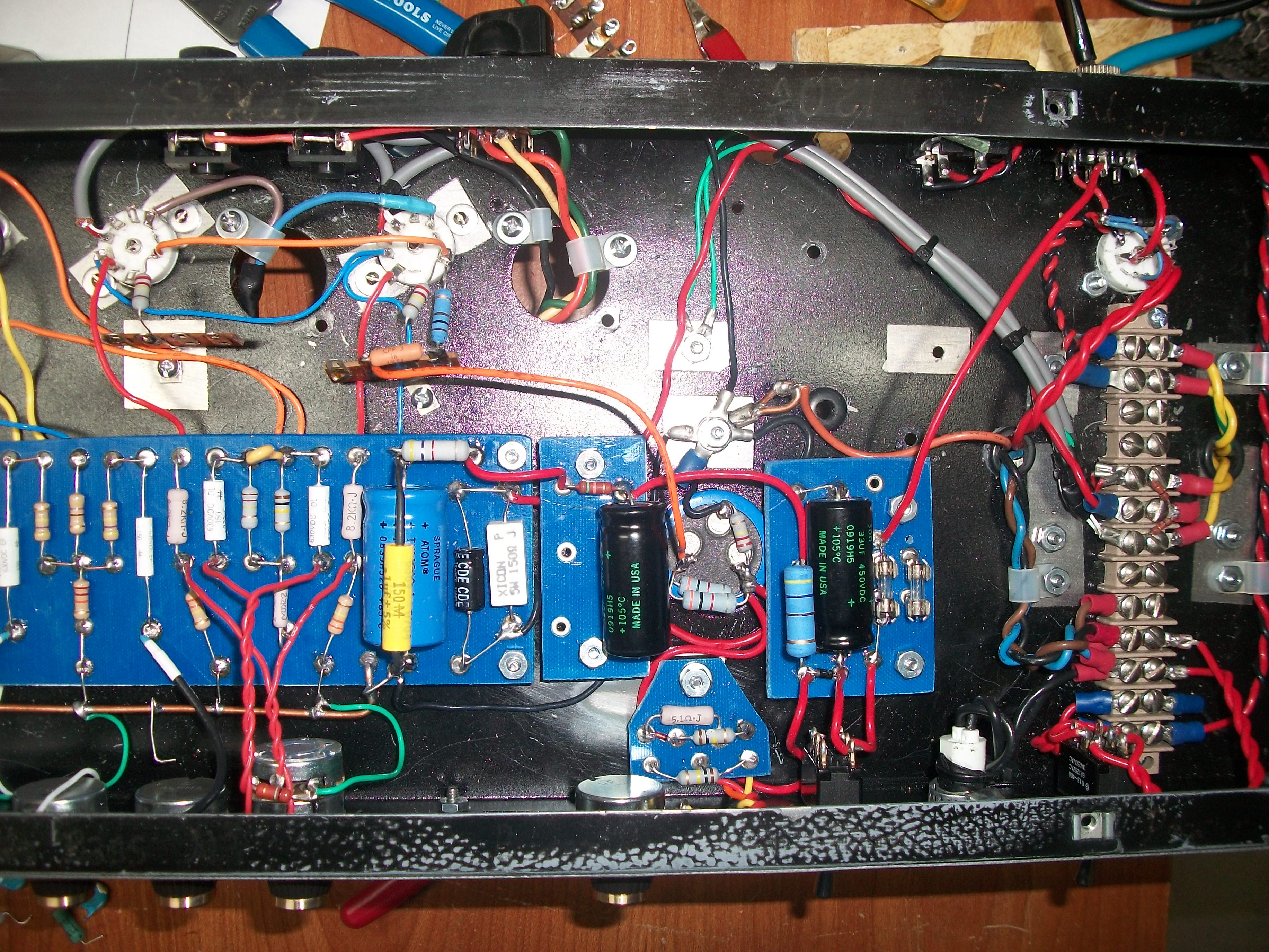

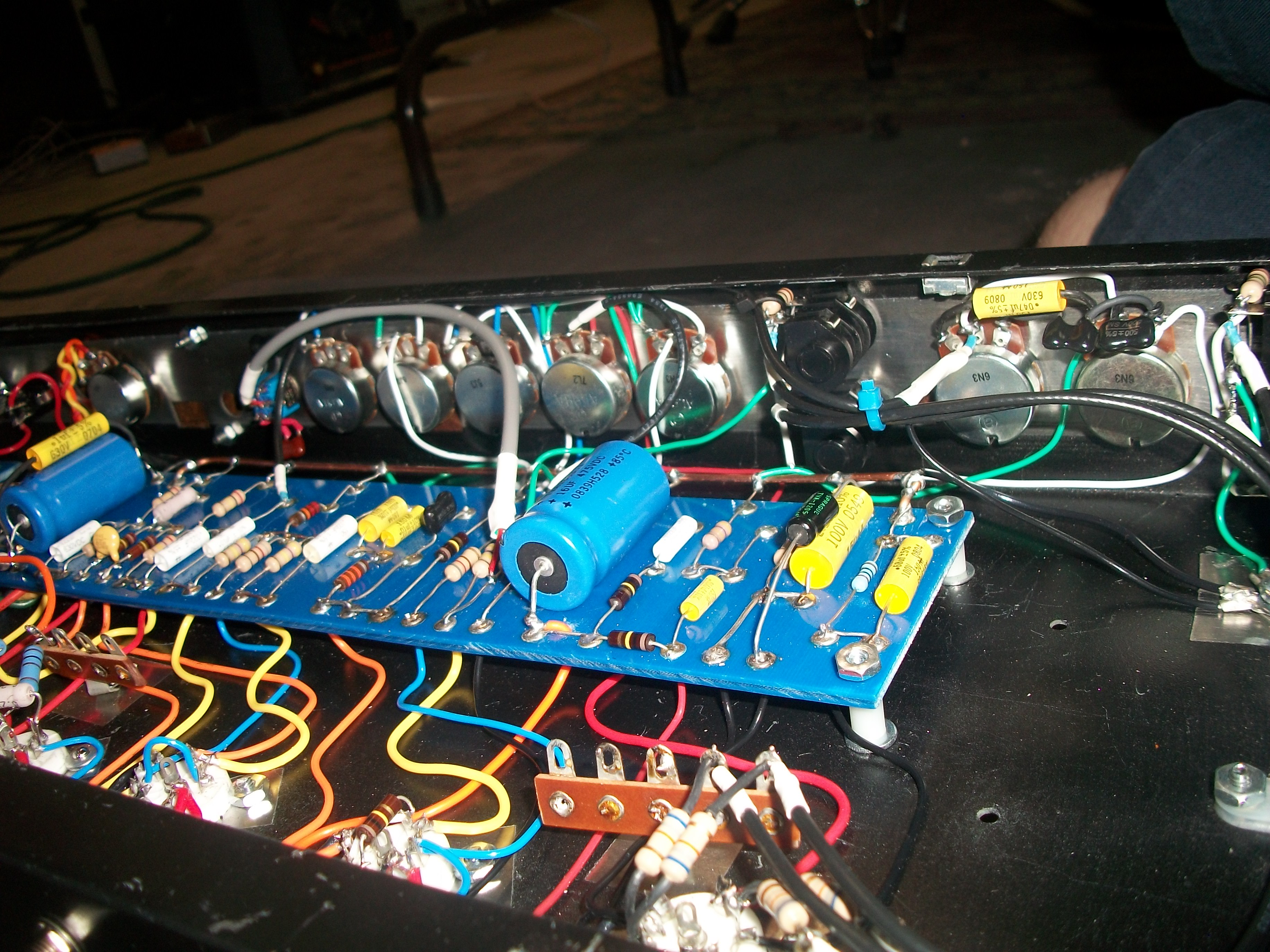

Its working,the voltages check out pretty good with 297 and 297 to rectifier 353 at plates and 333 at screens 11.4 at cathodes,so its dissipating 11.7 watts per tube.
I haven't tried 6V6's yet.
It has a little too much hum for me at full volume probably my lead dress as I don't really know what I am doing yet just following the layout.And there isn't much clearance at the back of the chassis.At idle its really quite.
But the old CR212 Crate sounds and looks way better than it did.
I don't really like the VRM at low volume,no scratchy knobs,but I only like the tone to about half way down and its still fairly loud.
Going to try rectifying the heaters unless someone has some feedback on how to improve my lead dress.
Then install the PPIMV and VRM the PA only,or should I VRM the PI and PA ?
I am going to make the bright cap permanent,as well as the boost cap and eliminate all that wiring and switches then try see how I like it.
I must say a kit would have been WAY easier,but I had these parts laying around for 4 years now and saved the old Crate amp just for this.
I really like using the A/B/Y pedal for changing channels and like jumper-ing the channels too.
This is a really great design ,the voltages are spot on with the EZ81 doing the rectifying (although I was reading 35VAC after rectification?) as well as 357.5 DC.
THANK YOU !! Coco for sharing the info and giving feedback,I know why now you get such excellent reviews online !!
EDIT: I just noticed looking at the pics my boost cap for the normal channel is installed backwards ,no wonder it had no effect :oops: Evreything else works right,I did have the VRM pot backwards and had to switch two wires :?

Removed the octal sockets for now,more room, less to trouble shoot,will probably change back to octals later on.
The hum was from poor lead when I "straightened up" the inside,this caused bad routing.
Along with the heater wires being mixed (possibly)
I ended up using 2 x 1K balance resistors and elevated the heaters to my PA cathodes.I even tried a hum balance pot and it didn't offer any improvement over the resistors.
I also used shielded biwire to the PA and up to the PI for the heaters.
Anyway its all fixed very little hum or white noise.

I love this amp !!! Thank You Coco for making the schematics and layouts available!!
I will try and get some sound clips recorded so you can hear how much gain the bootstrapped CF adds,and how good the VRM on the PA only sounds at low volumes.
Future mods in planning are adding another tube so I can have a paralleled normal channel (chime and shimmer) and a paralled 1st stage on the TMB channel (lower noise),mixing resistors,an NFB loop and a presence control.
This will mean losing the tube rectifier though,but that will allow me to re rout the HV better from the PT to the rectifier.
Still not sure on these I want to play it awhile as is first.
