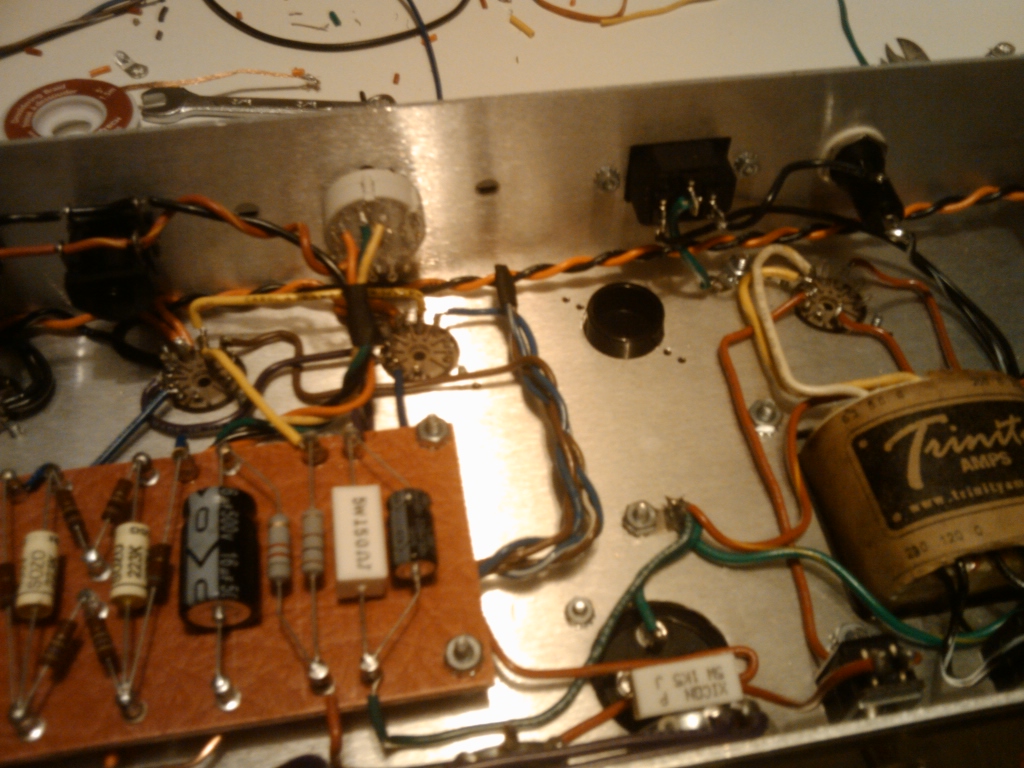

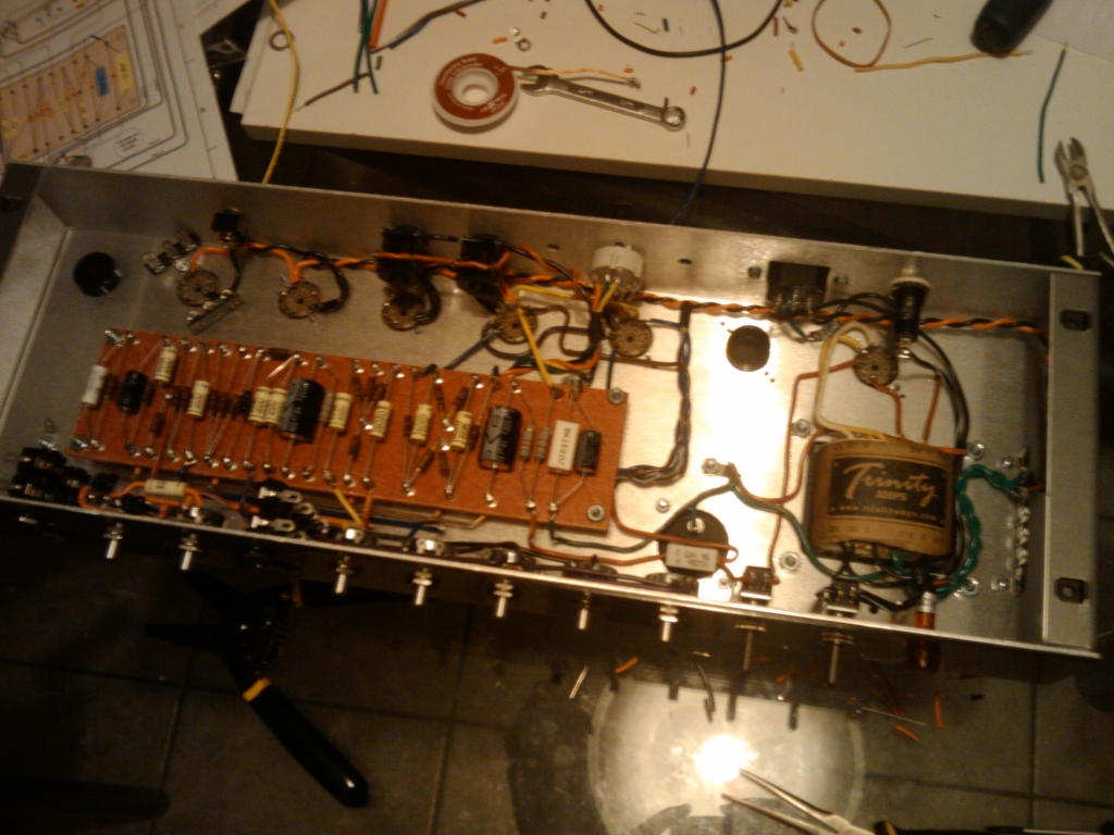

I've been reading a bit on these forums but haven't posted much as of yet! I've received my 18W Plexi kit last wednesday and thought I would post pics of my progress so far. Sorry for the mediocre cell phone picture quality and keep in mind this is my first build (...probably won't be my last!!). If you see anything missing or something I should have done differently let me know!
Now I have V1, V2 and the inputs left to wire up, can't wait to fire it up!!

PostPosted: Mon Sep 27, 2010 7:42 pm
Looks fairly tidy to me. :D

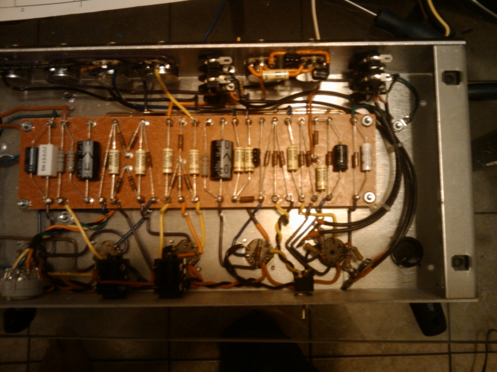

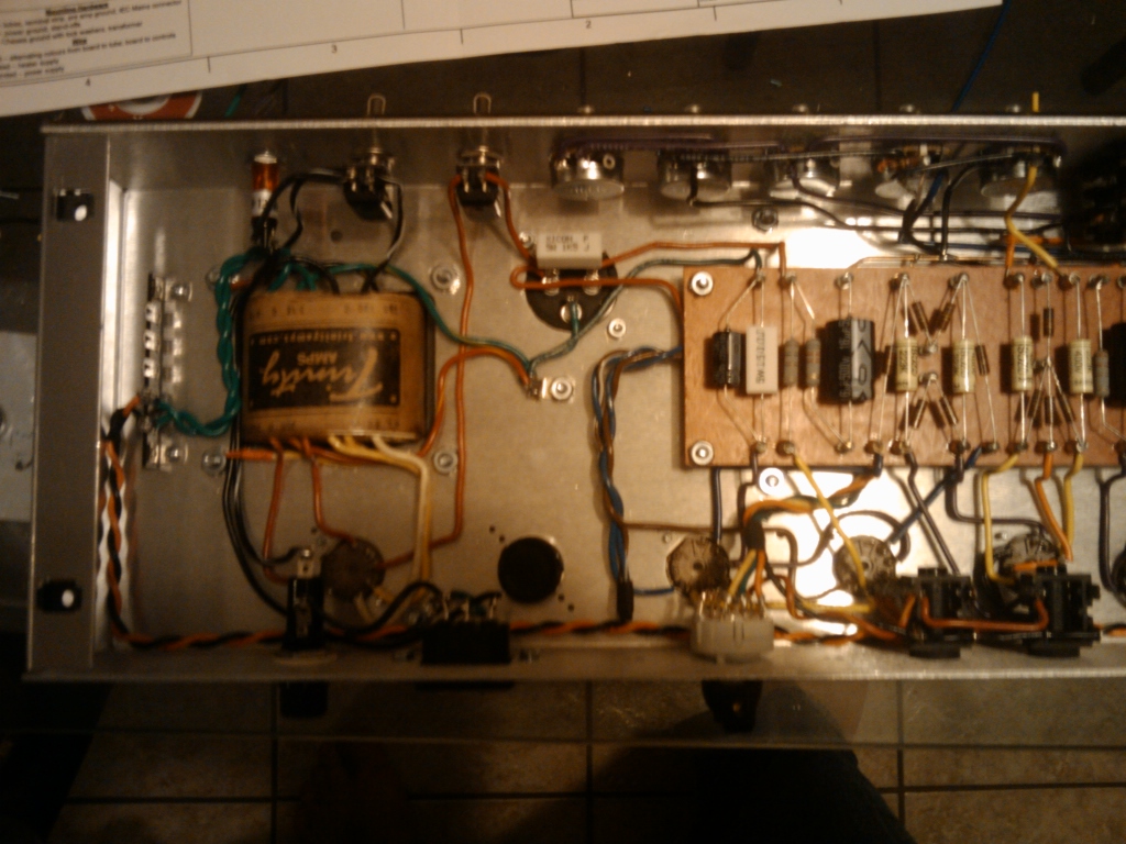

Well I've finished the wiring yesterday, all I need now is to pick up some tubes check voltages and start making some noise!

PostPosted: Wed Sep 29, 2010 11:16 am
Looks neat & tidy. Time to double check the connections!

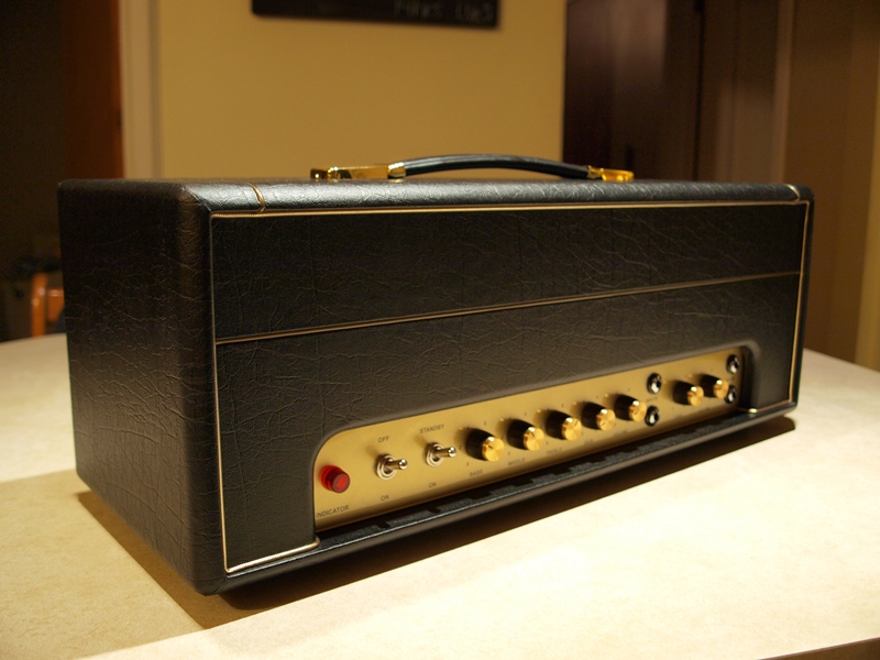

I took my amp to my local guitar shop to try out some speaker cabinets. turns out they didn't have much in stock so I could only play through a Marshall 1922 cab (small 2X12" with 2 Celestion G12T-75's). The amp sounds amazing... at home I couldn't crank it much more than 2... past 4 is where the fun starts. Still cleans up nicely with the guitar's volume control. I saw an ad for a 2x12 Avatar cabinet loaded with Eminence Legends... I just need to find out exactly which model of Legend and I might pick it up! it's the "traditional" style cab with black tolex and wheat grille so it would fit nicely with the old school Marshall look.
and here's my finished 18W Plexi head!
