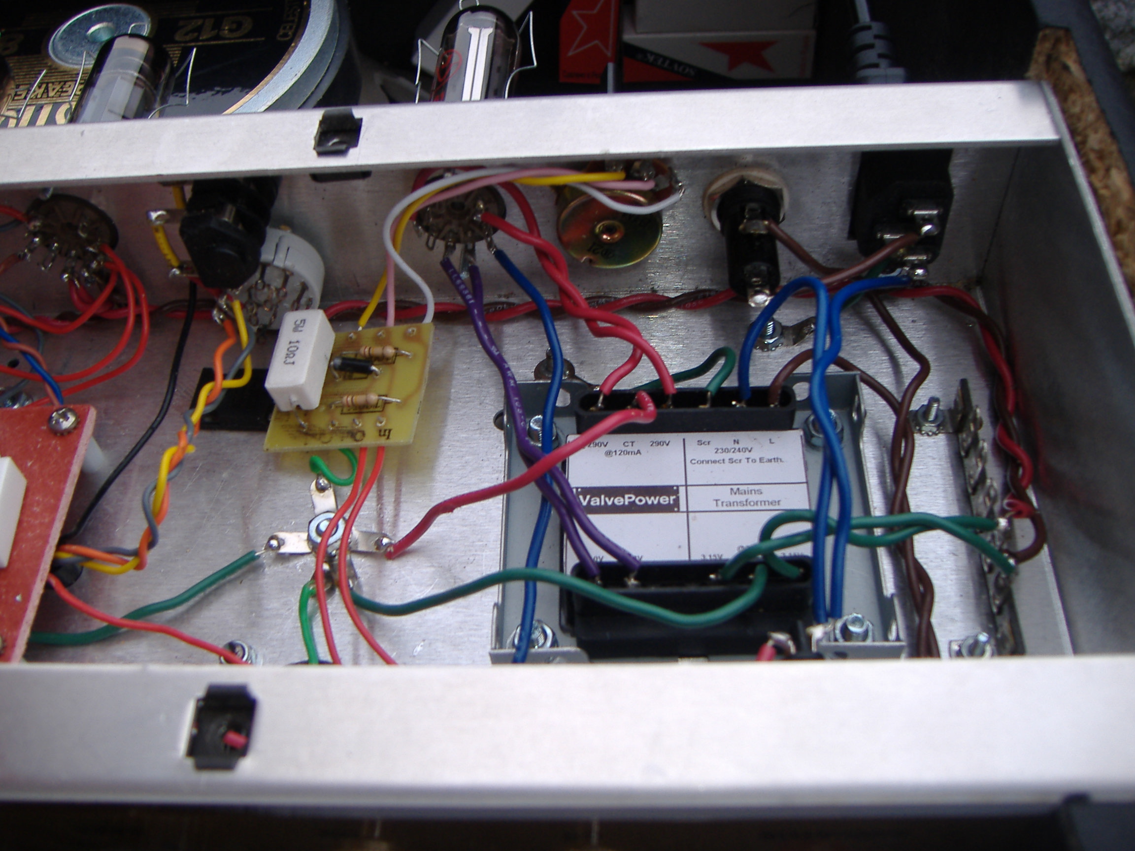

Hi,
My plexi has got alot of hum at the moment.
Quiet as a mouse on standby and it makes no difference pulling the tubes out.
It only happens when a guitar is plugged in.
I've been using it with a vvr but when i went to crank it up it had alot of hum and i don't
remember it being there before.
With volume on full when i turn the gain up there is a hum present and I don't know where the hum is coming from.
I get it in both channels worse with boost on.
I've redone every ground point, shortened all ac lines resoldered all jack sockets and gone over the shielded cable, but nothing has helped it.
I've replaced all the tubes apart from the rectifier tube.
I'm on 240vac mains just so you know.
Also i lose 20 vdc with the vvr i'm not sure it matters, is that why my voltages seem on the low side
b+ is 340 in and 318 out of the vvr.
Here are my voltages.They were measured with 1 probe on ct and the other one going
to all the pins.
v1 pin1 147
pin3 1
pin6 147
pin8 1
v2 pin1 168
pin3 1.5
pin6 247
pin8 168
v3 pin1 186
pin2 57 but it switches off when i touch it
pin3 75
pin6 184
pin7 55 but switches off when i touch it
pin8 86
v4 pin3 11
pin7 332
pin9 314
v5 pin3 11
pin7 332
pin9 314
v6 pin1 290ac
pin3 340dc
pin7 290ac
This is bugging the hell out of me.
If you do make suggestions could you make it as simple as possible as this is my first build,
Thanks.
PostPosted: Tue Apr 06, 2010 8:59 pm
That's a sign that the problem lies in your guitar, the input jack or even the guitar cable.

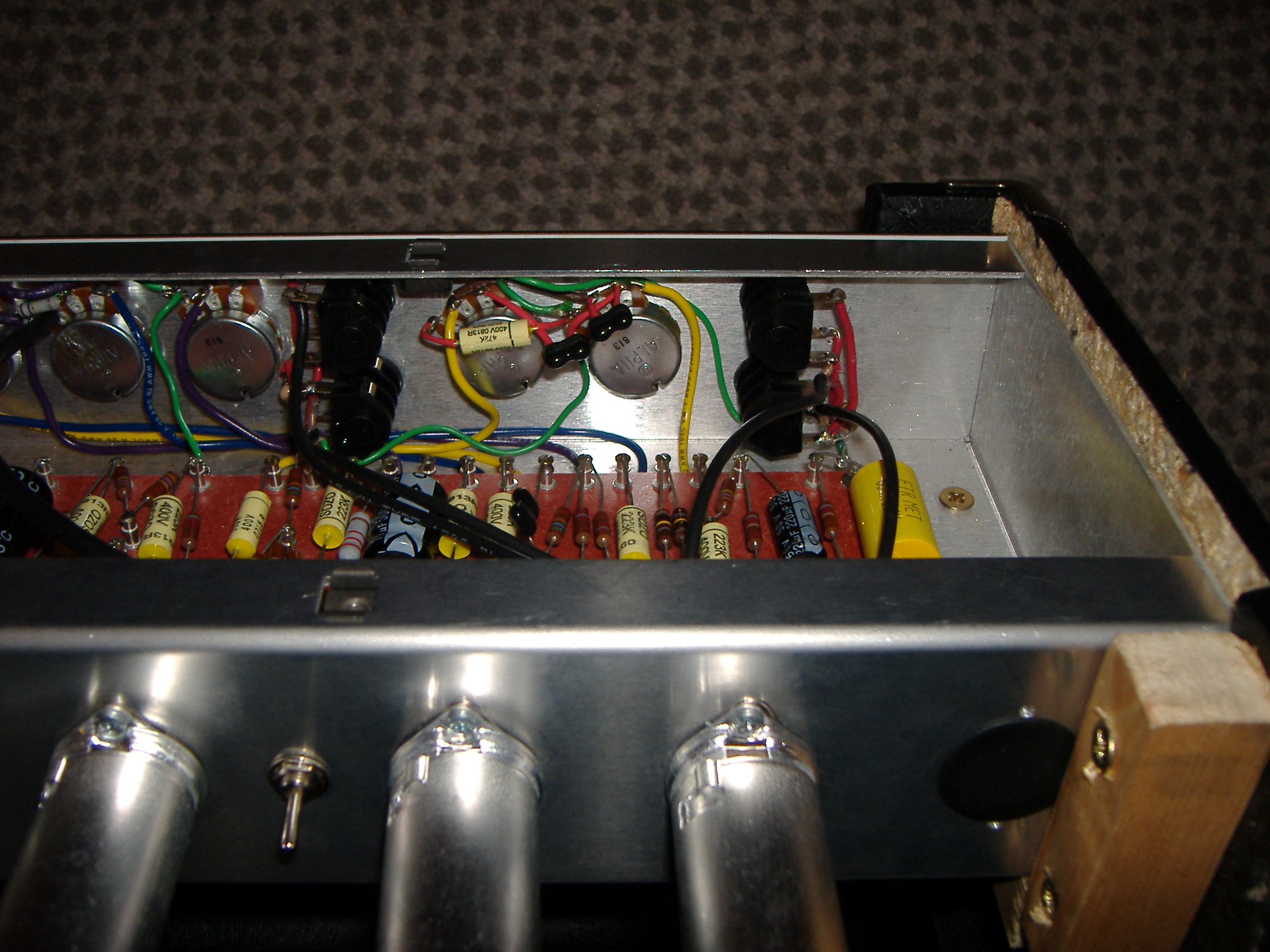

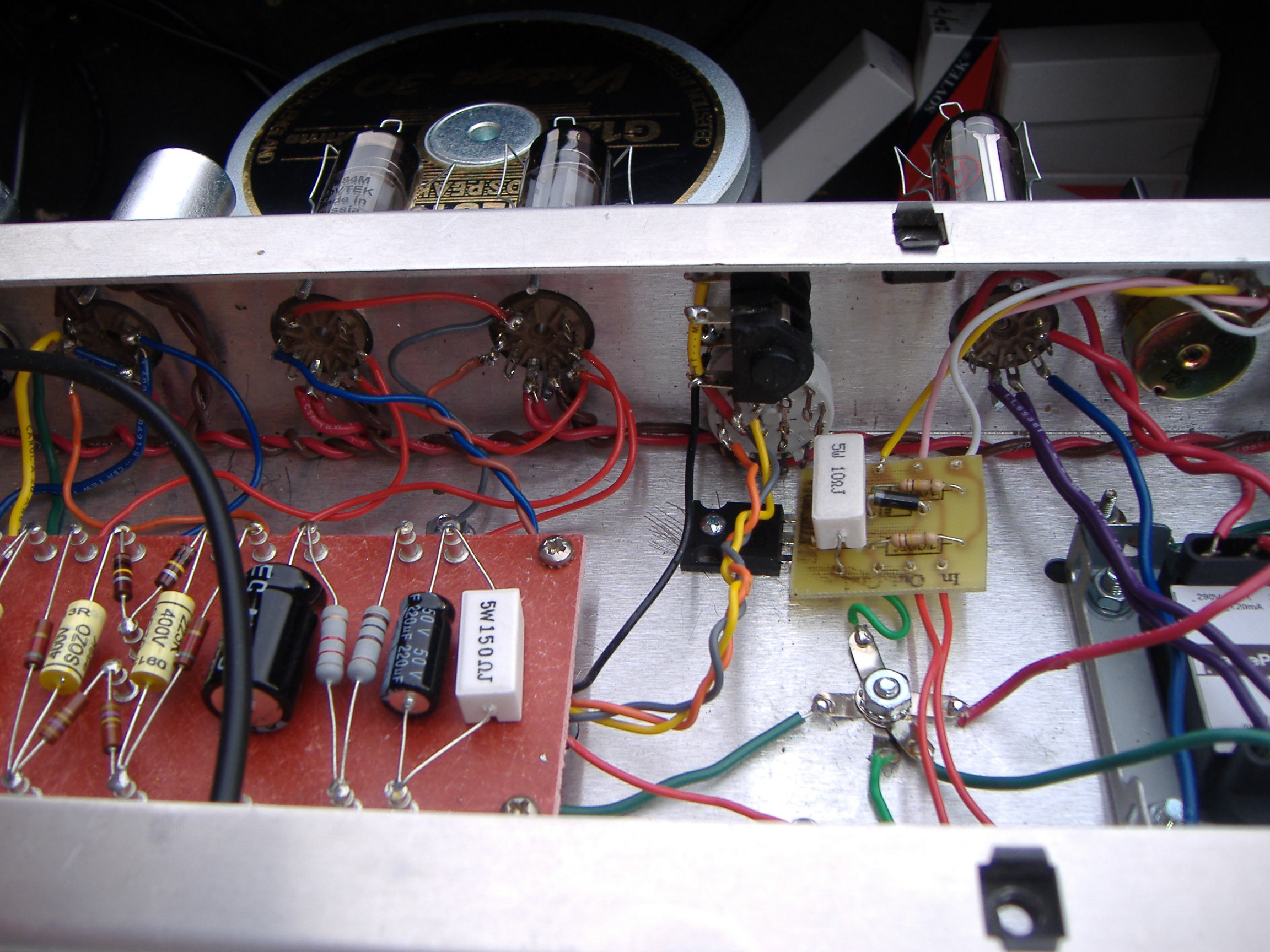

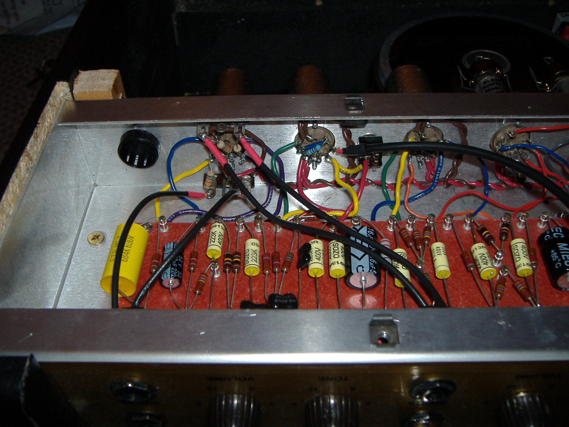

PostPosted: Wed Apr 07, 2010 12:51 pm
Joined: Tue Jun 02, 2009 4:51 pm
Posts: 56
Location: uk
It still hums when the cable is plugged in with or without a guitar.
One thing though, when you hold the strings on the guitar it is alot quieter and acceptable i think, but how much hum is normal as i don't know.
I still think there is some sort of ground problem somewhere or could something be faulty.
I've included some pictures.
I was trying to keep it tidy but welcome some more building advice for the
next one.
PostPosted: Wed Apr 07, 2010 12:58 pm
You can try this. Remove the grounds from the normal channel pots & all the input jacks and run them all separately to the preamp ground post.
PostPosted: Wed Apr 07, 2010 2:57 pm

PostPosted: Thu Apr 08, 2010 9:30 am
plexiblues wrote:
Why don't i need to run a separate ground for the tmb volume pot, as this is grounded on the bus bar and the hum is in both channels.
You can do that too. It wont hurt, butthe nput jacks can be very sensitive.
plexiblues wrote:
Also does the vvr affect the amp in some way.
Try disconnecting the VVR and bypass it. See if the problem goes away. It can cause noise on the power supply.
