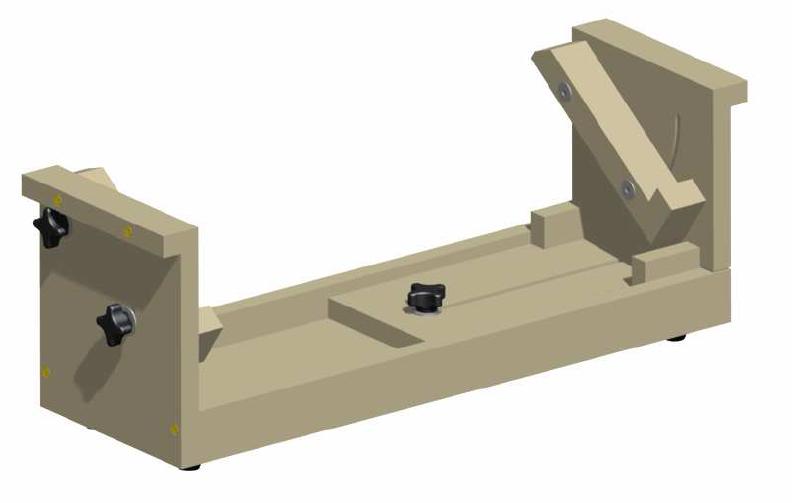

I recall seeing a setup someone built to aid with the soldering of the components onto the board. Does anyone have a jig they can share to hold the board?

There are lots of vises around for the purpose of holding PCB's for soldering (try Panavise for example). To be honest I prefer to have the board sitting flat on the bench where I can get my magnification lamp over it if need be. There is a great jig that someone made up from metal and also some wooden fixtures around for holding and rotating the entire chassis for assembly and debug. You'll have to search around. I prefer to jig and assemble the amp outside of the chassis like this... Different strokes!
viewtopic.php?t=1392
