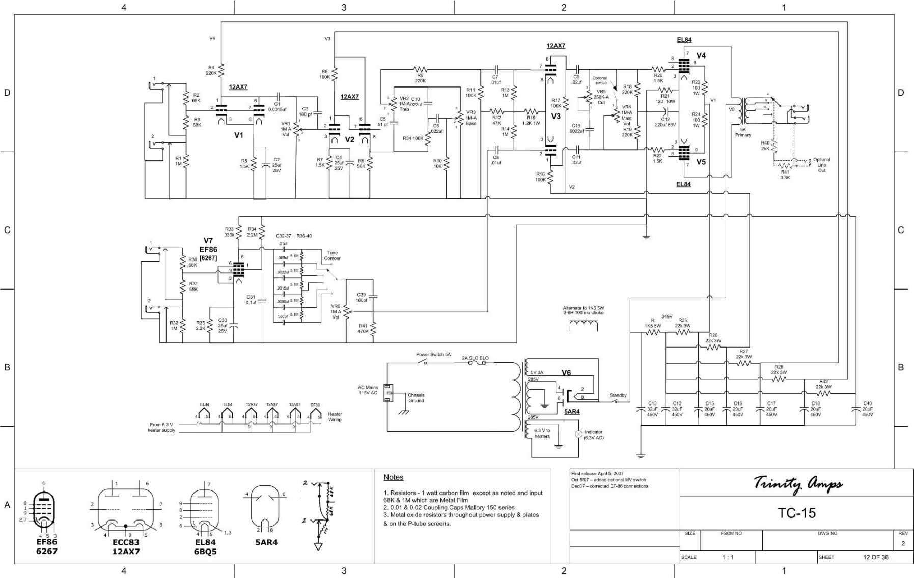

If it's a TC-15 you're after, read over this post!! Great amp too!! viewtopic.php?t=1236
PostPosted: Fri Mar 27, 2009 7:17 pm
Maltone wrote:
I don't think you can go wrong with anything Vox-Matchless-esque, and if there's any recommendations you guys can make along the way for a mod here or there, please let me know. I know it's next to impossible to get an exact tone most of the time, but a close approximation, and that amazing string separation, articulation is IT for me.
OK, if you wanted to voice a TC-15 more like a 65 Amps Soho, here's what you would do, referring to the schematic on www.trinityamps.com/phpbb/viewtopic.php?t=859 :
C1 = 0.01uF
C2 = 1uF
C3 (180pF) removed
R7 = 820 ohms
C4 (25uF) remove, or replace with 2uF if you want more gain
R15 = 820 ohms
R18, R19 = 270k (increase to 330k or 470k for more power tube distortion)
R20, R22 = 8.2k
R25 = 2.2k (don't use the choke option)
Set the OT for 8k operation. 65 Amps use a custom 9k OT, so 8k is the closest we can get.
This will give you a 65 Amps style Vox meets Marshall meets Matchless tone, and you can tweak these values further to dial them in to exactly how you want the amp to sound. At this point it still has the Vox style tone stack, and you could optionally put these more Marshall-like component values into the tone stack if you wanted:
VR2 (treble) = 220k
C5 (treble) = 470pf
R34 (slope) = 33k
C6 (mid) = 0.01uF
R10 (mid) =15k
VR3 (bass) = 500k
Connect pins 2 & 3 of VR3 together.
Disconnect junction of C6 & R10 from Pin 2 (wiper) of VR3
Remove connection between VR3 Pin 1 and Ground
Connect junction of C6 and R10 to VR3 Pin 1 (so pin 1 path to ground is via R10)

zaphod, you said:
in both clips I can hear some PI clipping fizz, which tells me that they're using the Vox/Matchless 1.2k value for resistor for R7, so no need to change that one to 820 ohms, if you like that tone. Personally, I prefer the PI not to clip quite so much, since I think you lose some definition when that happens vs having the distortion coming more from the EL84s, like in a regular Marshall 18W.
Yeap, I don't like fizz either. I want to stay as far away from that as possible. I really don't understand the details of what you're talking about... the resistor changes or values - maybe in time I will. But, I don't want to forsake clarity and definition for fizz. What is the PI?
I do want more natural tube overdrive from the tubes as well. Is there any point when I do get this TC-15 to replace anything with something like Wima capacitors. SEE LINK: http://www.vintage-radio.com/images/com ... -cap10.jpg
It says:
These Wima capacitors are a bit late to be originals or even service replacements (they date from the 1970s I think). However they do turn up sometimes in sets that have been repaired, and they should not be cause for concern. I have also seen them sold as replacements at swapmeets etc. They appear to have an outer foil with the value printed in either black or red, and then the whole thing is covered in a semitransparent epoxy which gives it the yellow-gold colour
So, basically Zaphod, I should just stick with ordering a TC-15 kit as is, then think about changing resistors during the build? So to avoid the fizz you're talking about, what would I do - just leave the build as is?
Not sure what this meant: "they're using the Vox/Matchless 1.2k value for resistor for R7, so no need to change that one to 820 ohms, if you like that tone." — Guys, thanks again, you're awesome!
—Disco Sucks—
PostPosted: Mon Mar 30, 2009 10:20 am
Yes, buy the TC-15 kit and substitute the few component values that need to be different during the build, for something very close to a 65 amp.
The PI is the phase invertor, which is the 12AX7 tube just before the two EL84 power tubes. To make some sense of what I'm saying, just refer to www.trinityamps.com/ForumGallery/trinit ... _18Dec.jpg I was actually talking about R15 (not R7 sorry :oops:), which as in many Vox and Matchless amps, is 1.2k and causes some fizz when the PI starts to break up, and hence some loss of definition. The same resistor in a Marshall 18W is 820 ohms. Just ask for those different resistor and capacitor values when you order your TC-15 kit, then get ready to enjoy some real tone! :D
Apart from that, amps with EL84 power tubes generally tend to have great definition. I also don't see any particular need forthose Wima caps. The caps that Trinity uses are also very high quality, but you're welcome to try the Wimas if you want. :)
