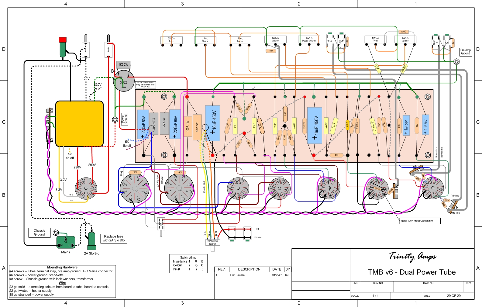

I sat down late last night and looked over the kit. I have a couple of questions before I get into the details (you'll have to excuse me if the answers to my questions are embedded in the details of the "Build Guide" since I haven't had a chance to read it fully...yet!").
1. I guess the TMB v6 has no layout. Guess I was hoping for an "idiot-proof" set of instructions for my first build :shock: I get the fact that I need to build a regular TMB board and then add the v6 parts. However, where do the v6 parts go? If I do a comparison of the sIII vs. the sIII v6 and note the placement of the "extra parts", is it safe to assume these parts go to the same locations in the TMB? Or, is there somewhere else where I can get an indication as to where to install the v6 parts on the TMB?
2. The specs on the v6 say that the "boost" and "6V6 tube" feature are footswitchable. However, the kit seems to have two mini-toggle switches for each of these options, so I suspect the "footswitch" capability is not what's intended for the kit in its current form? If not, how much trouble is it to wire the head to have footswitch capability for both of these options?
3. It appears that the TMB v6 is intended to have a "reverse boost" feature (taking the TMB into sIII territory. However, is it possible to boost the TMB v6 even more? I guess what I'm asking is "Is there a way to have addional boost of the TMB and not have the "boost" feature as a "reverse boost"?
Keith
PostPosted: Tue Apr 24, 2007 9:29 am
Regarding Venting: viewtopic.php?t=110
The v6 was orignally a sIII with the 6V6. I can draw up a TMB version for you.

Don't create the TMB drawing if you don't feel you need it. Let me try to figure it out, I'm sure it's not rocket science :wink:
Maybe tonight I will lay out all of the parts and look at where the v6 stuff should go logically.

TMB v6 Layout Note: No Boost Switch
PostPosted: Wed Apr 25, 2007 7:19 am
Joined: Thu Apr 12, 2007 8:48 pm
Posts: 90
Location: Just a stone's throw from Emohawk
Thanks Stephen
PostPosted: Wed Apr 25, 2007 9:10 am
Right clck the image to download it to print up to 11X 17.

Already done and printed in glorious colour :D

Hey folks. Keith has been real busy with life, so I offered to complete his build for him. He had the board mostly completed (except for a couple of leads that you can see mounted to the top of the board in the pic - output tube power ground & board power). Here's the completed result...
You may note that this is one of the early V6 layouts. I stuck with that version simply because I would have needed to get some extra parts for the newer layout.
You may also note that I didn't use the single-conductor shielded wire Stephen provides for the inputs. I don't like using that wire for dual input jacks - it's very difficult & untidy (in my opinion) for wiring the grounds. I also don't like the relatively low melting point of the inner sleeve. I have a bunch of 2-conductor shielded cable that I got from Metroamp.com that's much easier to work with.
And I did one other break from convention with where I mounted the tag strip for the sIII channel inputs. It was just too tight to mount it on the socket bolt (and a nightmare to solder in there with my big clumsy fingers) to I drilled an extra hole in the side of the chassis & mounted it there instead.
Just have to tidy the lead dress a touch & we're done I think. Tested it today with some el84's I have lying around & it seems to be working fine.

Looks fine. Another Trinity amp on the Rock!!
This looks like a TMB v6.
The resistor leads on the power tube cathodes look pretty close to the mounting bolts. Check 'em.
I've seen a cool idea to deal with the tag strip mounting that I might try soon.
As for the coax, that's Belden 1266A but the shield is a foil with a ground lead. How do you find soldering the shield to ground?
Ww've steered away from it becasue of the shiled but it is lower cost than the single stuff we use.
The pic makes them look closer than they are, but I had the same thought. I've got them raised off the board now, but I should probably shorten them. Give me something to do while waiting for Keith's tubes to arrive. :)
I had to do something...there was no way I was going to be able to work in that tight corner without out a few more burn scars. I even left the TMB inputs to last so I wouldn't be encumbered wiring up V1.
As for the coax, that's Belden 1266A but the shield is a foil with a ground lead. How do you find soldering the shield to ground? Ww've steered away from it becasue of the shiled but it is lower cost than the single stuff we use.
It's more personal preference than anything. No problem soldering the shield to ground - it's actually easier to work with as it's less bulky. If one really wanted to be sure you could add a touch of solder at the contact point between the ground wire & shield but it's probably not necessary. This is the 3rd build I've done with it and I've had no noise issues.
There's nothing wrong with the single-conductor stuff, but I always fear that I'll create a ground short by overheating & melting the inner sleeve, especially working in tight spots.
