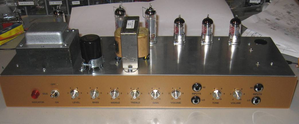

We're building a custom 18 watt plexi that cascades the Normal channel into the TMB channel.
Cascade will be foot switchable along with the TMB chanel boost. When off, it behaves like our standard 18 watt plexi. When on , it's cascades for more gain and some more overdrive.
Amp also has a VRM (Level) control on a front and a custom panel to boot.

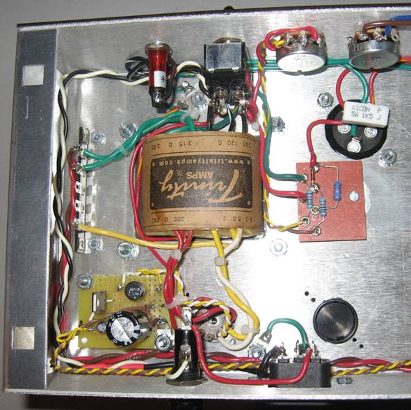

You'll note that we're using a TRIWATT power switch to save space for the VRM control.
Zaphod finally had a chance to play it today. I'll let him comment on it. He talked about being spoiled or something!
When I get the relays installed, I'll shoot a picture of the guts.

Very cool. Did you have to do any reconfigurations of the voicings of the two channels for when they are cascaded?
Is that a custom faceplate there? I ask because of the "level" label.
So when cascaded you can use the Normal Channel's Volume, as well as the TMB's Vol and Gain to control the overall gain. The Level control acts as a master?
PostPosted: Tue Oct 06, 2009 9:05 am
Dropped the TMB bosst cap to 1uf.
It is a custom facpelate . The Level is the amp level that controls the VRM (B+ control) so it is a kind of master.

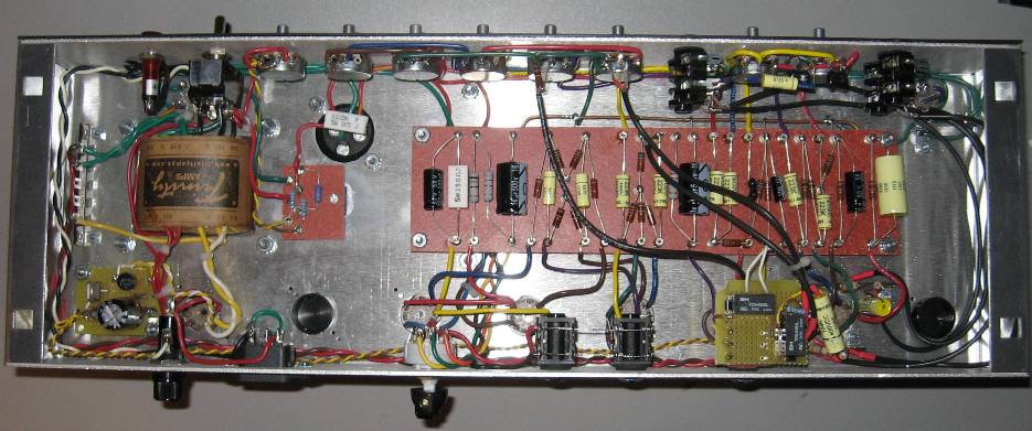

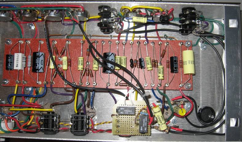

In the final version, relay control for Boost & Cascade mode were added. This is controlled by a dual footswitch.
Also, I cascaded the TMB into the Normal channel instead. Note the extra coax connections to / from the TMB PI .022 cap.

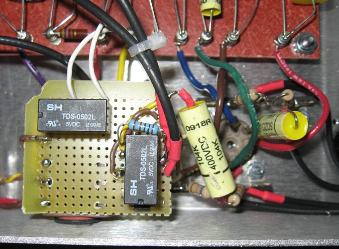

It was a challenge to quiet this down with all the extra wiring around V1 plus the VRM DC blocking caps. I made the relay board as compact as possible. About 1.5" X 1.5"
Note: The relay board controls the Cascade AND the TMB channel Boost so it needs two relays.

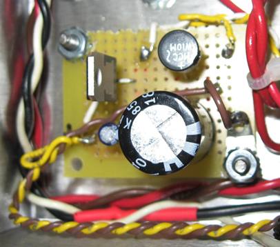

Relays were powered by a 5VDC reg supply, with AC tap off the 6.3 heaters from the rectifier tube.

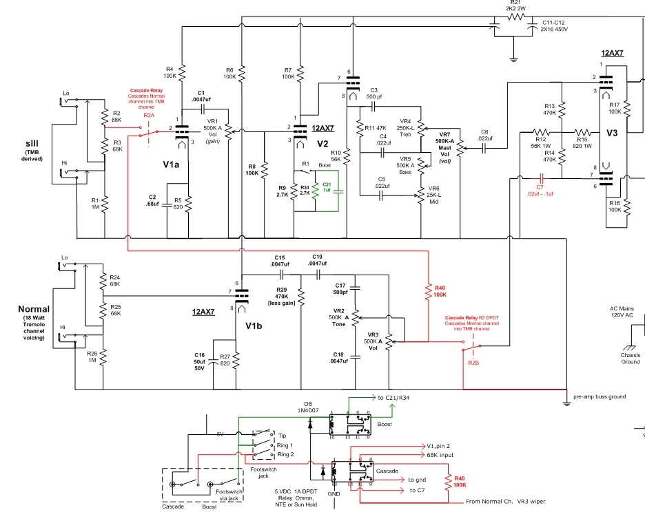

Schematic of Normal Channel Cascaded sIII 18 Watt
Just change the connections to do the same with the TMB channel if you prefer.
Note that when you cascade one channel into the other, the other channel PI input is grounded so the inputs to that channel cease to function. So pick your favourite channel.
