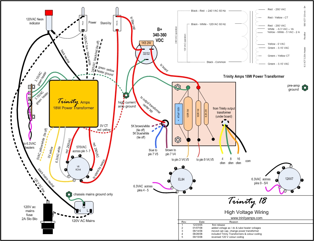

First off, Im glad that you're back home, Buddy. Second , nice job on the wiring. I've looked at the wiring around the tranny and I can't see anything obviously askew.
However , from the pics, I noticed that the black primary that is going to common (I think) looks as if the insulation has bubbled a bit.
Here's what I'd try. (But, only if you feel like it. Your healing is more important right now, and the amp can wait. ) Remove the tubes. Unplug the power. Then set your meter to resistance (continuity) . With one lead on ground , check for continuity on pins 4 & 5 on the rectifier tube socket. You should get no reading.
Next check for continuity on pins 1 & 7. Since they are center tapped to ground they should give the same reading in ohms. Also check the two green heater wires in reference to ground. They are also center tapped and should give equal readings. We are looking for an obvious short in the windings of the tranny. Also since the two green wires feed heater current to so many tubes, you need to triple check the heater wiring on each of your pre and power tube sockets. A short there can cause problems in your tranny. Really look closely for stray strands of wire or splashes of solder. Your eyes are probably like mine and don't work as well as they once did. I put on two pairs of readers when I need to see closely.

jac,
You should have this document if Stephen sent you a kit.
http://www.trinityamps.com/ForumGallery ... g_v3.3.jpg
In the top righthand corner you'll see a scemo of the tranny.
The green/yellow is grounded. If you attach one lead of your meter to ground and set the meter on ohms / resistance, you should be able to put the other probe on each of the green wires and get approx .5 ohms on either one. That shows continuity thru that coil on the secondary. If you get zero , you have a short to ground . If you get nothing, you have an open circuit.
I'm reading 85ohms and 88ohms on the red wires with the ez81 in the socket and UNPLUGGED.
The yellow and the white both show no connection to ground.
If you get anything other than that , let us know. All of these measurements are with the amp unplugged and off.

hey Leemo,
Measured up and got this:
Green wires: 0.5 and 0.6
Red wires: 70.9 and 72.2 (EZ81 installed)

what do you mean brown paper? I have brown paper sort of popping up at the sides.
The smoke is coming from the 110v black lines. Remember I was using the wrong version of the high voltage diagram. The one that showed the lines in reverse. My mistake but sucks.
Anyway the smoke came out of those 2 lines dead center.. Really never even got passed 90v on the power-up, smoked that bad.
Jac
Opps, just saw the heat.
The transformer's hot as hell. Don't touch the paper

Jac,
Reversing the wires wont hurt it - that's just line & neutral. there has to bea sgort in there somewhere. Disconnect the amp from the tranny and retry.
Well the paper surrounding the coils is brown. What I meant was DARK brown , as in a hot spot which would indicate a short in the coils.
Right now I'm speculating that there's a short in the primary , from what you've told us.
With the amp unplugged, I'm reading 3.5 ohms from the black lead to the black/white in the primary.
