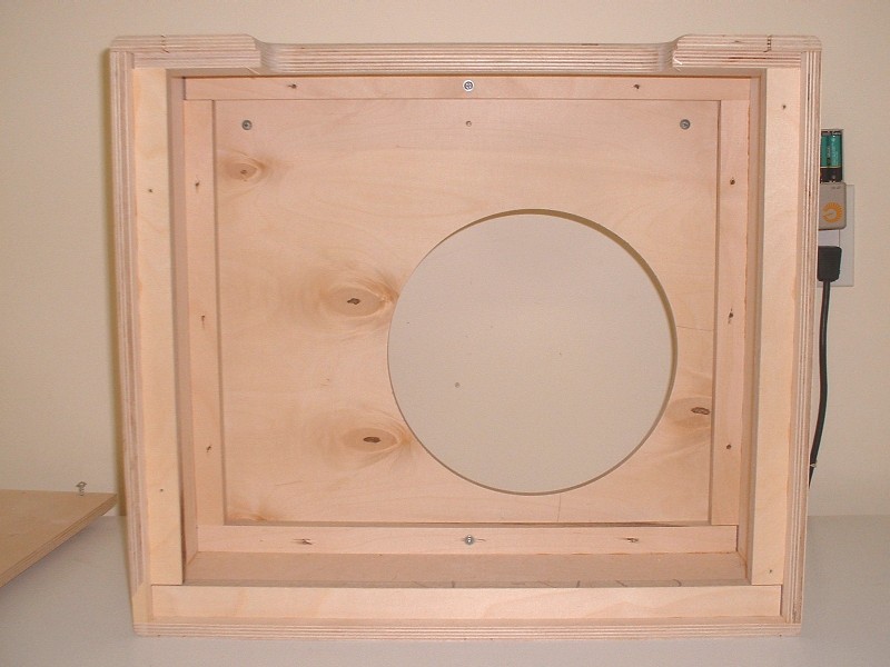

hey stephen, i asked a few months back about the baffles on on your combo cabs and how they and the front panel piece are attached. with all these good cab pics, could you please post an internal shot from the back with the amp and back panels removed? there's a good front shot (raw combo cab) in your gallery but i haven't seen a good shot from the back with the amp and panels removed to show how things are attached. thanks a bunch. rh
PostPosted: Tue Jul 11, 2006 10:52 pm
Inside a cabinet.
The baffle is screwed on from the back inside the cainet as is the front valence.
PostPosted: Wed Jul 12, 2006 8:23 pm
Joined: Sun Aug 14, 2005 2:17 pm
Location: memphis
hello stephan, thanks for the pic. i think i see now. this opens up a couple of other methodology questions for me. so you cut the baffle, add the little strips around perimeter of the baffle (on the front). do you staple the top edge of the grillcloth first and then pull tight around the other 3 sides? also the piping strip---do you staple it to the valance or to the top edge where you just stapled the grill cloth? i'm assuming the baffle edge strips and the valance are both 3/8" plywood--correct? thanks very much for the help. rh
PostPosted: Wed Jul 12, 2006 9:19 pm
you cut the baffle, add the little strips around perimeter of the baffle (on the front). ?
Yes
Staple one Side first, stretch to to ther side - staple , Staple Top then stretch to bottom and staple. Staple only on edge, not back. trimmed cloth off so it doesn't wrap around the back.
Staple to Valence then screw the valence on afterwards.
i'm assuming the baffle edge strips and the valance are both 3/8" plywood--correct? [/quote]
Baffle is 1/2" material. Stripa are 1/2" Valence 1/2" . Baffle assembly is 1" thick total.
Also, the cleats are attached to the cab and the baffle screwed in from the back.
